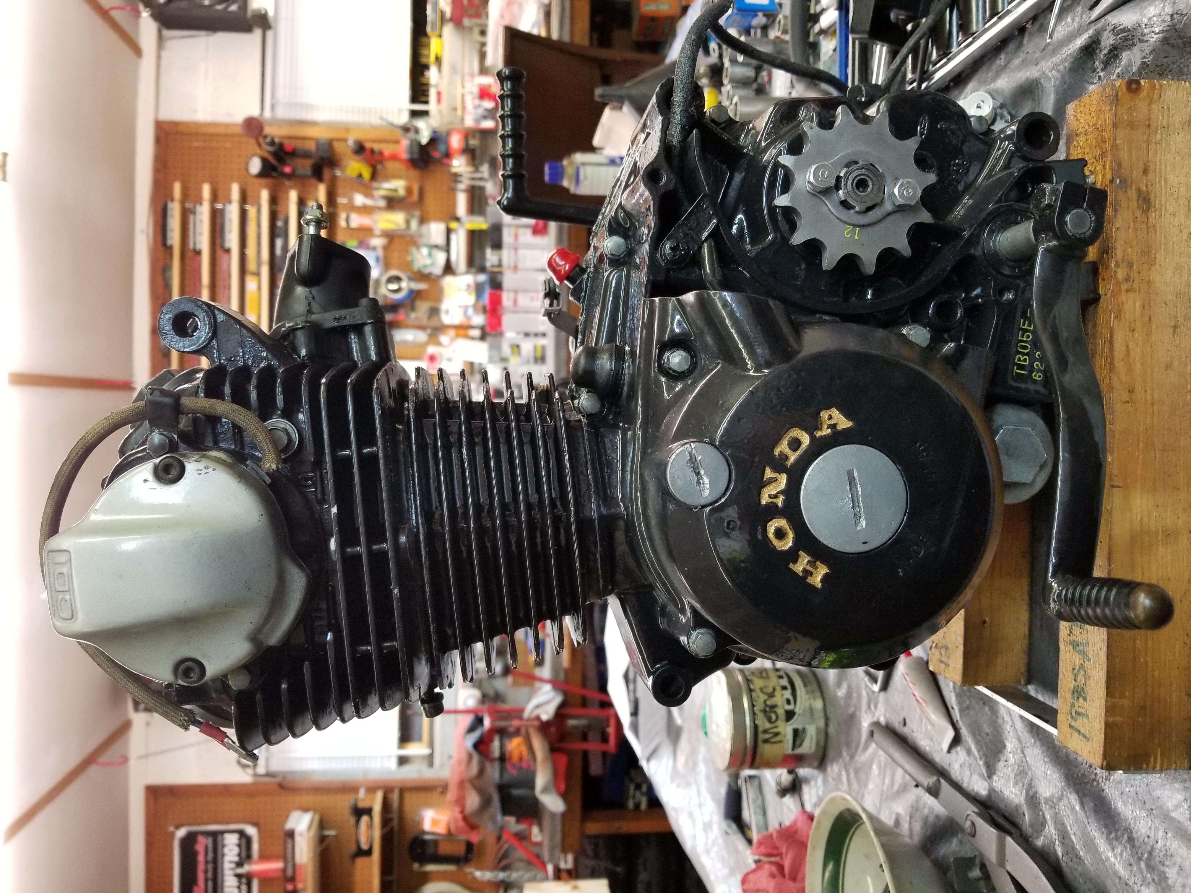

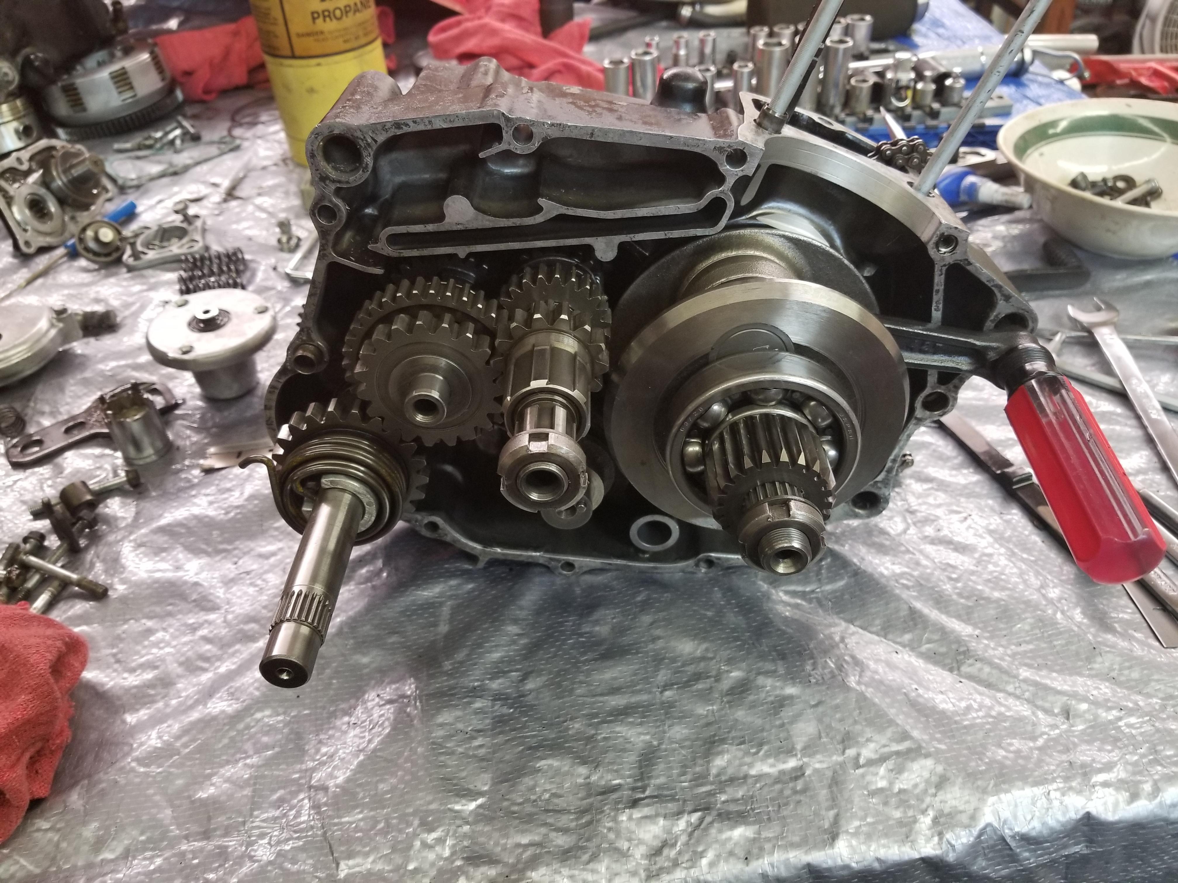

    Ok guys new to the forum but need some guidance. I just recently put together my old 1985 atc 200x. I went completely through the top and bottom end. New seals, new kickstart ratchets, new gaskets. I replaced the ignition and lighting coils with ricky stator ones new. New ebc clutch with 10% extra power springs. The jug. The cylinder is bored to 66mm, wiesco 12.1 to 1 high comp piston. Then installed new valves, lapped for the head, and installed a web camshaft 214 profile cam with performance valve springs. All new gaskets on the top end. Reassembled and set the valves according to spec. Set the pulse generator to .012 according to the book. So after getting everything back togather tested it. The compression is 120-130 psi. However I cannot get it to start or hit over. I tried to see if i had spark but I cannot verify it so far. The carb has a 132 main jet in it, and fuel is getting to the carb, runs out the drain when you turn the drain screw. The carb is also completely clean inside, went through it before reinstalling it. I also tried to spray a little ether in it to see if it was a fuel issue, but still no hit over. I have kicked this thing until my foot is sore. So what do you guys think. Where should I look next? I checked my wiring and everything appears good, no loose , or damage. Im stumped, and any help would greatly be appreciated.

    I was thinking that, just needed reassurance. I am gonna try and check it tomorrow, and see what happens. Way before this build many many years ago, this thing was always hard to start kicking it. I had a 1986 xl 600r that wasn't as bad as this 200, however it did have a compressiom release. So if its the spark, what would be the next step? I do have a spare oem cdi box, spare complete wiring harness, and coil. Before I resurrected it the last time I ran it was 2007. I am anxious to get her moving again.Click image for larger version.

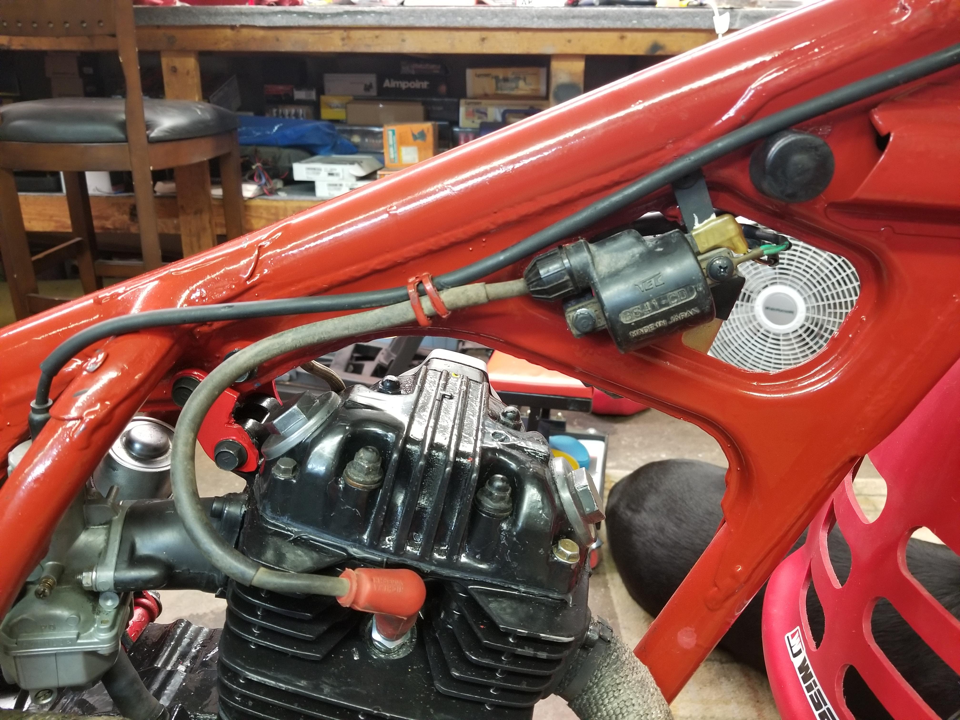

    So I messed with a bit tonight. I checked and I am not getting any spark, that I can tell. I then added a new ngk DR8ES-L plug, no change. I swapped out the wiring harness with the backup, swapped the coil to the backup, and cdi box to the back up. All connections are good. Still no spark. SO I then cleaned the handlebar switch and checked for any visible problems, none found. So I am thinking that its either the handlebar switch, the pulse generator, or the ignition or lighting coil I installed from ricky stator. I did solder in the new coils and protected the connections with heat shrink. I have no clue what to try next really, what do you guys think? Here are the pictures.

    A quick thing to do is make sure that coil is grounded good. I don't rely on the screws doing it. I sand the frame a bit and also the coil where it mounts to the frame. While you have it off. Clean up that connection on the right in the first picture.

    You can just disconnect the handle bar switch to rule that out . I would ohm text the stator as well . Make sure the coil is making metal to metal contact to the frame , same with the motor at least at one motor mount .

    Will check the ground for the coil tomorrow. I did remove the paint from the frame before mounting the coil. The front mount was broken off so I made a new one with a piece of metal and attached it by using a self tapping screw. I am gonna remove it and clean it up tomorrow too. The rear one appears to have been broken in the past and crudely welded back on. I am also gonna check the motor to frame grounding which I am sure could be improved after the primer and repaint. Is their a better way to ground the motor by using other means like was used on later honda's? I also checked the ohm reading to the book values and did not get what the book lists, however I am not that great with a multimeter. However I do remeber checking the stator coil and lighting coil with the meter set to ohms and red on the wire, black on the bare frame and got no reading, or zero, so that could be the problem the motor is not grounded to the frame, and plug coil as well. Thoughts? Thanks for the help, I deeply appreciate it.

    Ok so here it was I did today. I removed the ignition coil and tested it off the bike. Primary coil is 0.4 ohms, secondary coil is 4.21k ohms according to the meter. Factory manual says its in specification.
    I removed the top and front motor mount, and removed the paint down to the metal, same to the motor, and reattached them. Also did the connections under the ignition coil under the 2 mounting bolts, and where the trigger small wire slides on. Then reinstalled.
    I then unplugged the wires to the lighting coil and exciter coil, the red and black, and yellow. I hooked the meter to the lighting coil and got a reading of 0.0 ohms. Then the exciter coil, reading of 0.0. I had the red lead from the multimeter on the wire, and black on the bare metal where the gas tank rear bolts go in. I then reattached the exciter and lighting coil wires back into the harness. I rotated the engines flywheel to the fire mark. I inserted the red wire from the multimeter into the yellow wire at the connection and grounded the black and got a reading of 0.778K ohms. I did the same for the lighting coil and got a reading of .010 ohms.
