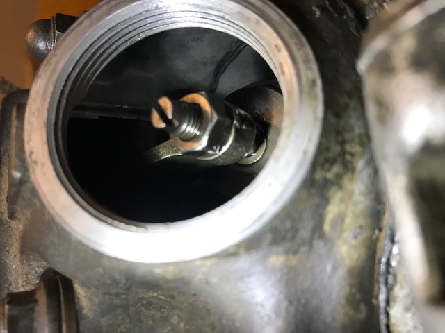

    Im 99% sure i got the cam timing correct. Valve timing im a little confused on am i adjusting it at "T" when the piston is at the Top nearest the spark plug hole or the bottom.
    When aligning "T" and the 0 on the cam sprocket with the Top Notch, the piston is at the top nearest spark plug as seen in the picture and the both intake and exhaust arms/valve adjusters jiggle a little since i probably loosened them too much if anything (P.S. the exhaust valve adjuster is tighter to adjust compared to the intake). Still got 30 psi compression on ressembly.
    Sorry if thats confusing maybe im not adjusting the valves on the right stroke. I feel like i adjusted them on both and still nothing. Also just cracked my pulsegen base ugh frustrating

    In that picture, I think your cam timing is one tooth off.
    Thank you for the pics, in this fashion you will find your way to the end. Only way to fail is to give up. It may cost a little more but you are paying for experience and knowledge.

    So, retard the cam sprocket one tooth and show the results. Be mindful that I told you the exhaust valve looks trashed. Also, if you put it back together with that gasket residue still on the head, then you aren't listening, you just want it done. Building engines is not about wanting it done it's about doing something yourself and doing it right until it is done. You don't seem like the type thats late for a race so what's the hurry? Your tools look hard and sharp. If you are cussing, scratching and scraping, this is not the hobby for you. Nothing in this field works if you are impatient.
