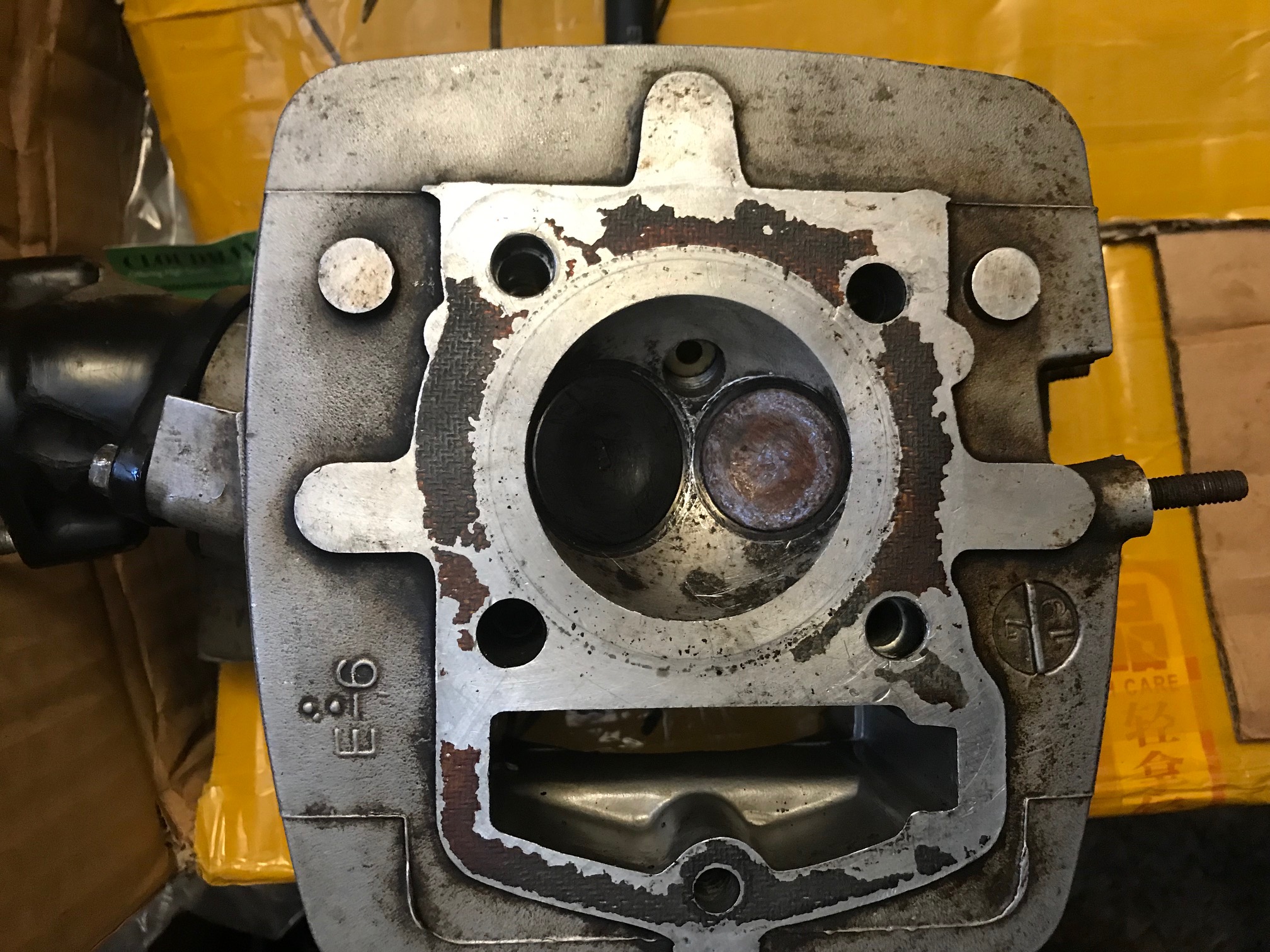

    i will retard the timing and see could one notch affect it so drastically??
    The valves look bad yeah and the gaskets are not perfect but would that keep the compression soo low?
    Does pouring a bit of gas in the valve area to check for leaks work i saw someone mention that above
    To be honest im trying my best to understand how all this works so a future project might come easier, and i am being as gentle as i can but a slight overtighten and it snaps. Ive taken it apart like 5 times now so at least that is a bit easier but i feel like there's some major component im messing up i feel like even if my gaskets were crap i would get a better reading than 30.

    Quote Originally Posted by dwheeler23 View Post
    Yes.
    Yes, but you already know you have leaks. If you set it all up right and it still doesnt build compression, this gas trick is a novelty. Your top is leaking. There, now you know.
    Welcome to it! Tight is tight and old metal thats been hott a lot of times is brittle. That's what working on old bikes is man.
    Nope. If theres no seal theres no pressure build, simple as that.

    Take a look at the pics bro. Dont get wrapped up on this stupid test, there's a lot more wrong here than a backyard leak test will reveal. At least 6 things that have been done wrong already. The head is leaking, and there's things that are obvious that he hasnt addressed yet.
    Stop looking for a simple answer. The fact is that this project is far from done because of the urge to hurry.
    LOL ok Ill leave you 2 to it!
    I cant tell if his piston is the right size...but I can tell his valves are toast if gas drains through them like a pasta strainer! LOLOL
    Fyi,,,take head off...turn upside down...fill the round cavity up and see how fast it drains off past valves...any thin liquid will do. Gas is handy ususally.
    If it drains off at all...you need a valve job.
    And yes...chunks of gasket holding your parts apart is a bad thing.

    Alright guys no need to bicker i appreciate everyone's advice lets just get this running. Cant even go riding someone stole my 250 raptor off my property while on vacation so this is my only hope right now and im determined.
    So. After scraping EVERY piece of gasket i could get i think the gaskets are good and cleaned.
    I made sure piston rings are 120 degrees apart, checked dowels + O rings, and TDC cam timing and valve adjustment perfectly imo.
    Tested the upside down valve leak trick with rubbing alcohol and after trying it twice im pretty sure theres no leak. Going to triple check with a towel underneath or something.
    After assembling up to the pulse generator cover im still getting 30 psi! Maybe 40 but definitely still to low to operate. Got to be something else major
    A weak valve spring seems possible when i crank the recoil i hear a woosh of air go out the exhaust area.
    P.S. I also have untouched new valve spring seals that came with the top end gaskets kit could that be a cause? As i mentioned the valve springs is the one area i have not really touched yet i would need a compressor or whatever tool necessary and a bit of a walkthrough to service them or just send them in. Would putting another set of used valves + springs work off a running trike or whats my options.
    Another thing that came with the top end kit was a metal ring somewhat larger than the thrust washer behind the cam sprocket no idea where it would go/replace.
    I feel like im close but dont want to get excited yet. IT HAS TO BE VALVE RELATED RIGHT??
    Will upload BEFORE & AFTER photos soon
    The Serdi valve servicing needs like 5-6 weeks DAMN
