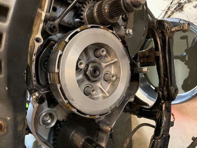

    Hi all!,
    I am trying to remove the manual clutch on my 85 Big Red 250es. I successfully removed the centrifugal clutch using a 20v cordless impact driver. However I am unable to get the nut off of the manual clutch. According to the service manual, the centrifugal clutch had left hand threads. I am assuming the manual clutch is standard right hand threads as the manual makes no mention of this; is this correct? If so my cordless 20v impact drill many not have enough power. I am thinking I may need to use a air impact? the manual mentions a clutch center holder tool, but my searching as not turned up one on amazon or ebay.
    Thanks in advance for your thoughts!!!!
    -Jon

    Correct. Regular threads, you need a good air impact.

    This may not be the "best" solution, but it's what I use. I bought a universal clutch holding tool so many years ago that I can't remember what brand it is. It may be Motion Pro, but I won't sweat to that. It kind of looks like a pair of Vise Grips on the handle end, but instead of a gripping end, it has two large "teeth" that will hold on to the teeth of the gear behind the clutch pack. If it's like the few that I've worked on, the nut id "pinged" a little bit in one spot to hold it in place. This is why you usually need a clutch holder and you need to "ping" it again after you reinstall it.

    New air impact arrived Amazon Prime over night (no extra shipping), and on a Sunday even! It took me a few minutes to figure out how to use it, and about 3 seconds (after jamming a piece of leather belt between gears), to get it off! THANKS AGAIN!!
