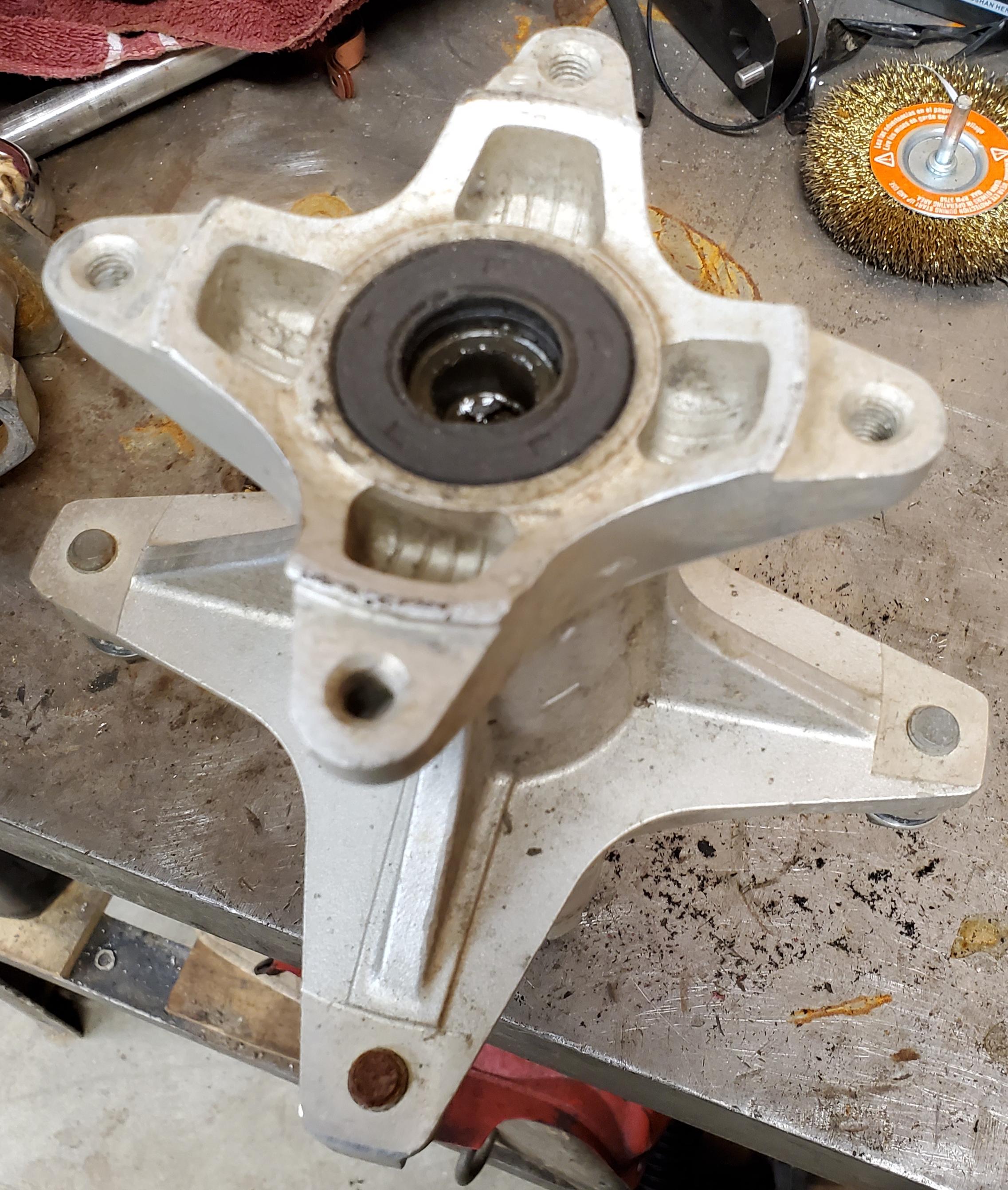

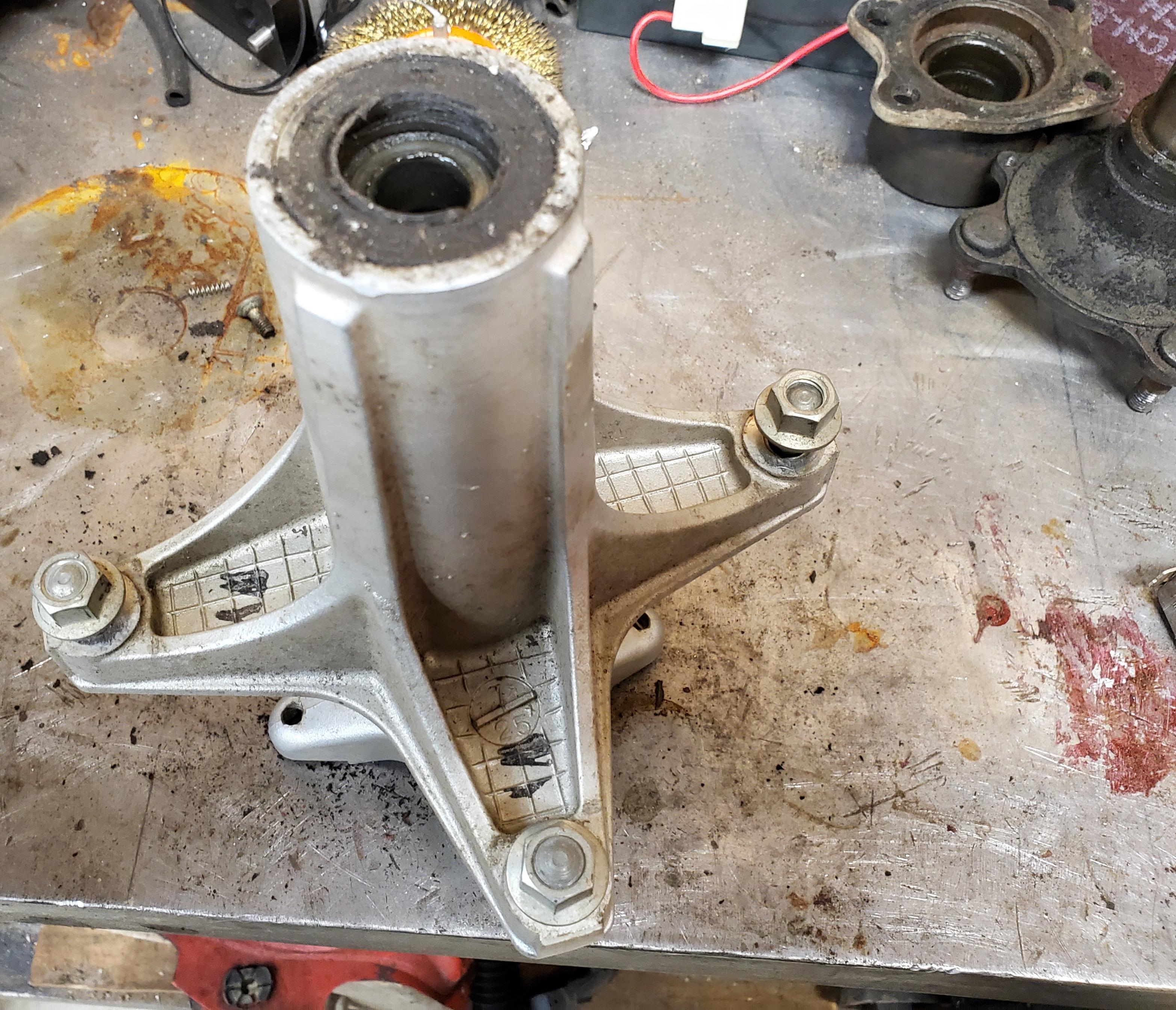

    I bought an 85 250SX and it had the attached pic front hub installed on it when I purchased it, it's definitely not stock. I am looking to find a brake rotor for this hub as it was missing when I bought it. I only have a standard tape measure available but it appears to have a 4x170 bolt pattern and the rear sx hub sits on the rotor bolt pattern perfectly making me believe the rotor is a 4x110. There are no other markings on it except for the one that can be seen in the picture 7/25. The wheel that was on it was a 11" and has DID JAPAN 9 85 stamped on it. Anyone have any ideas?

    I looked though the 85 machines and nothing matches that layout for Honda's, they all use a tiny bolt pattern for the rotor and it's a 3 bolt pattern.
    https://www.partzilla.com/catalog/honda/atv/1985
    I don't know aftermarket parts too well, but maybe there was a big brake setup for one of the sport machines and it found it's way on your 250sx? I tried to search for a 4x170 and 4x160 front hub, but nothing comes up on ebay.
    It's probably easier for you to buy a 250sx front hub, assuming your front forks are the stock setup, or switch to a 200x/350x front end to get the disk brake. Got any photos of the front end of the sx?

    I looked at a ton of front hubs on ebay, but didn't see anything that was an exact match. Yamaha tri-z also used a 4 bolt pattern rotor, but looks like the bolt pattern is smaller. I probably didn't see a tecate one so maybe. I also limited my search to 85's which covers most sport models pretty well but never know if 86 or 87 had something unique.

    I think in 85 the Tecate used a front drum. So far it's looking like an 86 or 87 Tecate but I cant be sure. I guess I'll just take some measurements and draw up a rotor and have it cut from stainless steel and see how well it works.

    Yep, I think you're onto something, 86 tecate photos seem to look very similar to that.
    https://www.partzilla.com/catalog/ka...0-b1/front-hub
    Diagram looks a lot like it. Part number interchanges for 86-87 tecate.
    Here's some ebay photos, seems like a match to me.
    https://www.ebay.com/itm/1986-1987-K...-/302981388325

    s10mods, you were almost correct above. In 1984, Tecates had a front drum brake, but in 1985, they had a front disc.
    Carthage NY 250r rules
    2,355
    Thats an 86-87 Tecate front hub.Click image for larger version.
