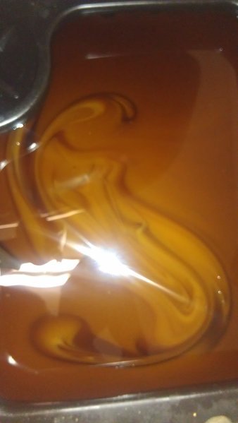

    The oil came out GRAYish? Was it kind of milky colored like gray mixed oil? Sounds like you might have had water in the oil.
    We don't know what kind of oil was in the machine, it's possible it's the wrong stuff, could change the oil and run it for a short time with the right grade oil, then drain and fill again to help flush out the old + the possible water.
    If it's the right oil and it's slipping, than at best the guess would be the clutch plates are worn. You could just take the side cover off and install a new $10 gasket to check the clutch fibers to see if they are in spec or not. You'd still want to replace the oil in either case, oil is never normally gray colored.
    Looks like these were all done with new oil.
    Here's another photo of more used oil and less mixed up.
    Oil is normally amber/yellowish colored (new), and slowly turns brown and eventurally turns to black when it's gone way too long since an oil change. When it gets so black it isn't even shiny is when mechanics say the oil is charcoal black. I have a family member that buys new cars and never changes the oil for 100k miles, then sells the car. Always look at the oil of cars you're looking to buy, same with atv's.
