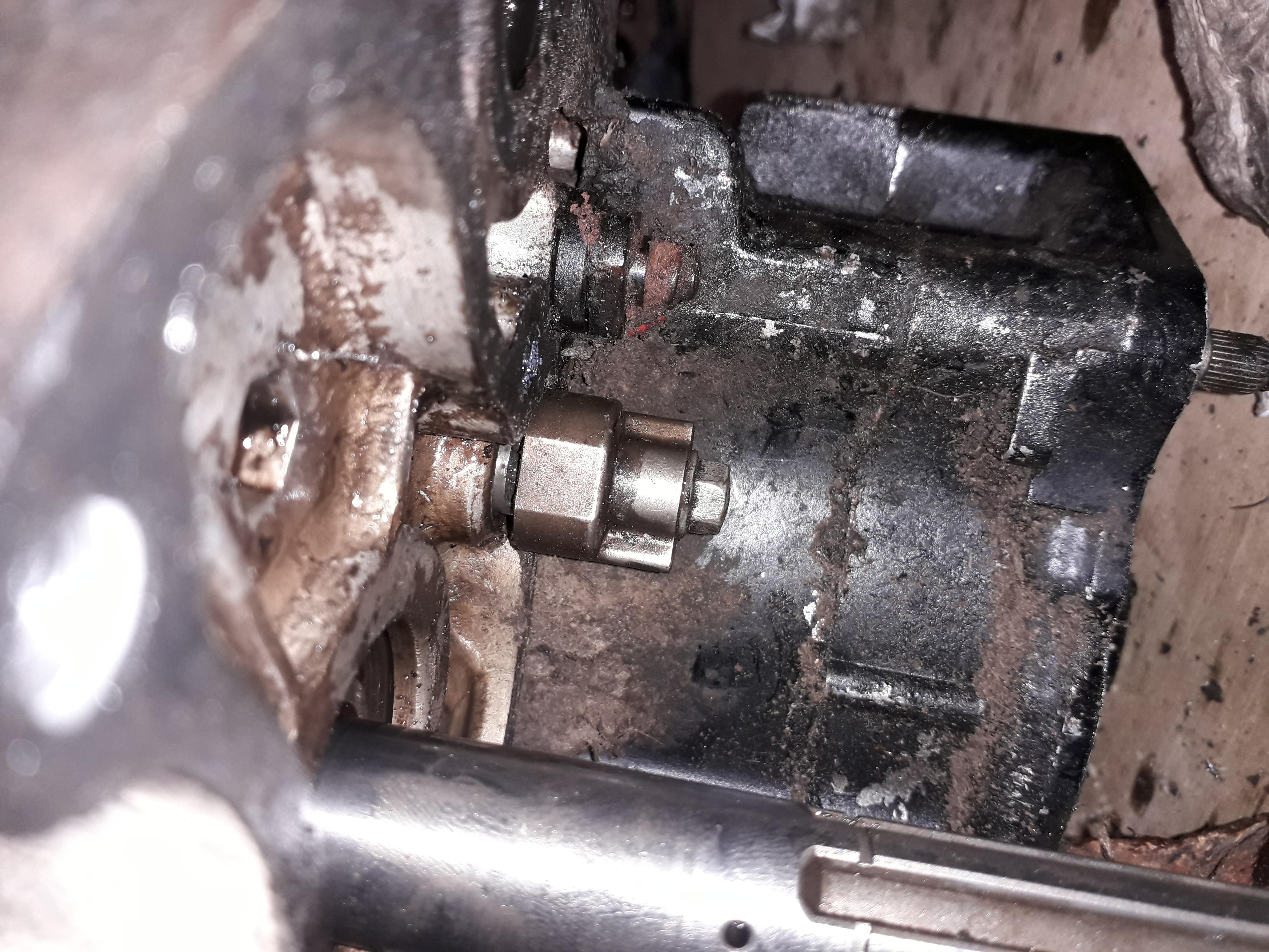

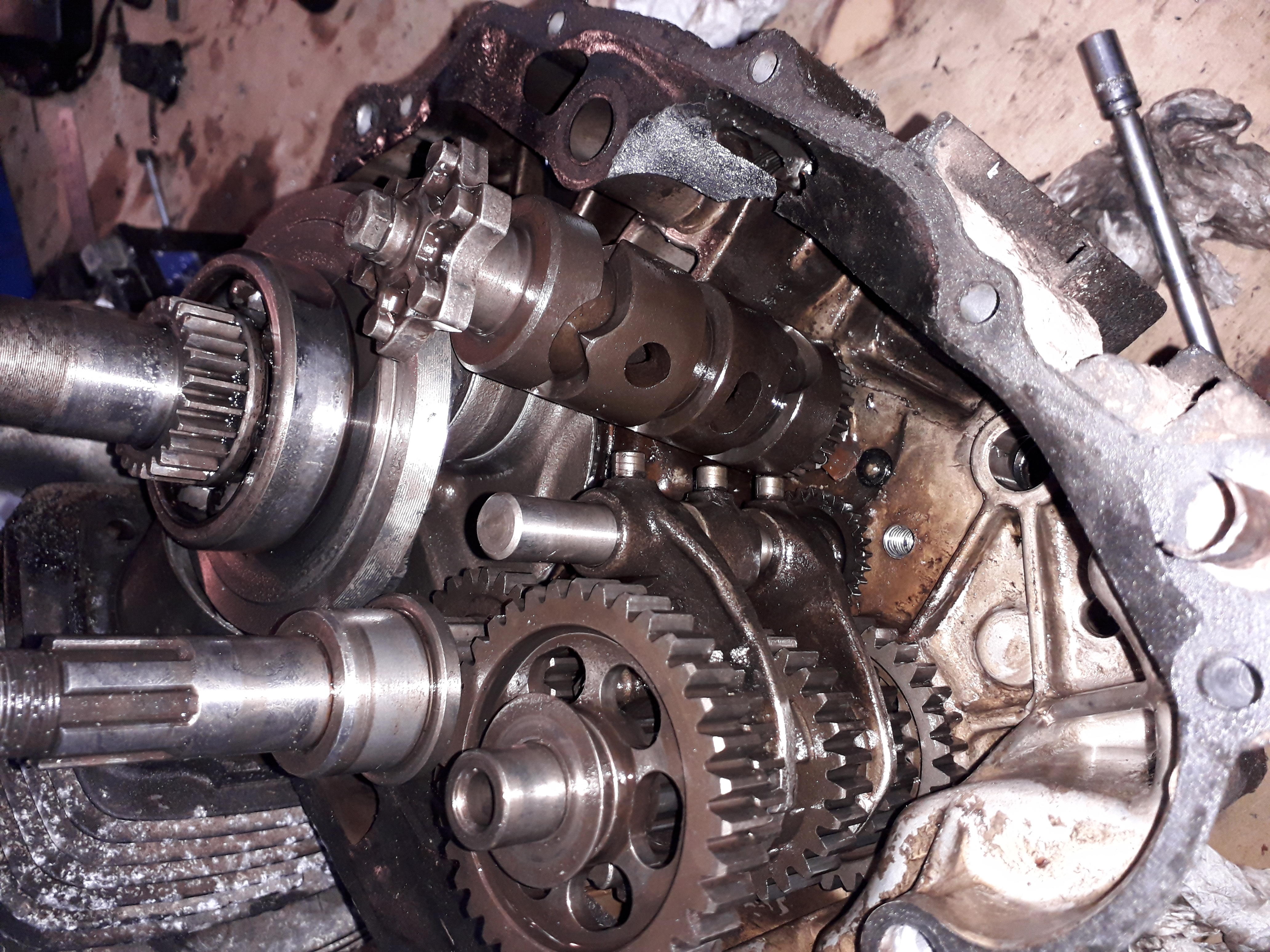

    Started the rebuild finally after getting a donor engine for parts. Im currently rebuilding the main gearbox but i cant figure this bit. The shaft the the selector arms slide on has a round bit(pictured) on the forward reverse side. And it somehow relates to the gear shifter cylinder(pictured). Can anyone tell me what orientation these should be assembled together as? Or am i suppose to unbolt that piece and set it later? Assistance plz

    Ok the parts are called the cam stopper lever which activqtes the reverse stopper lever, and the gear shift drum. They have cogs which make them move together and i think They can be installed wrong. Do you have a guide on how to orient these parts properly.

    Sounds like you just need to grab the free service manual for the reference. It has diagrams and such like I added below. There's too many pages to screen shot them all lol. Transmission section starts on page 147 in my copy.
