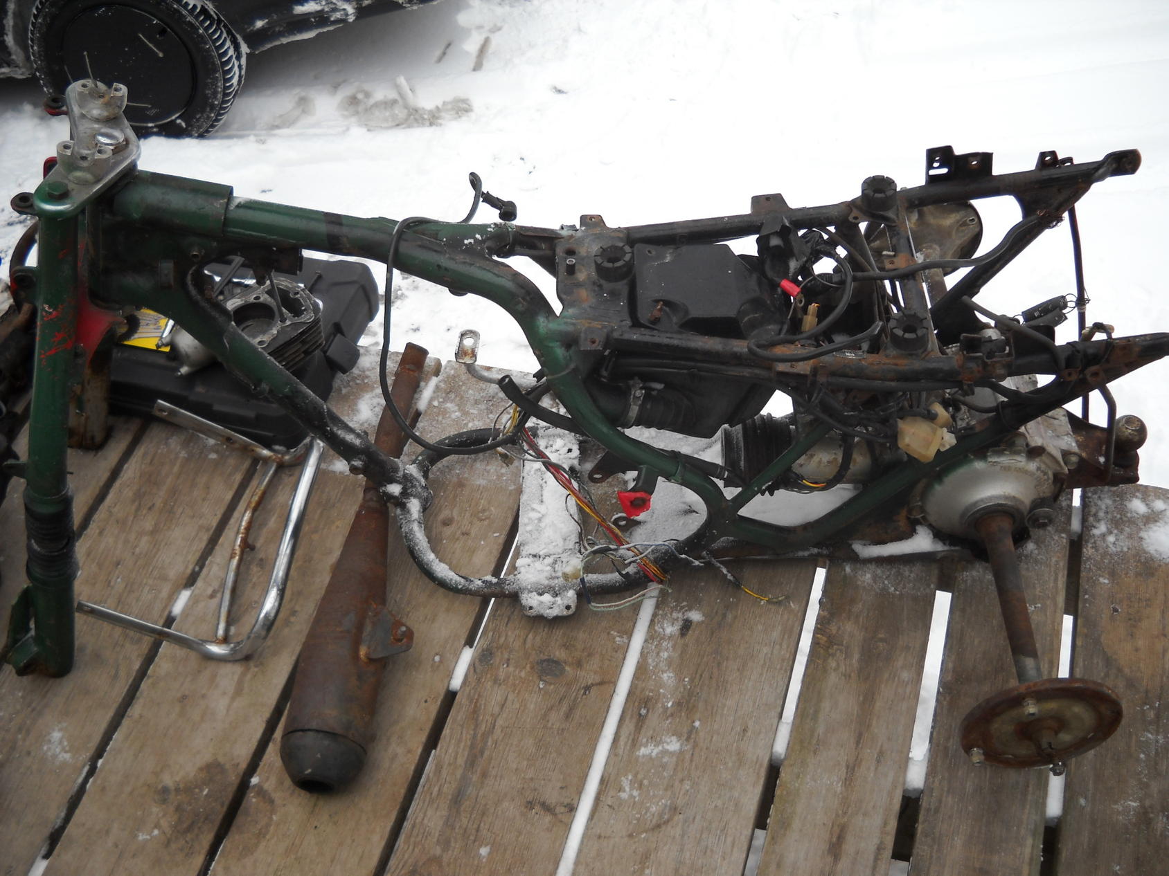

    I haven't posted a pic in a forum in years is the site to use still photobucket? I have a few pics of what I picked up so far but I need to pick up another frame and some nice rack that would be great for hauling deer or hogs. At what point should I start a new "build" thread? Thank you both for the help the vin decoder will be awesome and i have some different forks for each 200 frame I'll post some pics soon. Will a 250 2 stroke bolt into any 250 frame or would I need to pull the welder out? The 250 is the only one I dont have an engine for so the hunt continues.

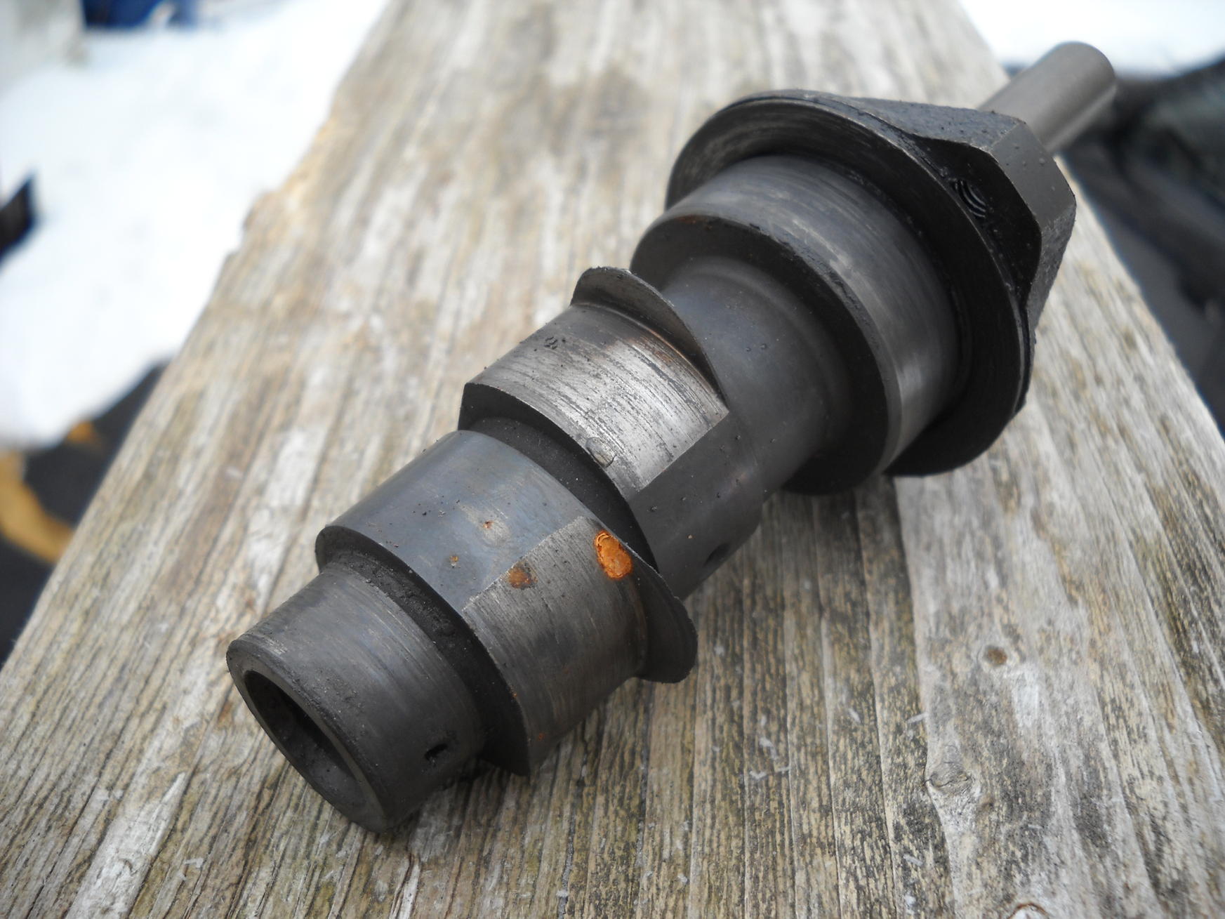

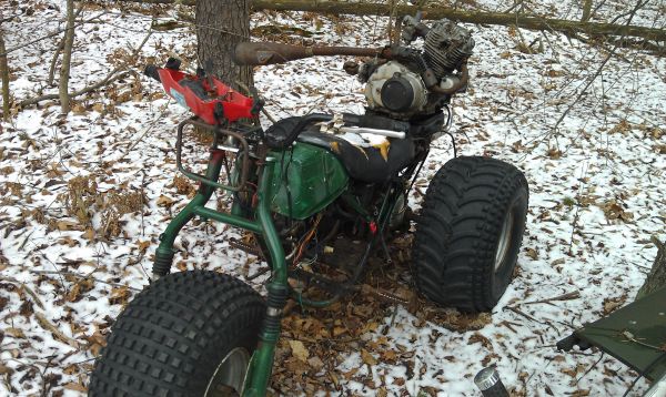

    Always fun finding old photos, I've dug though the one's I've uploaded on here before and had a lot of "I remember that" moments lol. Like this cam, I've never seen one so worn out, came from the ATC200ES machine. Last photo was from the craigslist listing, middle is what I received, listing said no tires. Also that black hub cap cover, back when I was driving my Corolla trying to break 45mpg tank average, now I'm sitting at 20mpg with a Japanese V8 Car lol.

    Lol that cam ain't got any lobe. That's worse than I've ever seen. 45 mpg is great better than I have ever got out of a vehicle but I enjoy trucks and jeeps. I dont expect anything over 20. That 3 wheeler looks like they left out more than just tires looks rough. I have been checking local craigslist for 250 engines but they are all on decent 3 wheelers nobody is just selling engines.

    At least it is a 1982 model. It's not a 250cc. It's a 1982 ATC200E. This is the first year of the Big Red 200. I was pretty sure just by looking at your first frame picture that it wasn't a 250 model. They all had rear suspension and I couldn't see any in the picture. Also the trunk underneath the rear rack kind of gives it away too. It's not shaped the same as a 250ES or SX. Just because it's not a 250, don't let that turn you away. The 200 series engines are tough, reliable, and have plenty of power unless you're trying to go to any extremes.

    Yep that's a 1982 ATC200E frame, aka 200 series engine with a transfer case, chain drive. 200M, 200S, 200, 185, 185S should be near bolt in engine swaps.
    I looked into why the VIN Decoder didn't work, looks like I had some bad data sources to base it on. I've since learned more about how the VINs are created, so I'll be updating the page to a better system down the road. Basically instead of starting with JH3, it's expecting JH1. The photo bucket banner is covering up part of the VIN, pretty sure it starts off jh3tb051, 10th digit for 1982 should be C

    JH3TB0510CC170899 is the number yes it was hard to see in the picture. I went to the shed again and looked closer. The picture was taken fast because of a red wasp nest above the 3 wheeler. I killed them and got a closer look. Ooooo I found a frame number that the 3 wheeler Yoda hasn't seen? I feel special lol. I googled around a bit and found a decoder that said tb05 is a 200. Not the end of the world just not the 250 I was hoping for. It does have some nice shocks though. So I need another 200 engine and transmission to complete all 3. I might just sell off the extra parts if I cant complete it cheap enough. Where is the best place to buy 200 parts? Do they still make old engines? I found a place that makes 250 2 stroke engines online but I didnt look deep into it. Thank you for the replies. Hopefully I'll pick up the other frame soon that has that clean looking engine in it. I bet its locked up lol it looks to clean.
