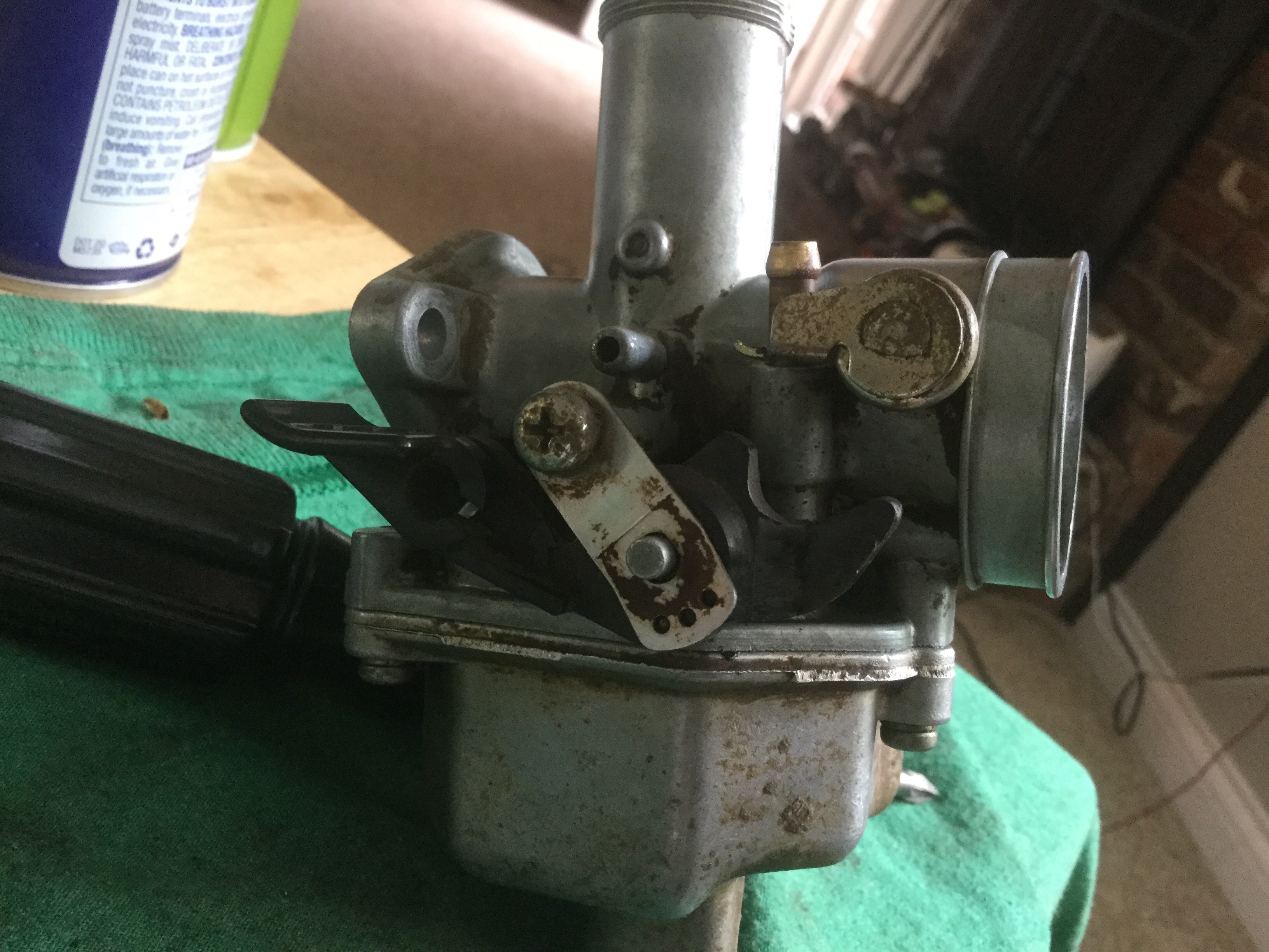

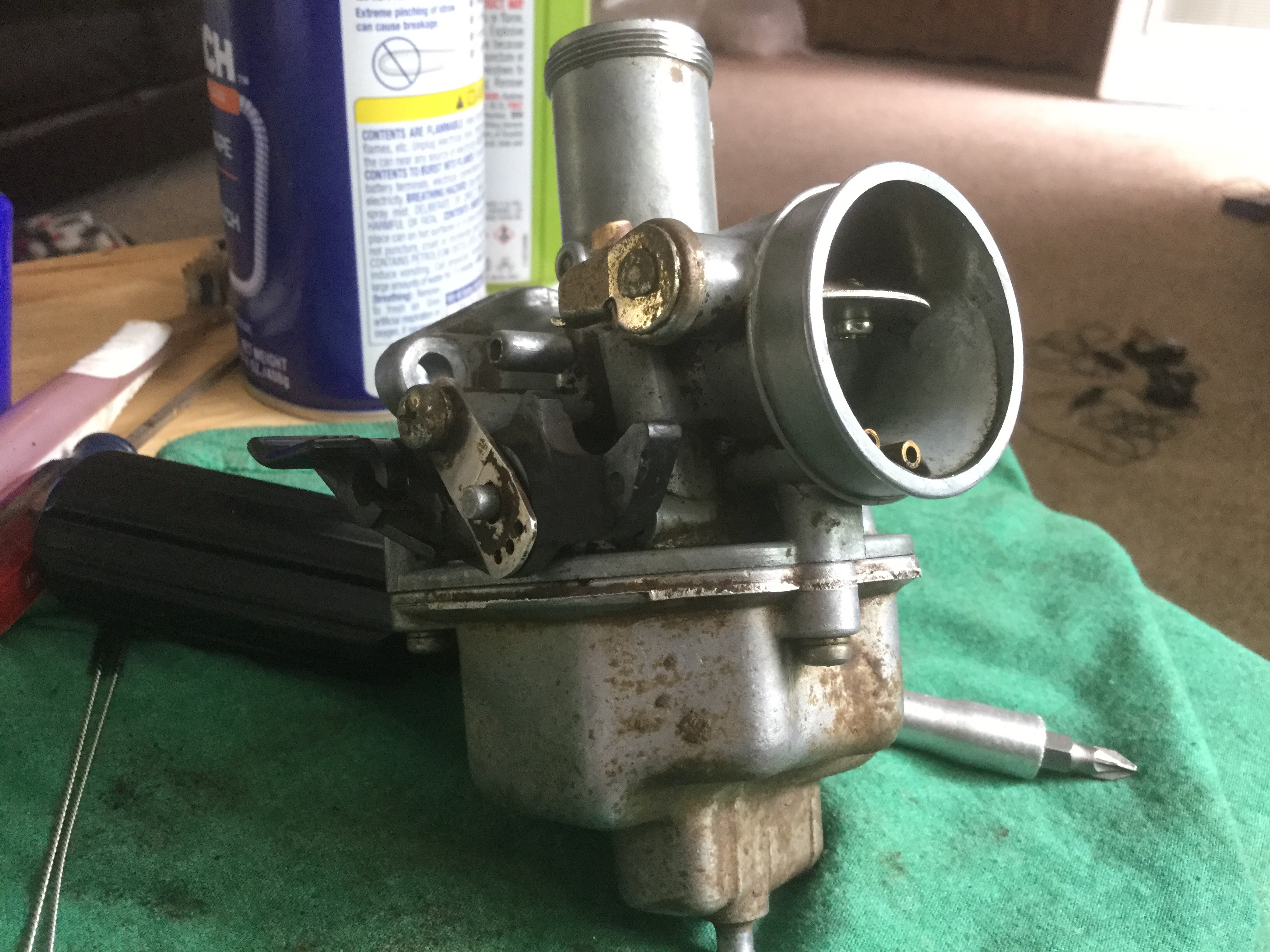

    I removed and cleaned carb. I have noticed that the butterfly plate wants to stay in the open position due to a spring.
    Shouldn’t the plate want to stay in the closed/choke position? The choke lever is then used to open the plate to the run position. It operates opposite of how it should. Please see pics of plate held in the open position.

    Ok I fixed the plate issue. Spring wasn’t engaged properly. It now closes the plate to its default position like it should.
