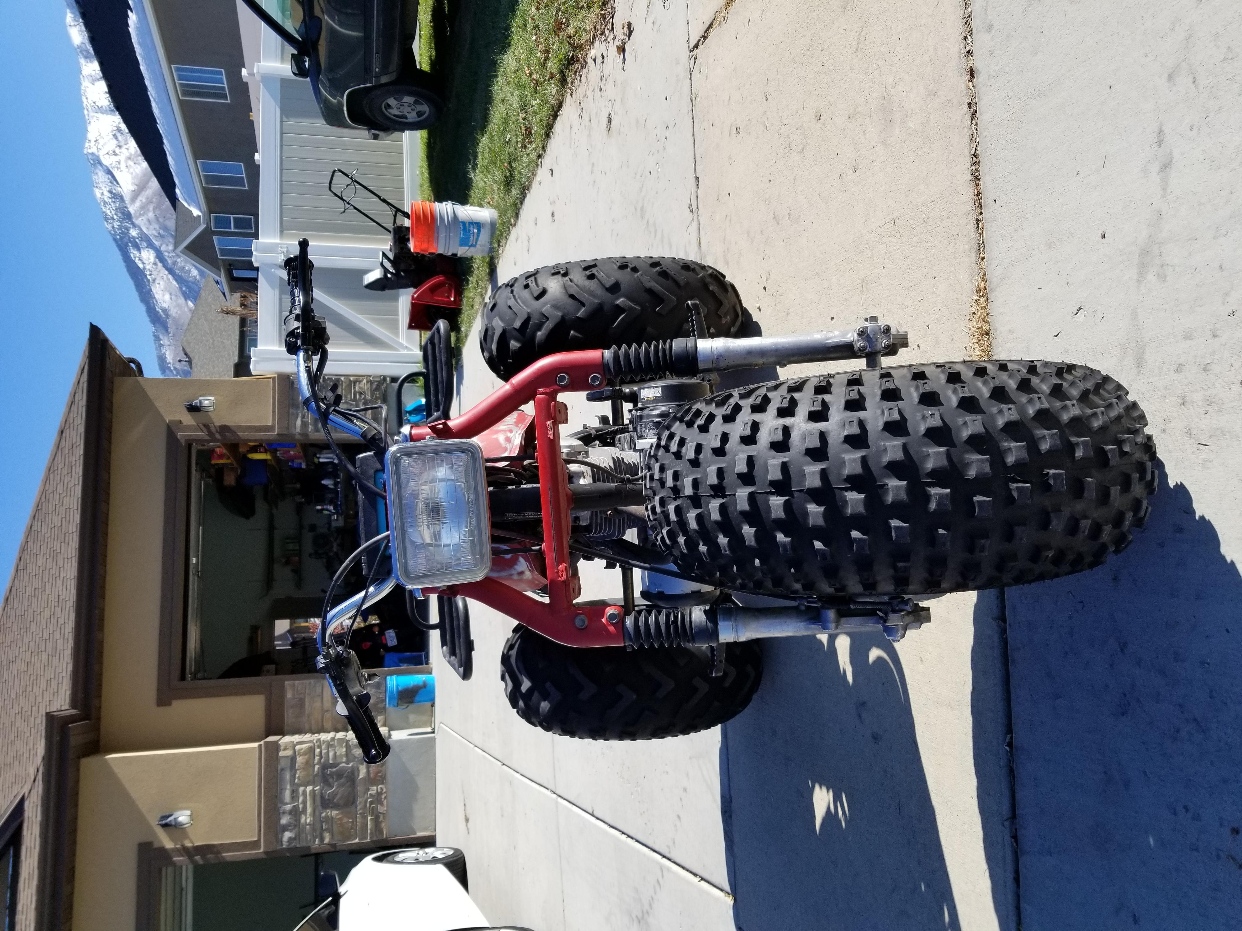

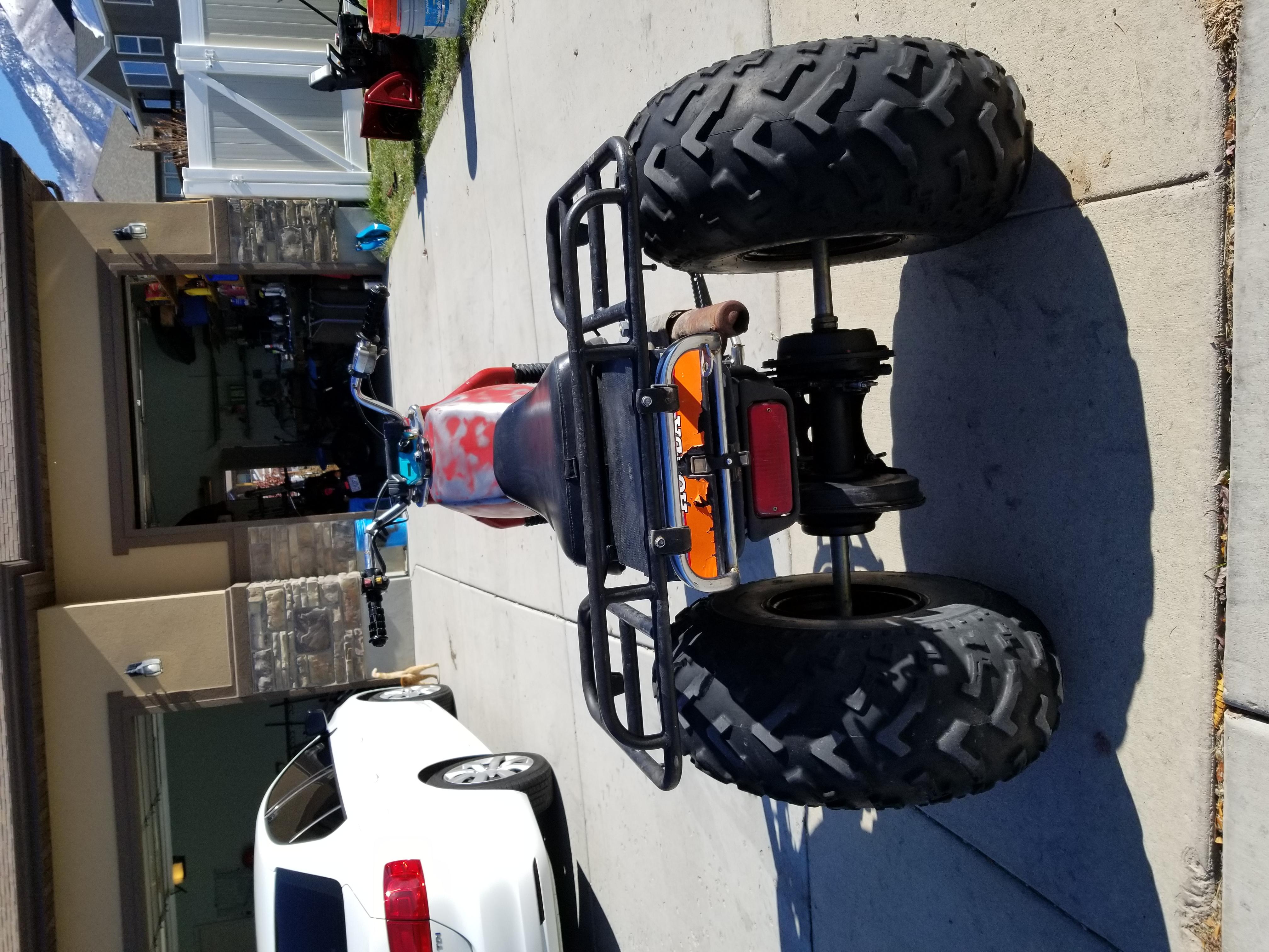

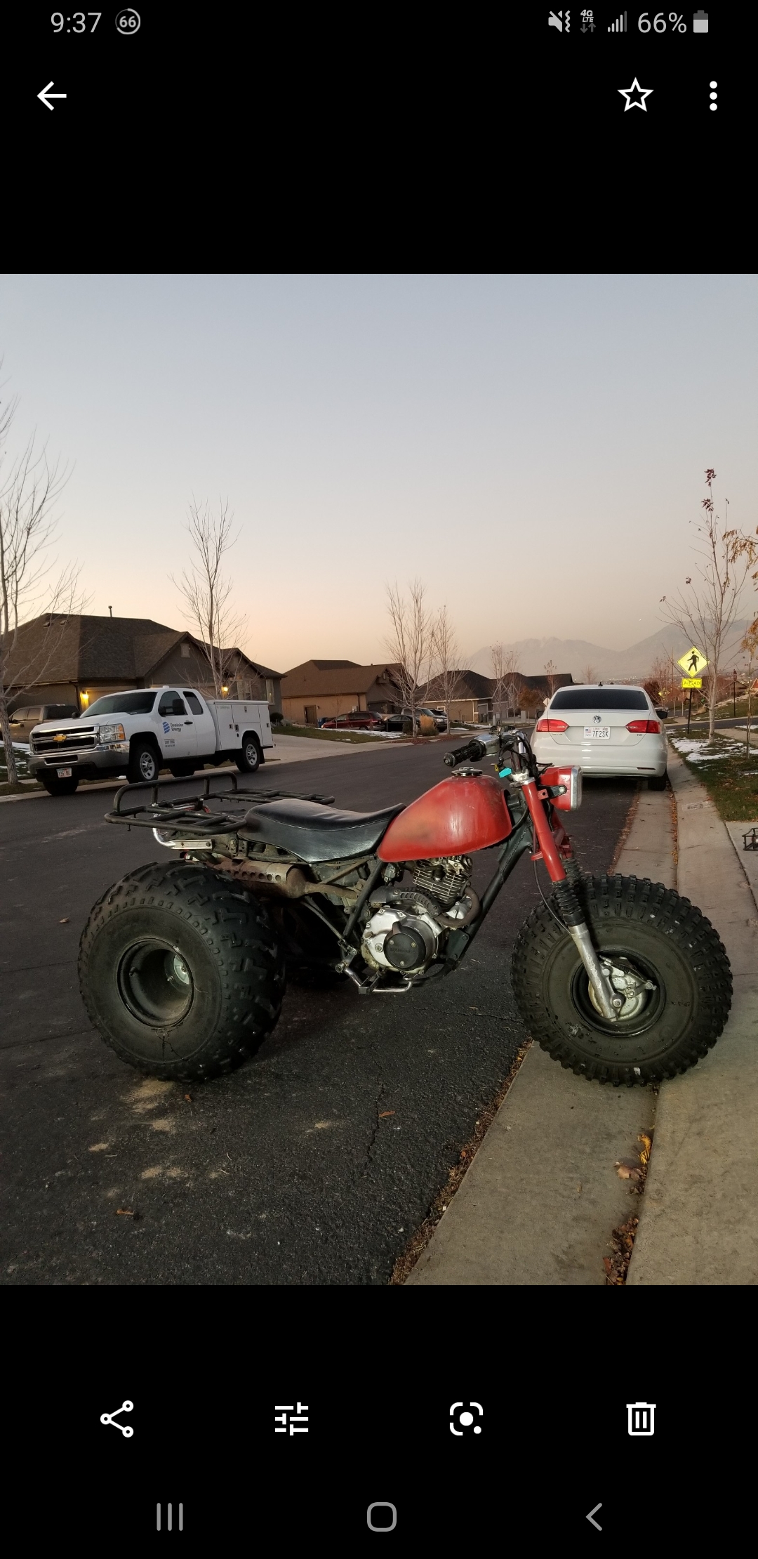

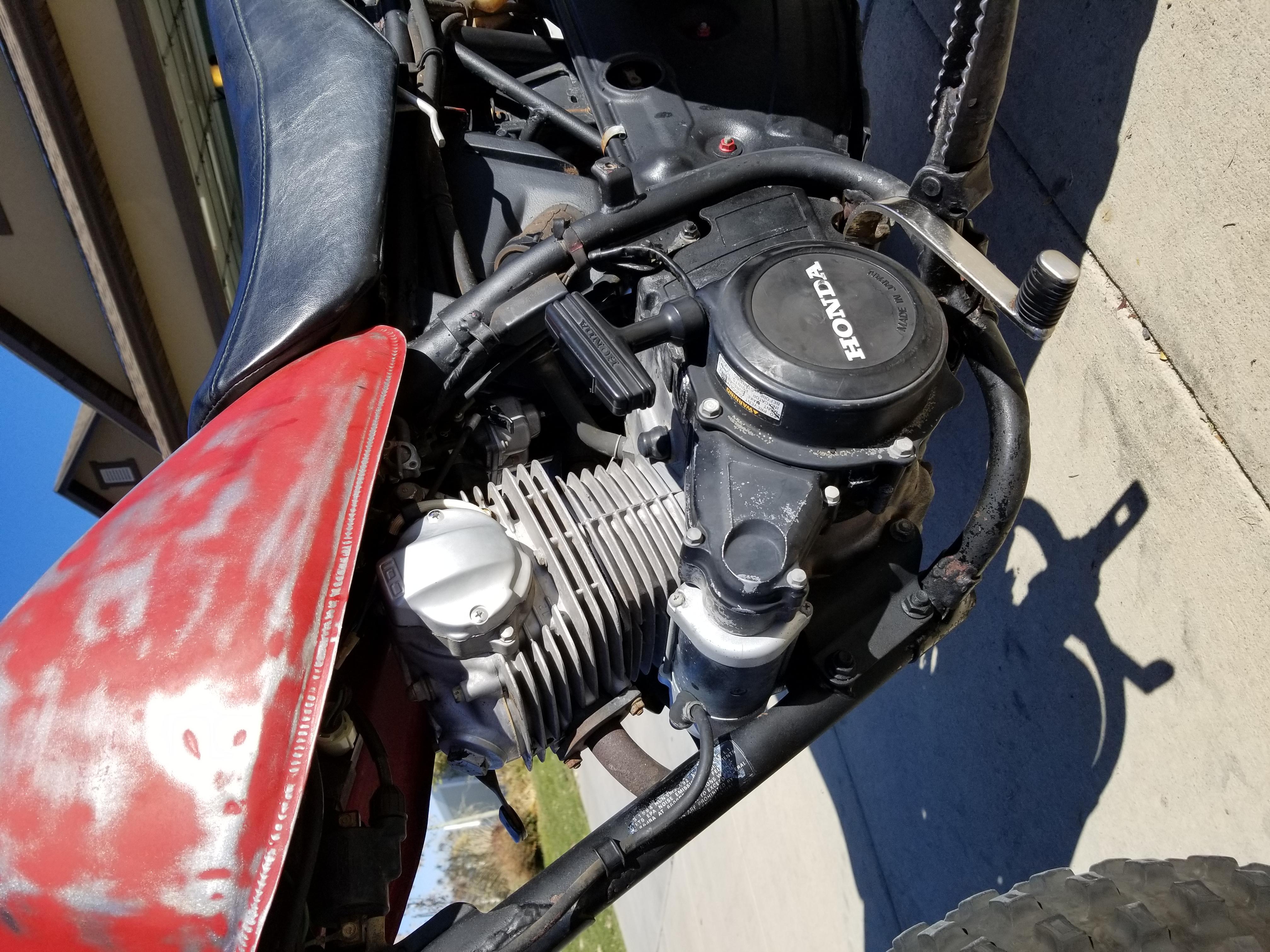

    I bought a three wheeler last week the guy told me it was a 1984 200s but I was doing research online and things aren't matching up so I wanted to see what you guys think. It's chain driven with electric start and pull start.Click image for larger version.

    I should mention that I did take off the plastics as well as a metal basket on the front.

    It's most likely a 1984 ATC 200m .

    You can also use my site below to look up the VIN number on the neck of the frame as well as the engine's serial number which should be near the bottom of the case near the sprocket area.
    http://atvmanual.com/honda/interacti...er-atv-and-atc
    If there's a mix of parts, I have some machines covered in my post detailing year to year differences for different harnesses. If it's a 200m I can look at the harnesses I have on hand so you know if the harness is an 84 vs 85. Might help tell a story on what happened with the machine and what all it's been merged with.

    200cc, Chain drive, electric start & NO transfer case.....that can only be an "M" engine.
