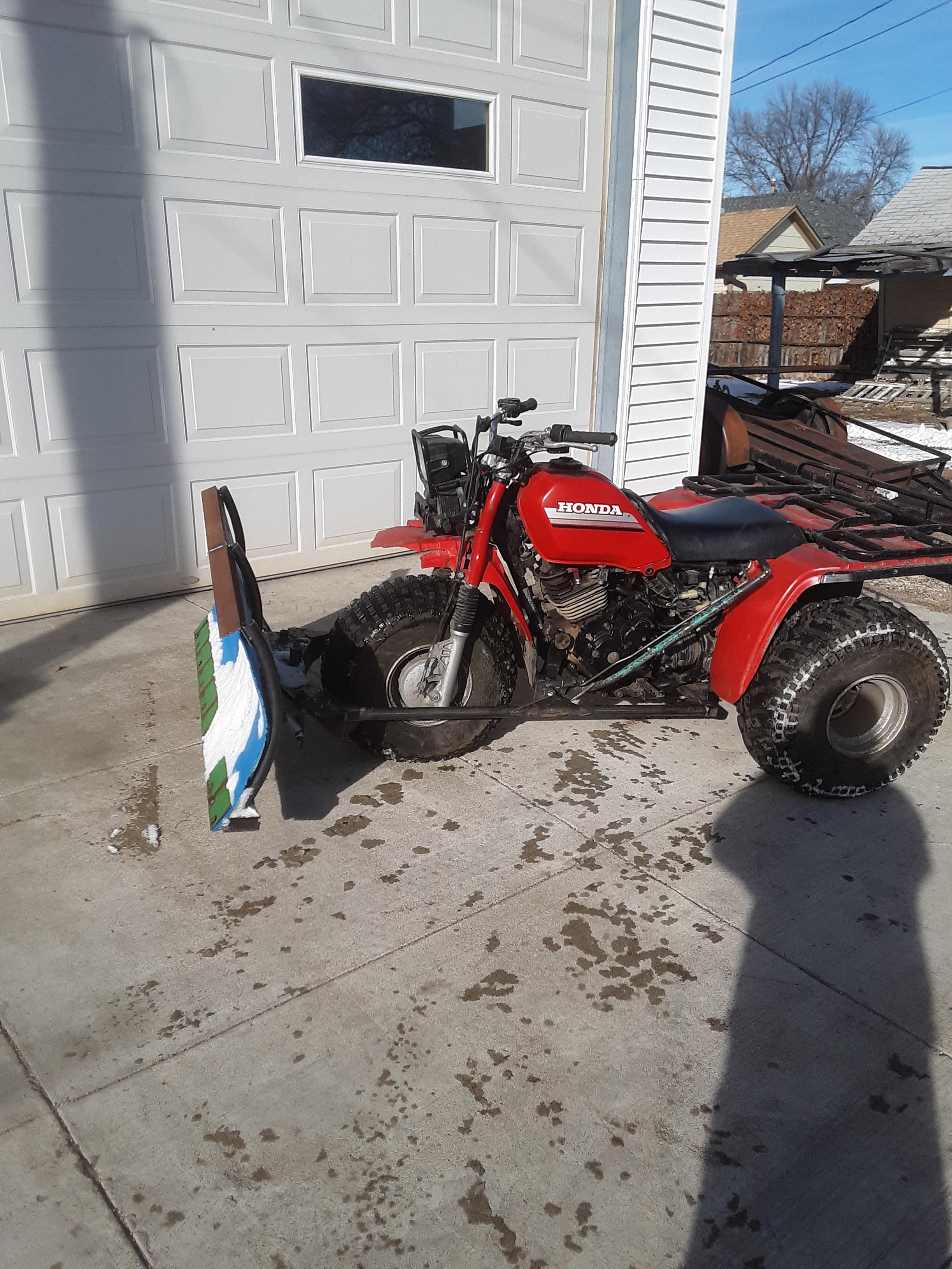

    This is the runner. Parts machine is in storage elsewhere.

    Since the 250sx engine is in the 250es frame, you're gearing will be a little higher than stock. If you rode a 250es with the stock setup you'd notice it had more power for take off etc, but high gears it would rev out before hitting max speed. 250es stock tire size is 25in, 250sx is 22in, the final gearing is about the same for both if you account for tire size, difference in gearing is in the engine's transmission and rear diff. The 250es and 250sx are effectively the same engine besides the gearing difference and color difference with possible minor differences. Both use the same CDI box too as long as you match up the connector type (85 vs 86-87).
    Looking at the photo, I see the front fender is trashed as well as the front rack. I think I have an "ok" front fender maybe even a good one if it bothers you at all. The front rack I suspect you'd probably build yourself vs buying? I think I have a spare bent up one which should be about perfect for a machine being used for work vs looks. Not sure how killer shipping would be, both large items, but I'd prefer to ship them in their own boxes so the rack can't damage the fender if the box is thrown or dropped.
    Also looking at the pics, I see the head is dirty, but the cylinder is fairly clean. I'd say check the valve adjuster caps to make sure they are tight (not super tight) and if so, remove them and replace the O-Rings on them. Clean the head with some de-greaser and if the oil residue comes back you should be able to see the souce a little easier. Could be the valve cover leaking which I'd suggest Gray RTV, much easier to work with than Hondabond and similar named products. If I recall correctly, some of the valve cover bolts have copper washers to seal the bolt holes from leaking and the oil tube the runs from the crank case to the valve cover. Not really a big issue with the leaking top end, just something that could be fixed to keep cooling at peak performance and no oil disappearing over time.
    You're also missing the plastic side cover(s) but not really a big deal unless you want an OEM correct machine. They do cover the electricals up a bit and last I checked there is an aftermarket option for them. OEM I suspect is around $100 used per side.

    Thanks for your reply. Both my machines are 1985s, one in April and the other in July if memory serves. I put my power washer away for the winter so Big Red is still dirty. Some warm Saturday morning I might run it down to my former employer (John Deere dealer) and give it a quick squirt. I downloaded the shop manual for the powertrain and will study it a little closer when I get closer to deciding whether to repair or part out the 250 ES OEM engine. I would bet the engine for the 250 ES is in better condition judging by the relative good appearance of the ES versus the trashed appearance of the SX. Since I discovered 5th gear is out on the SX powertrain I might be looking into doing some more swapping, but not right away. I am hoping to make a few bucks pushing snow.

    Most of my stuff is pretty old and doesn't all look like new, but everything works. The plastics on Big Red are not a big priority right now. I likely will not paint the blade until I have used it for a few storms to make sure everything works as it should. I HATE grinding off paint to weld something and I would rather make sure my design is sound before I doll it up with paint.
