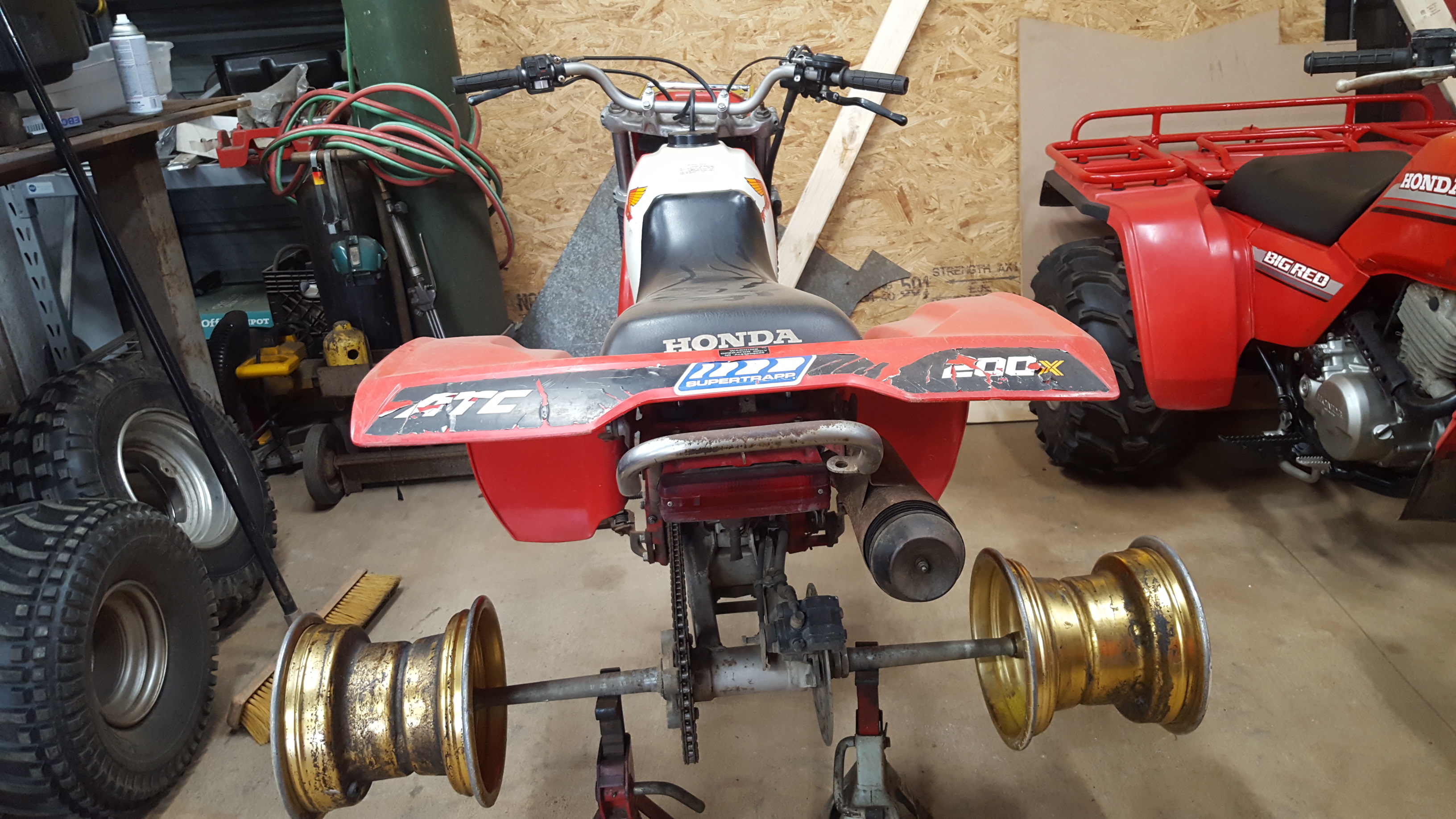

    Oh crap, is the front hub different 200x vs 250r?
    I have an 11inch gold enkei rim but the pattern is bigger than my 200x hub. Crap! That's what I het for not checking.
    Options? Different hub or different wheel?
    to add another problem my 2 inch spacer wont fit the OE 8 inch wheels.
    Mrc.

    The front rim you have is 3rd gen 250r. The bolt pattern is smaller than 83-85 200x. It will be cheaper to buy a set of rear hubs like listed above than buying new studs.

    As for the front hub, would a gen 3 250r hub fit my 200x?
    or should I look for a different rim?
    If I scrap the whole plan, what wheel spacers would fit my 8in factory 200x wheels?

    You can get an 86-87 200x,85-86 350x or 85-86 250r front hub for your rim.Or get 83-85 200x or 83-84 250r front rim for your hub.

    The 200x 8" wheels are unique as the inside diameter of wheel is smaller than all others. Have the outside diameter of the spacers you have machined smaller.

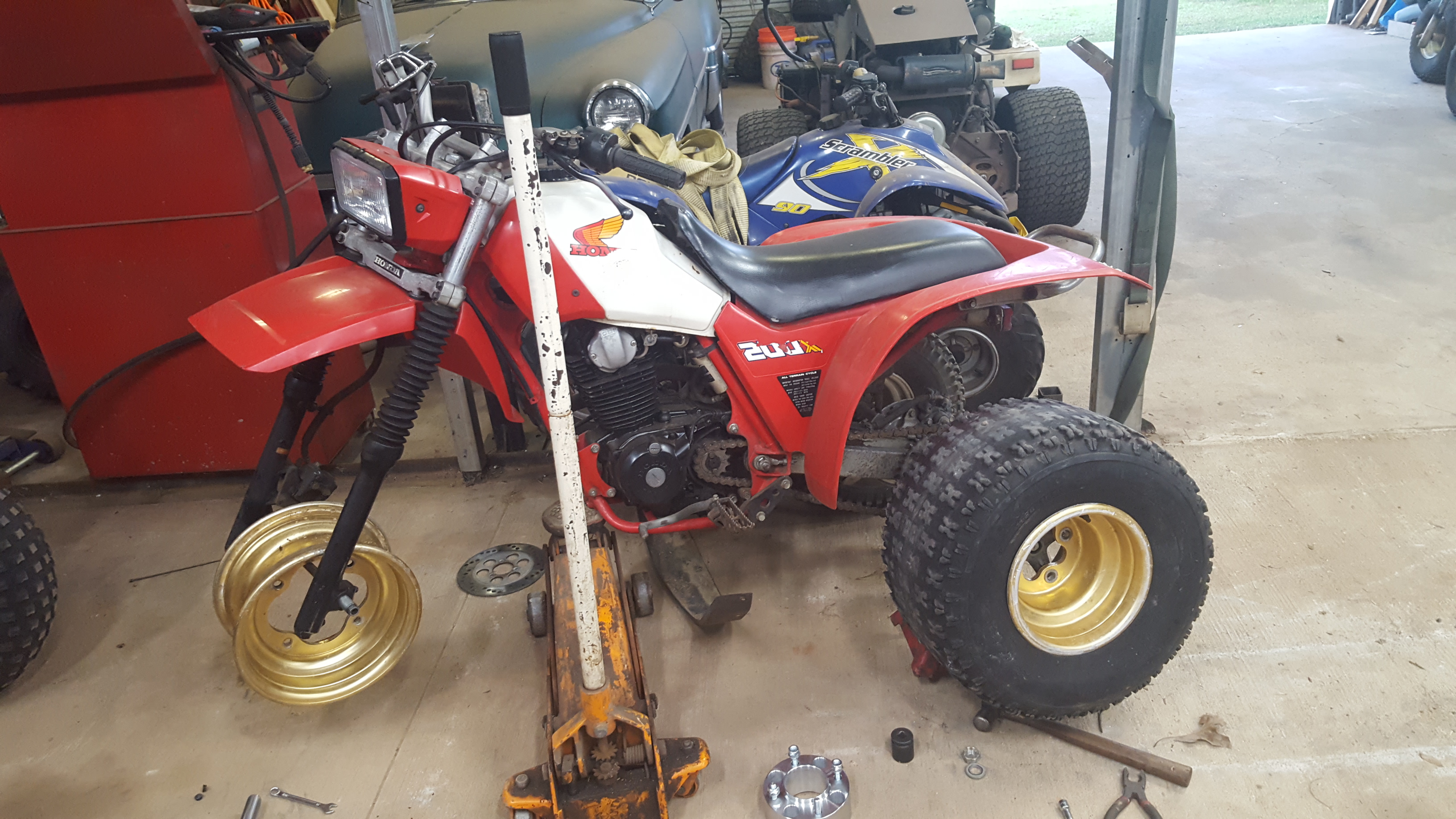

    I opted to buy a new front rim 83/84 gold 250r and a pair of 300ex hubs and 8 flat lug nuts with coned shape washers.
    Thanks for all the help.
    MrC.

    ATC300r, I wanted to come back to this thread and thank you for your incite and help, I got a new front rim that matched my currant 200x hub and a pair of new 400ex rear hubs along with some cone washers and lug nuts, it all fit together perfect tonight, I am just waiting on my rear tires. Thank you again.
    MrC.
