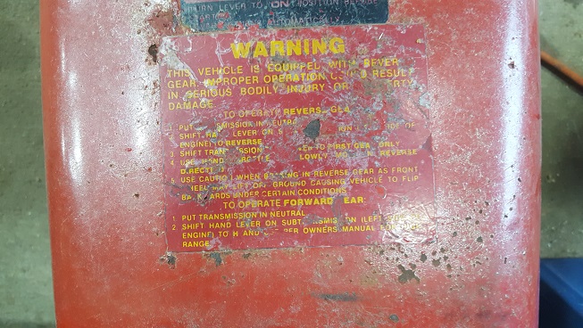

    There were 2 stickers; a large red one placed on the tank with gold writing explaining how to shift into reverse and a reverse sticker that was placed on the sub trans, look for a photo of the bike that may have those stickers on it.

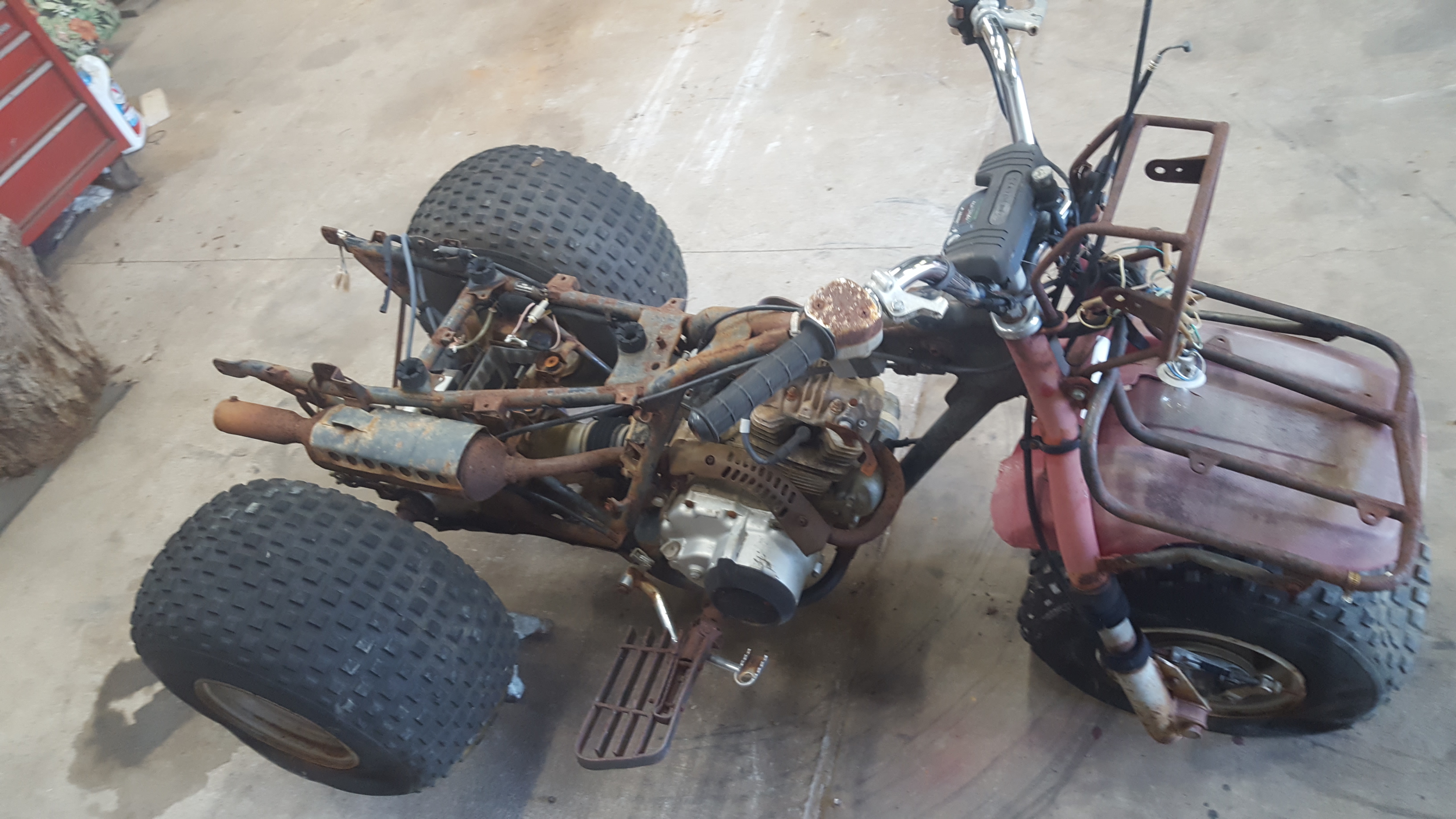

    Update,
    We may owe you an apology,
    I may have found a really rare bike, or if nothing else a early production bike.
    I found this one in a junk yard, a few weeks ago, yesterday I started to see if it would run.
    I assumed it was a 84, it had high, low and reverse just like every 84 I have had in the past.
    I looking at the ID sticker and can clearly read 9/83, I will run the serial number tonight and the engine number to
    double check, but this could be a late 83 big red with reverse, so your childhood memory may be correct.
    MrC.

    Being built in 9/83, it is most likely an early 1984 200ES.
