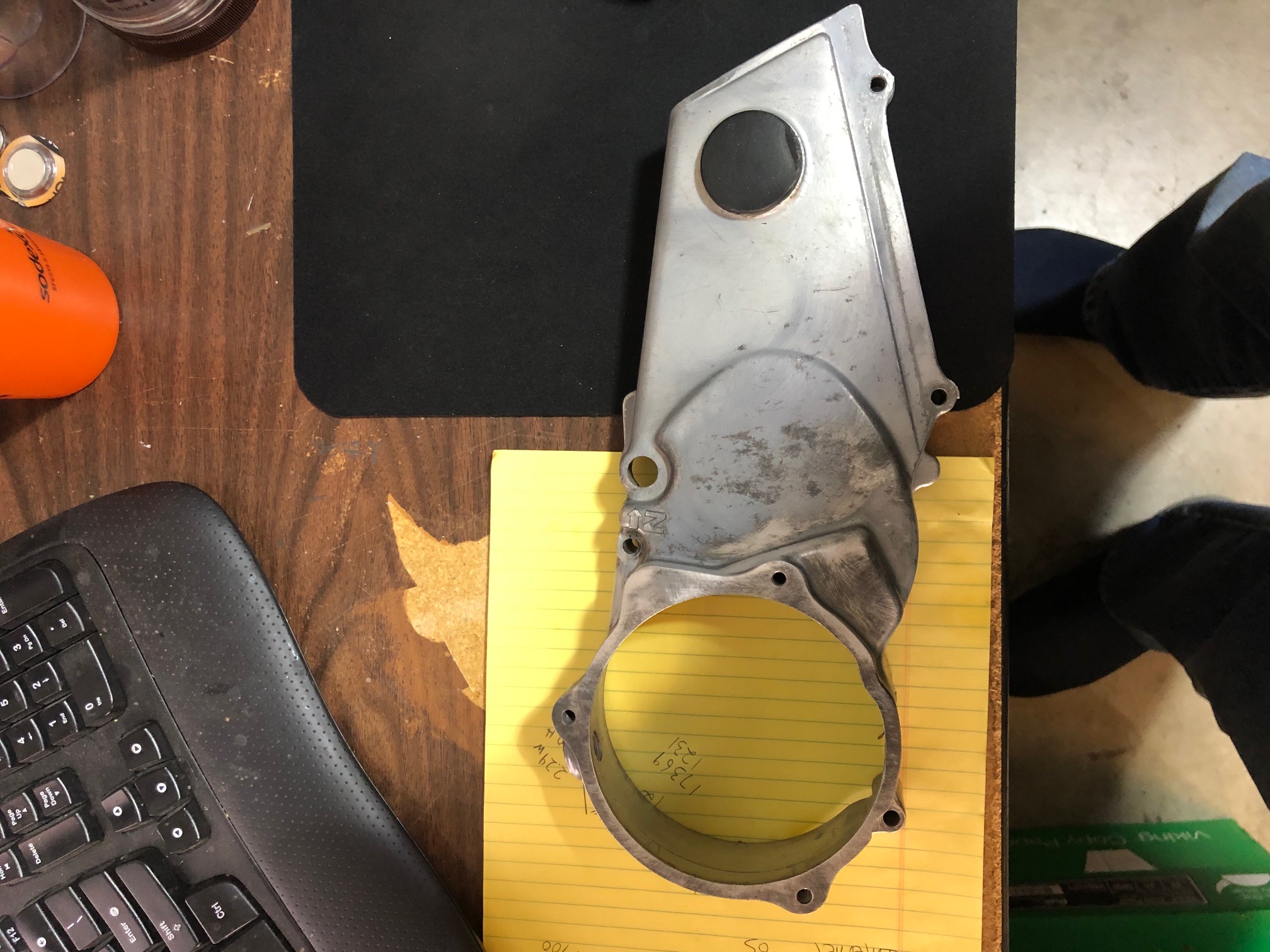

    Here are the parts we have acquired
    Flywheel Case

    It appears there is some difference between 85 Atc 70 left case cover. You can look it up on partzilla. Not sure what, but part numbers are different. Your cover looks different than my 85.
    I don’t see a pulley in your pic, just the flywheel? Anyway, I found a case, pulley and recoil starter for under $300. Instead of posting it, it’s being shipped and will be yours if you want it, pm me your number.

    Your left side cover looks like it’s for a trx70
