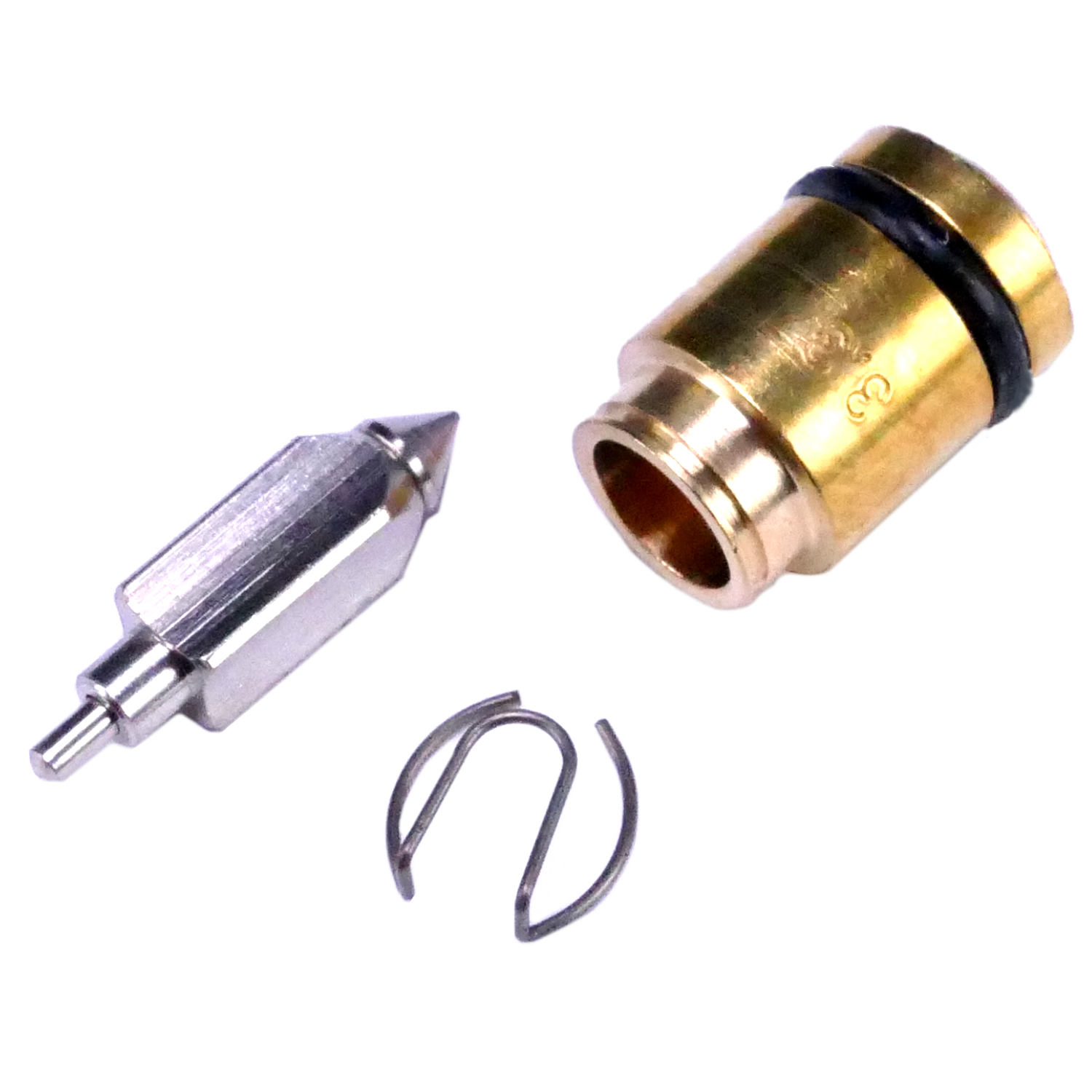

    As others have mentioned, the "needle" (fuel shut off valve) in your carburetor may not be sealing completely. Unfortunately, there is no way to check the fuel level in this particular carb with a hose as shown below unless you modify your drain bolt, so there are a couple options to determine if the float level is too high and/or if the needle is leaking. Below are a few.
    Remove the slide from the carb.
    Remove the carb.
    Drain the fuel out of the carb via the large nut on the bottom or by turning it upside down.
    Place the carb on a box or something next to the bike and below the level of the fuel tank.
    Connect a fuel hose to the tank and carb.
    Hold the carb upright.
    Turn the fuel on.
    If gas starts leaking out either end of the carb within 2 minutes, the fuel level is too high for some reason.
    Regardless of the results of the above test, turn off gas at tank.
    Drain gas in carb.
    Remove the float bowl.
    Turn carburetor upside down.
    Turn gas on and look at needle. If gas gas leaks out, the needle/seat is bad or the 0 ring on the outside of the needle seat is leaking, and the needle/seat assembly should be replaced.
    If you do not see gas leaking, then most likely your float level is tool high. The part number is 16030-1020, however, it will be hard to find.
    If you do not see gas leaking, remove the needle then try pressing down lightly on the tiny metal pin on it. If this pin does not move, you need to free it up but it can be tricky to do. Do NOT grab this pin with pliers as it can damage it.
    This is a common needle and seat. The seat is the brass part. The needles often have a rubber tip instead of the steel one shown below.
