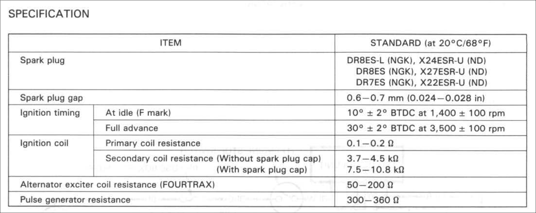

    A reading of 370 ohms vs max allowed reading being 363 I'd count as within spec, big time if it's hot where you're at since those figures are likely around 70F. Hotter the coils get, the higher the ohms it reads, lower the temp the lower the ohms is, that's why there's a range, that and each one might have a slightly different length of wire in the coil.

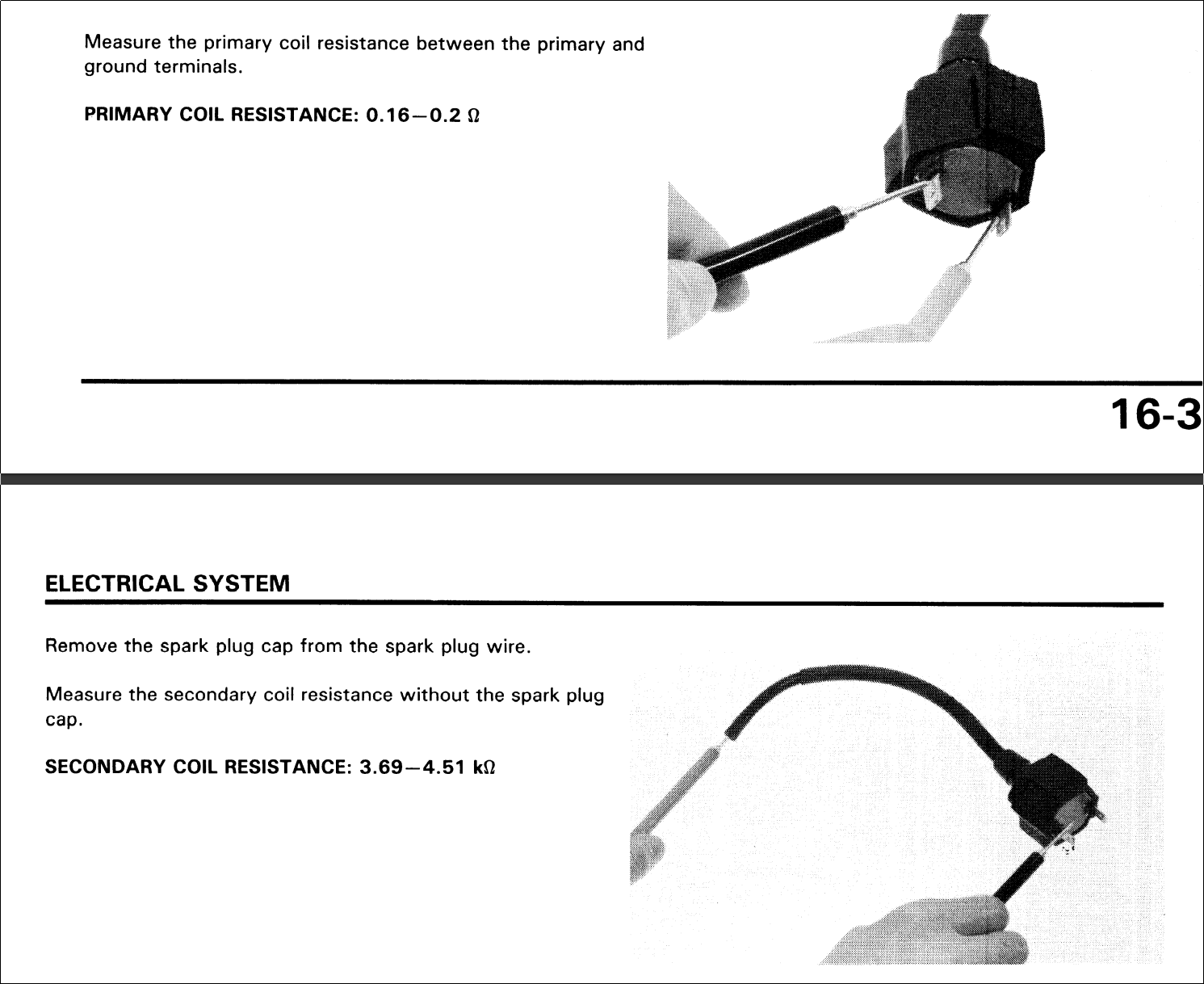

    Coil specs seem to be pretty far out, 0.2 ohms is the max, looks like you're reading 1.2 ohms (6x higher resistance). How does the other coils you have measure up?
    Looked up the specs for the TRX350 and TRX350D, looks like with out spark plug cap it's pretty similar specs, my guess with the spark plug cap on wasn't too far off too =). Also note the top row, standard is at 68F, clearly you can't perfectly measure at that temp, so being outside of the range a little bit is no problem if it lines up with the temp difference.
    FYI, Fourtrax has the AC CDI and an exciter coil, Foreman has the DC CDI and no exciter coil.
