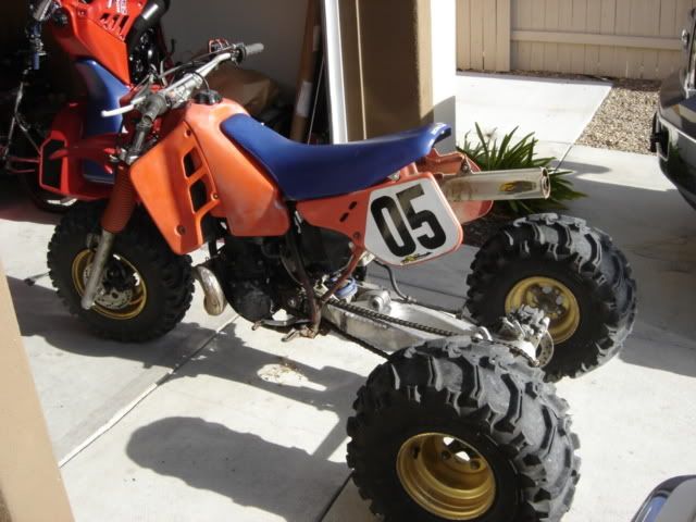

    just some pics of the cr500 with the new swinger (mocked up) and front end on. i just pieced things together to see what else i need. it will be running a complete trx450r rear set up. i cant quite figure out a good way to make sure everyhting lined up correctly. the chain looks right on, but i'm not sure how squre the rear axle is to the centerline of the bike since it's offset. anybody got any suggestions??? i havnt welded ereyhting up cause i want a little input first.

    here it is after it's first ride. all the rear parts are from a trx450r, grafted to the original cr500 swingarm. CRAZY FAST!!!! it still is running the cr500 seat and subframe, but i just started working on that today.
