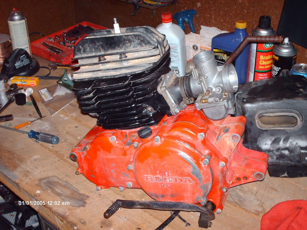

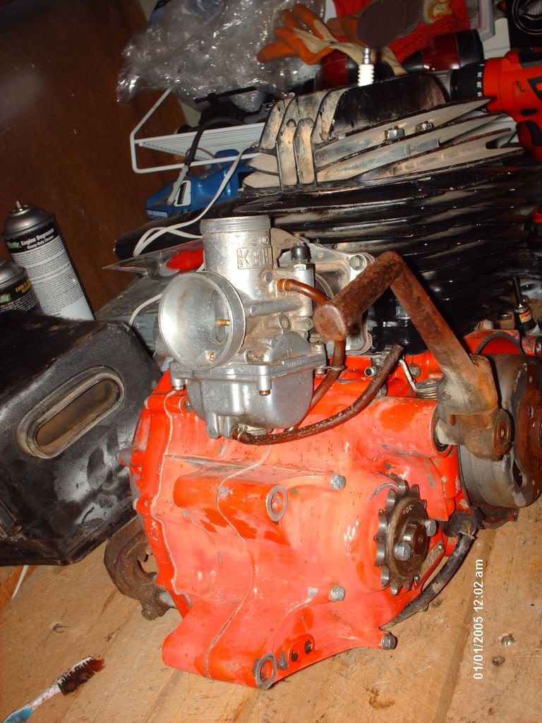

    hey guys im new on here and just got a 250r for a couple hundred and i had bought a carb off ebay and it is from a 87 and newer 250r i was wondering if i could use it on this 82 250r or will it not and i need to buy a 81 to 84 250r carb i will post pics up as soon as i get them on here

    im using the same carb the only thing i se is rejetting but thats simple you will also have to stretch the intake boot but other than that its an excellent upgrade. good luck.

    yes the carb from an 87 TRX is heck of an update from the stock 82.
    I would buy a new pipe for the R, rejet the 87 carb, and you'll feel a BIG difference.

    If you go on bike bandit oem parts you can buy an 85 odyssey fl350 intake boot for $35.00 and that carb will slide right in thats what I use.

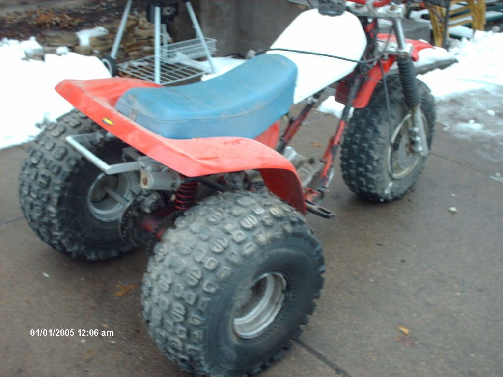

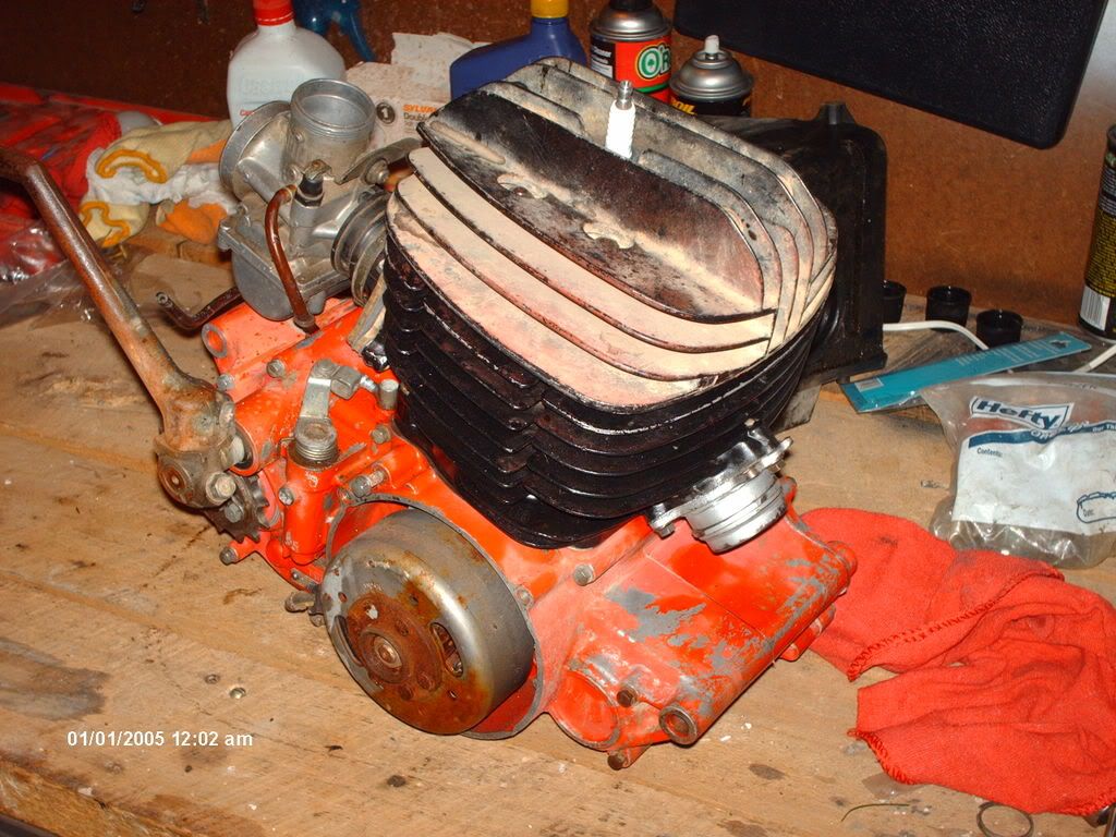

    Quote Originally Posted by 82atc250r View Post

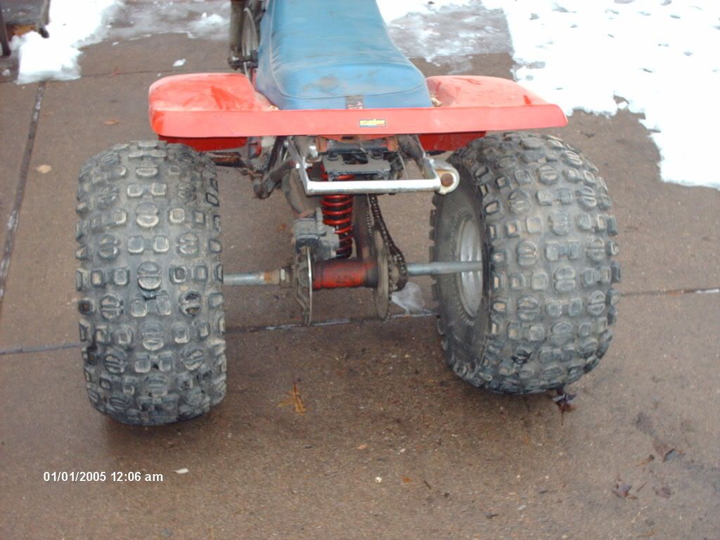

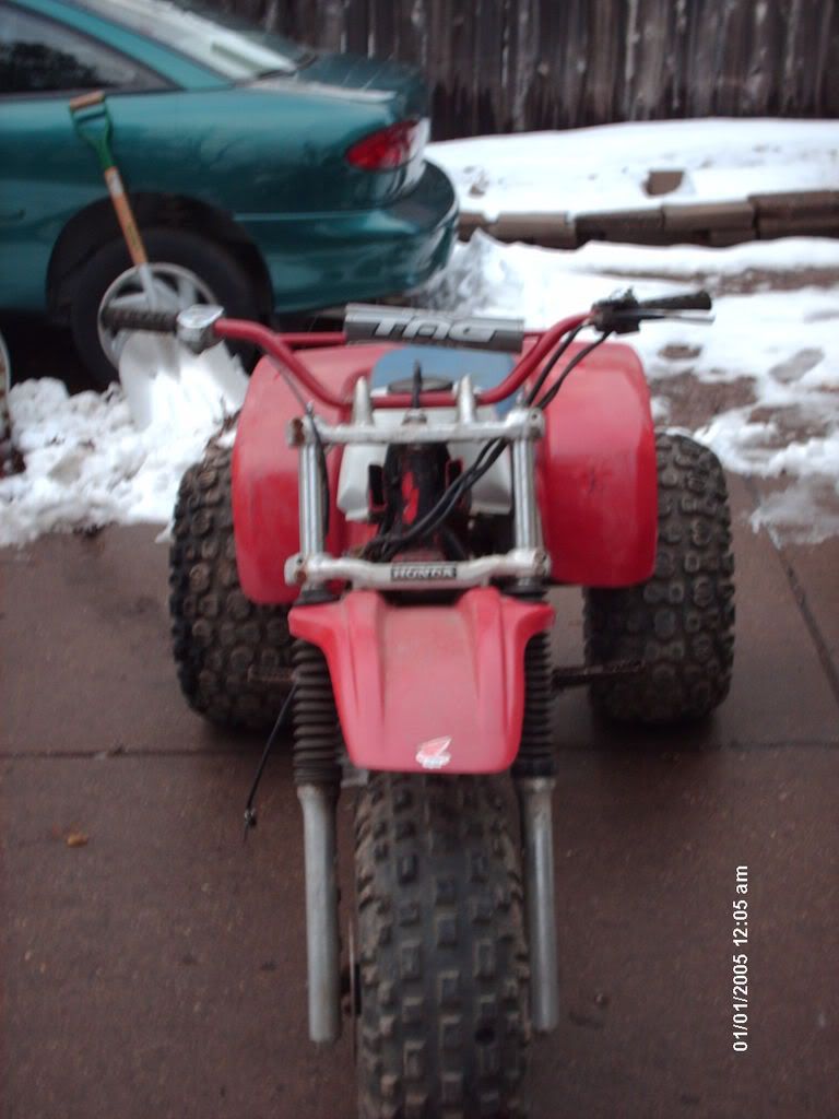

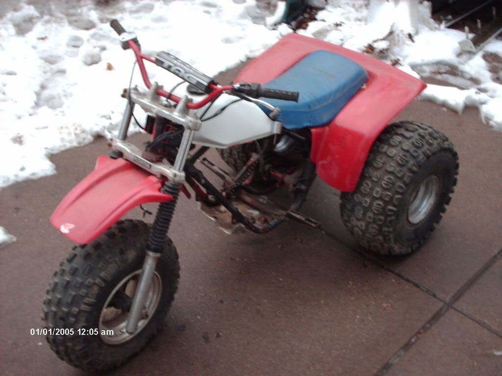

    here are the pics i have so far
    Apr 2007
    Springfield, PA
    889
    not bad, have fun with it. you'll get lots of comments about the trail pros. any special plans for it?
