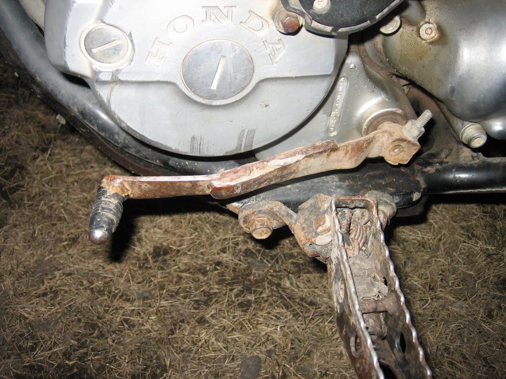

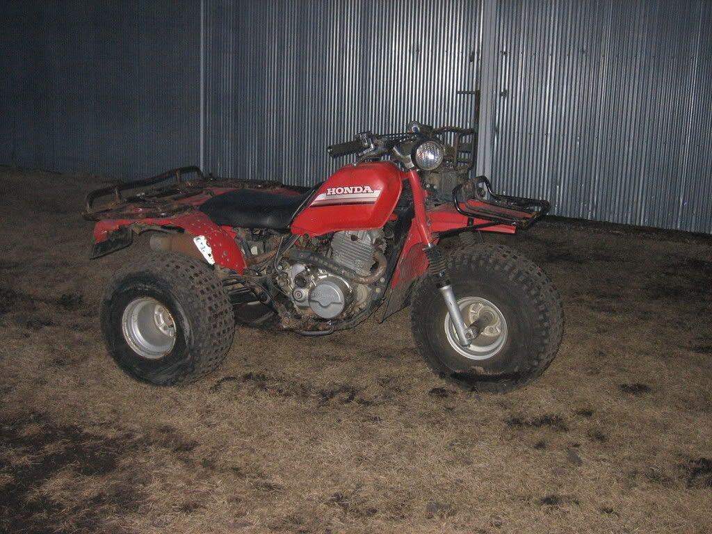

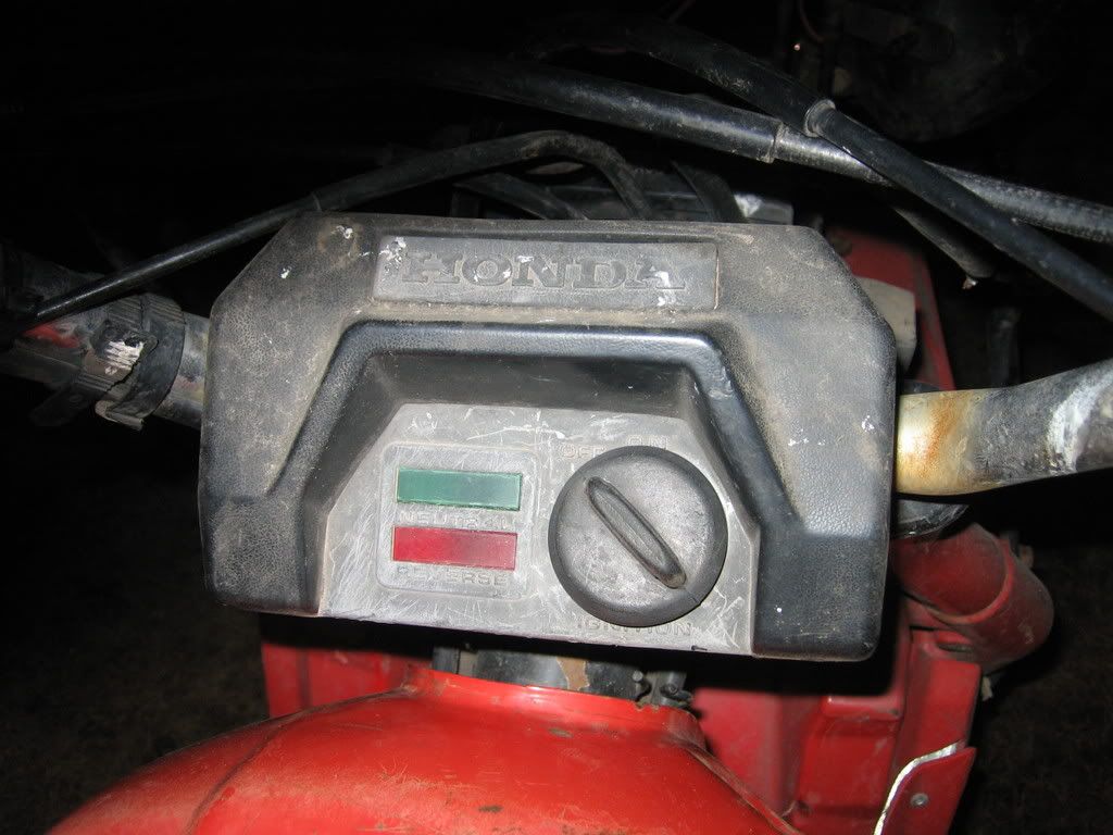

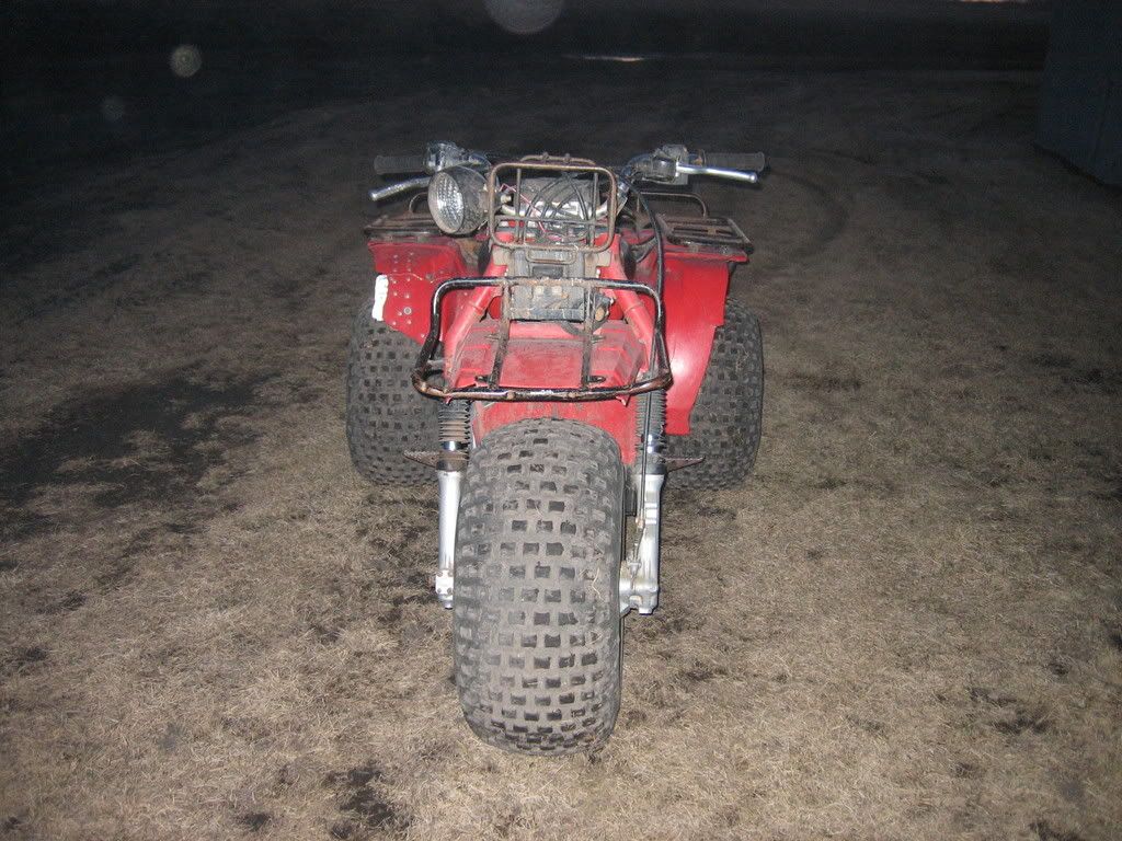

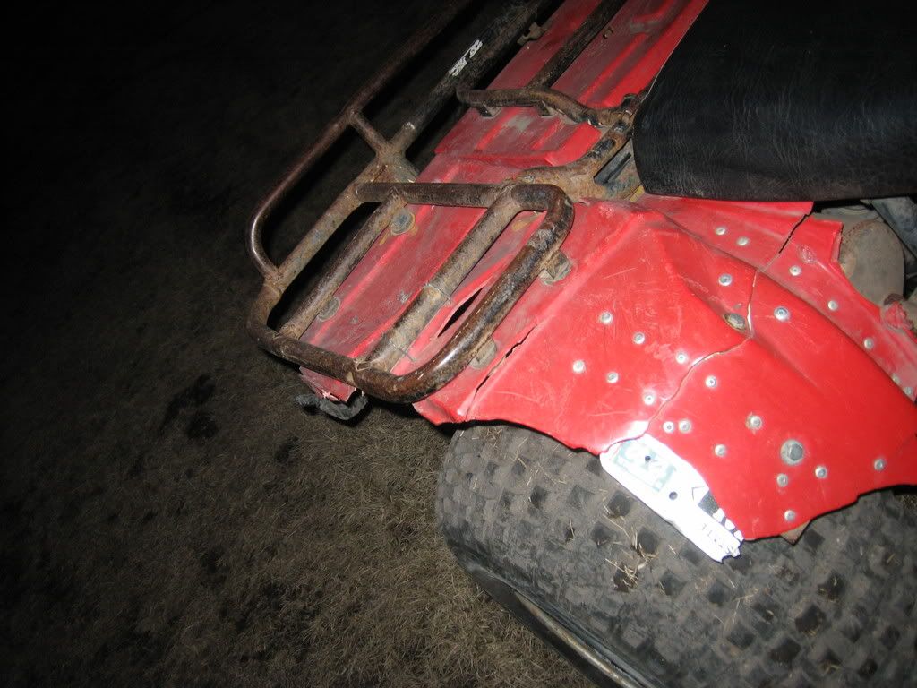

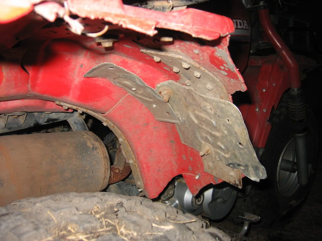

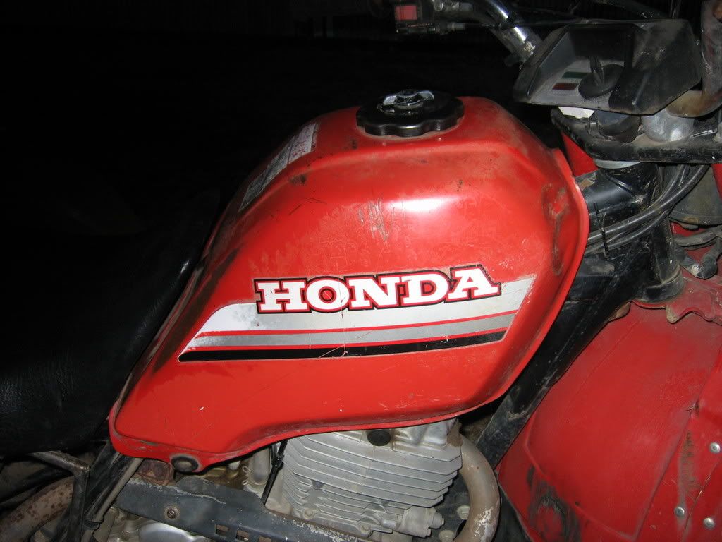

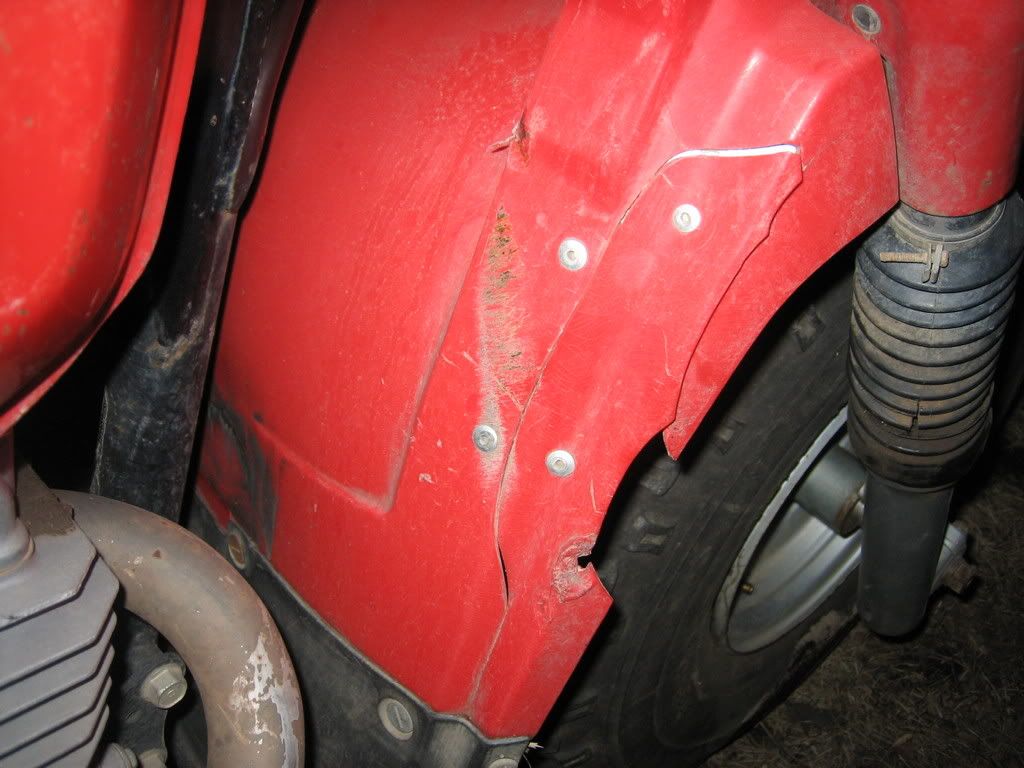

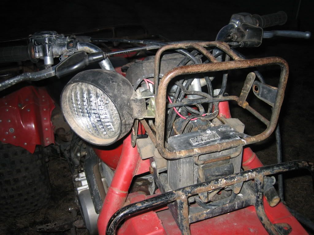

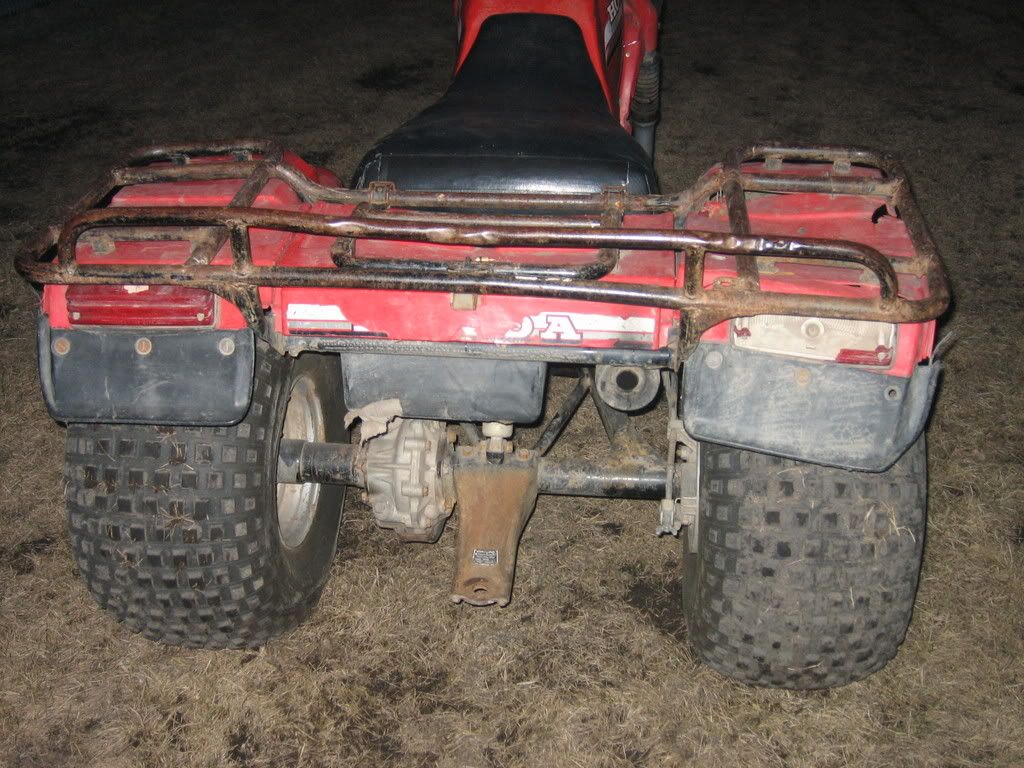

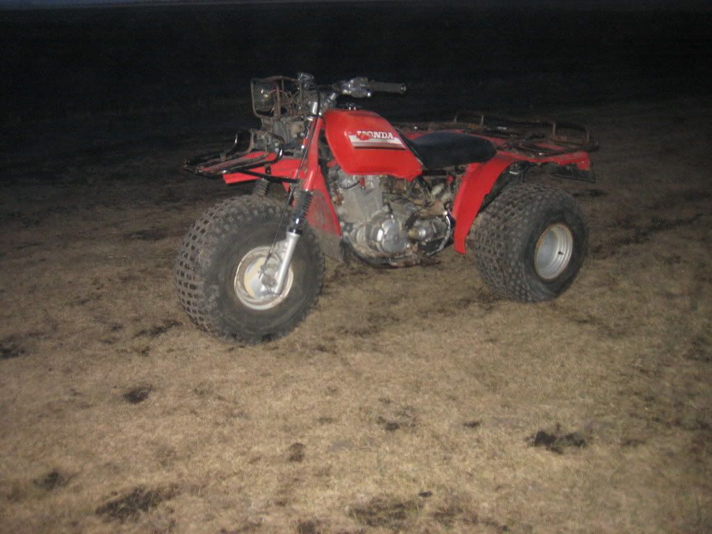

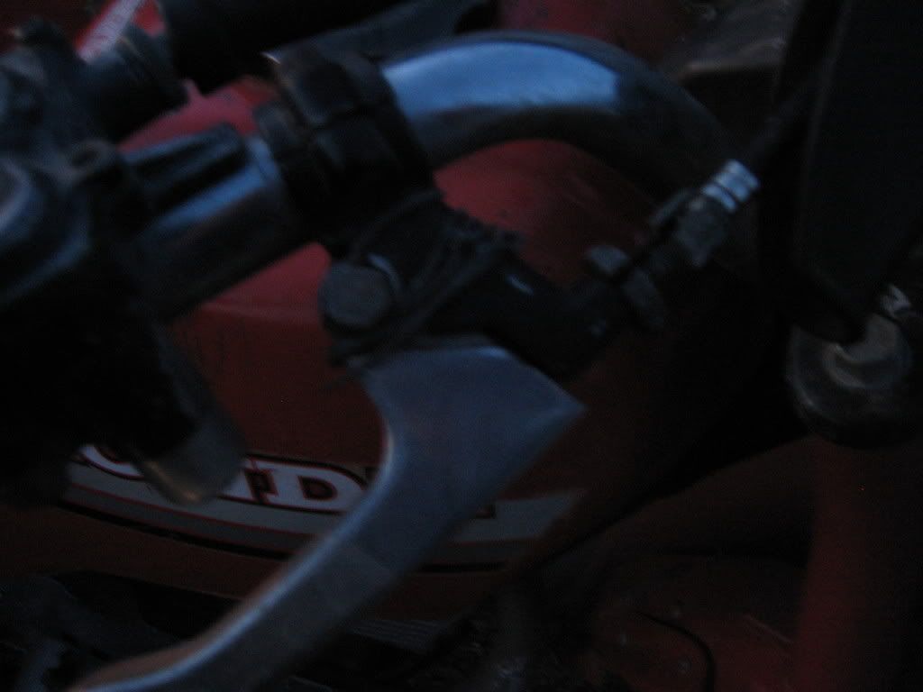

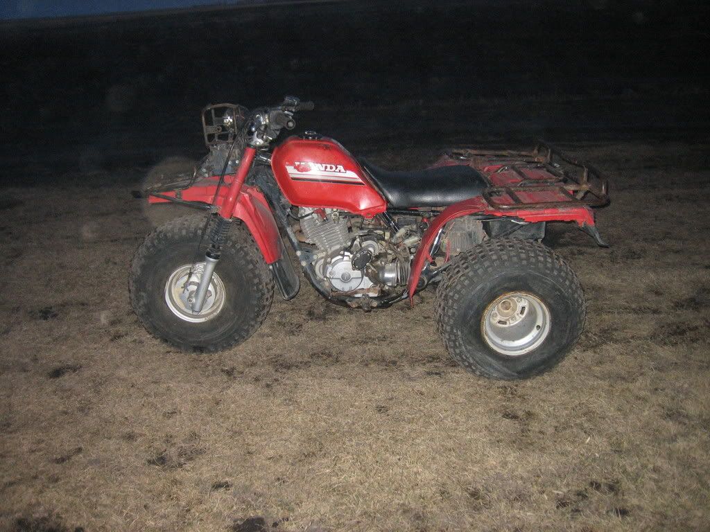

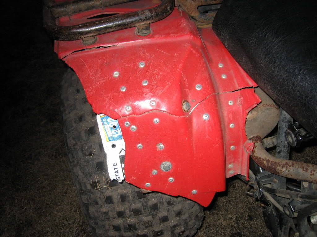

    Alright, Here are the pics.
    Heres the rear fender
    Dash
    Gas tank
    Shifter- Looks like the previous owner broke it off and welded a Yamaha one on?
    Broken brake lever
    Front Fender
    Inside rear fender
    Rear Fender
    Sweet headlight
    Front
    Front Left
    Left
    Rear
    Right side
  10. #40
    NE Arkansas
    2,344
    The motor is the best looking part on the trike. To be honest, I would cut ever corner possible, and get it running and just use it for a beater. You could get ALOT of $ tied up in it easily. Tires and tank not bad. Do all the cables and controls work? Seals and bearings tight? Looks like a good one to tinker with. RIDE RED!
    My Rags

    +1....keep it as a day to day rider. Lot of work & hassle to get it looking perty.
    Still a Big Red though! : )
    Good luck!
    Jeff
    '85 ATC 250ES Big Red

    As far as I know, all the cables and controls work, the front brake either has to be adjusted or it is shot. The rear brake works. I think all the seals and bearings are tight, I havent checked. The side covers are not on in the pictures, I have those, took them off for working on it.

    Got a brake lever mount yesterday, A front fender and a headlight should be coming soon.
