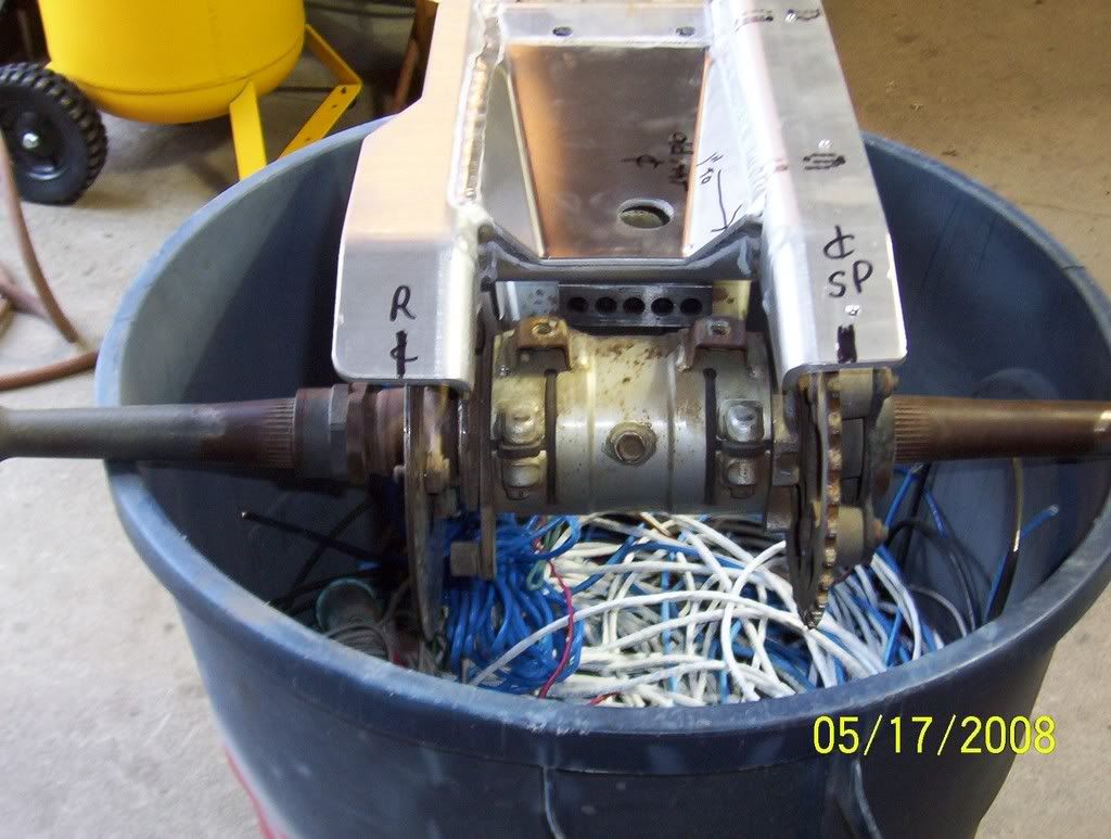

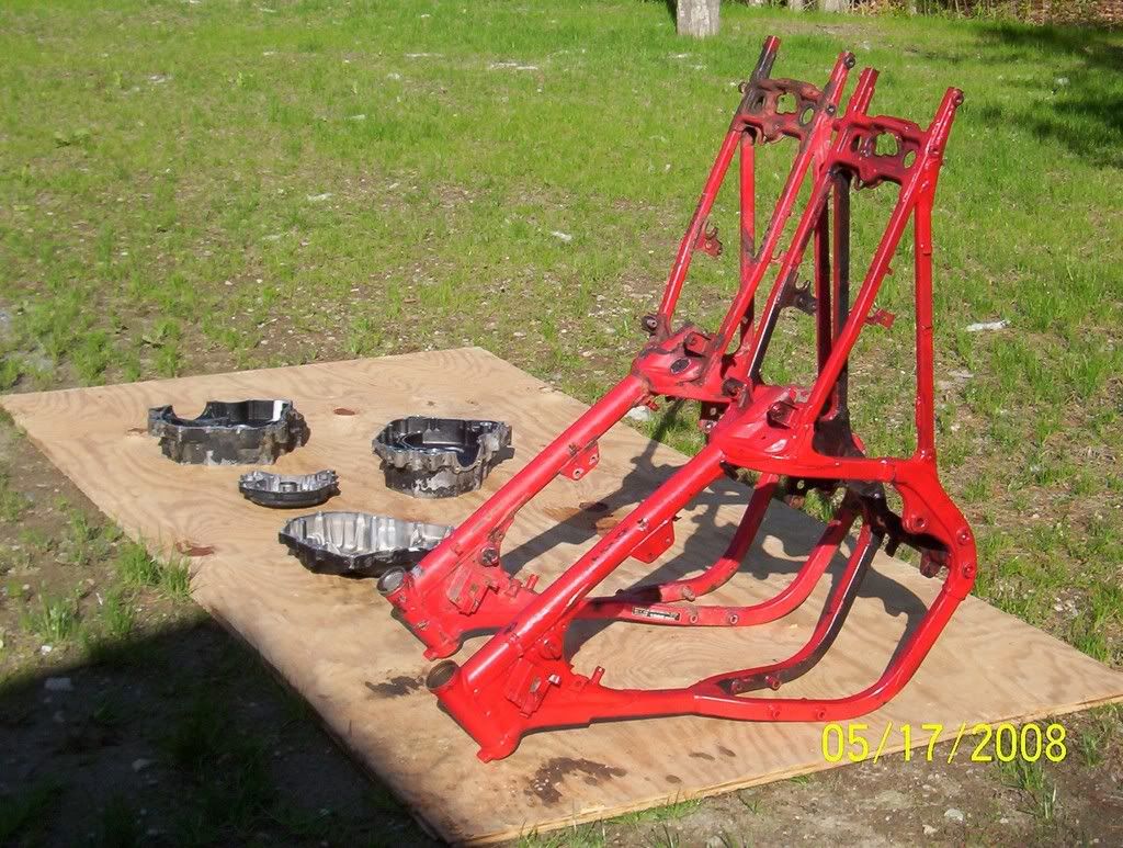

    The frames I have to pick from -

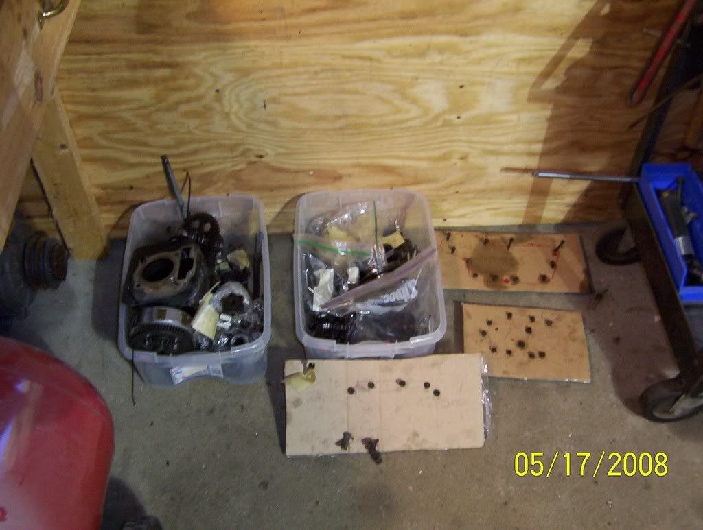

    The motor in pieces - Note how I figure out where each bolt goes back afterwards....

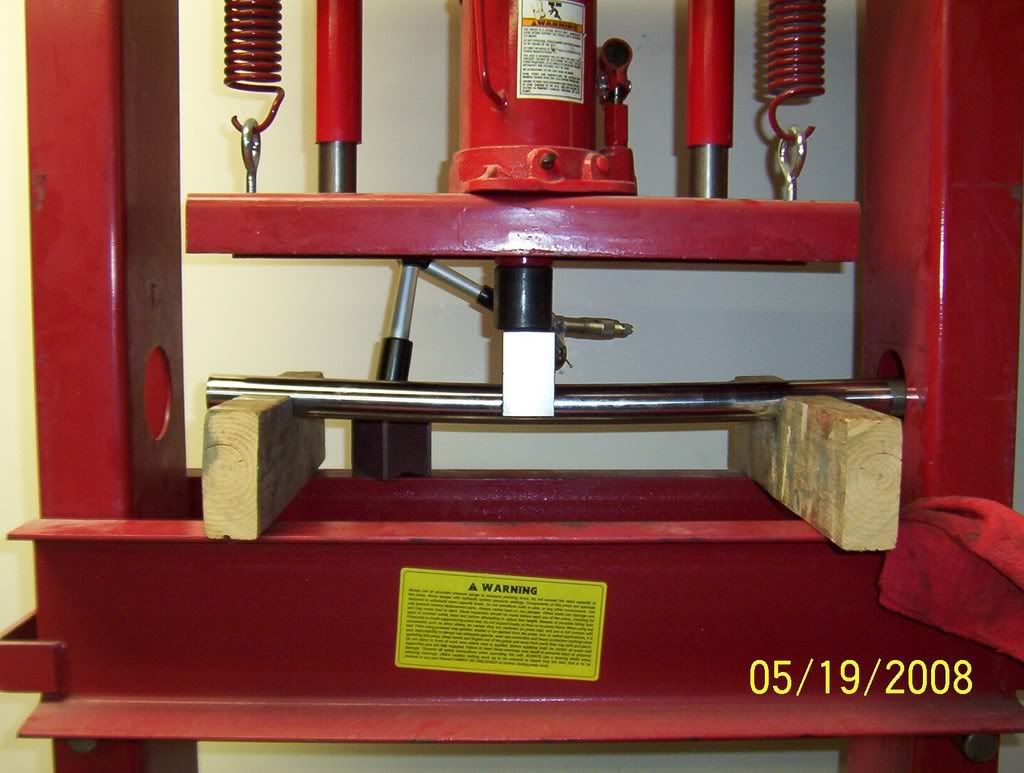

    Fork rebuild time!!

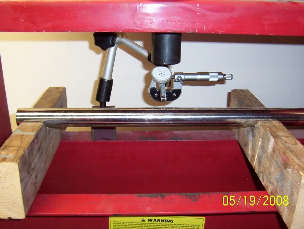

    Found the forks to be bent
    This is how far you have to go in the opposite direction to get them true again.... They were out .060 and after messing with them I got with .005.

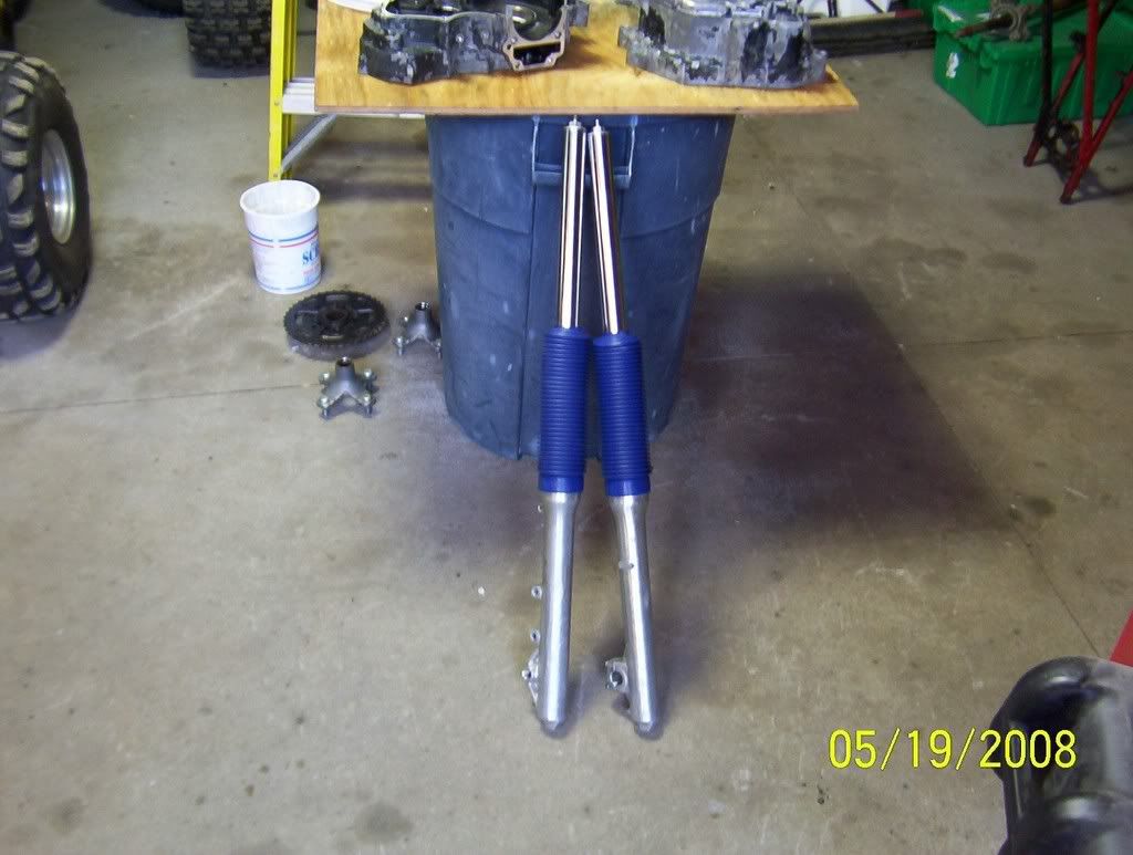

    And here they are done with new seals, damper piston rings and fork boots.

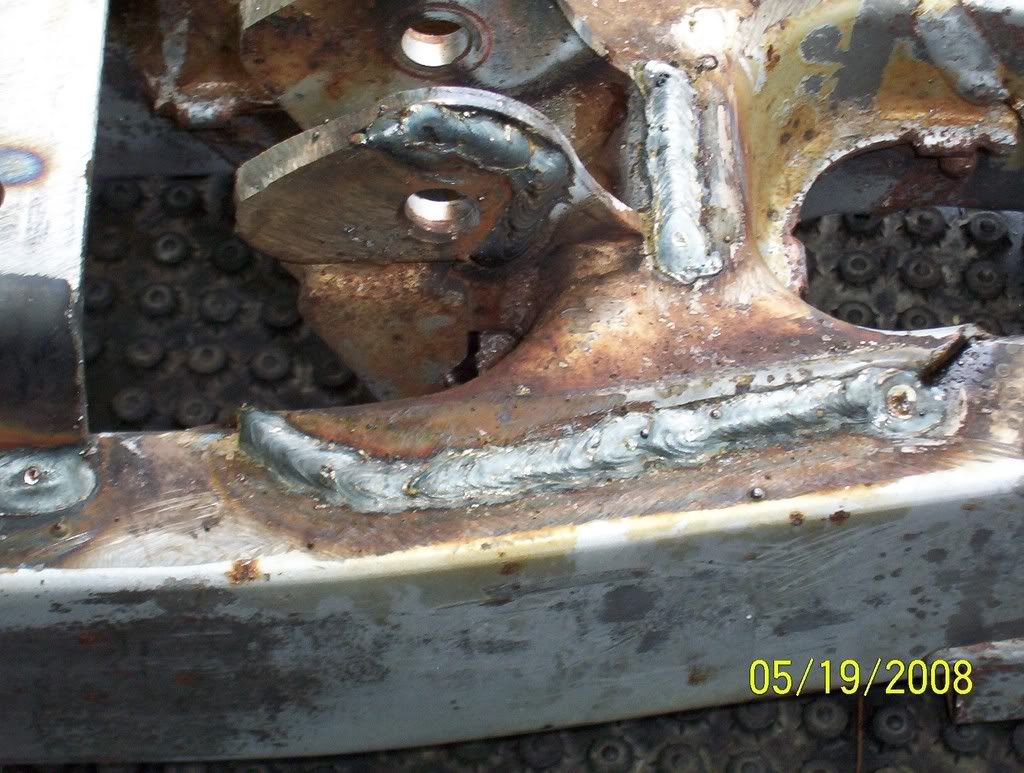

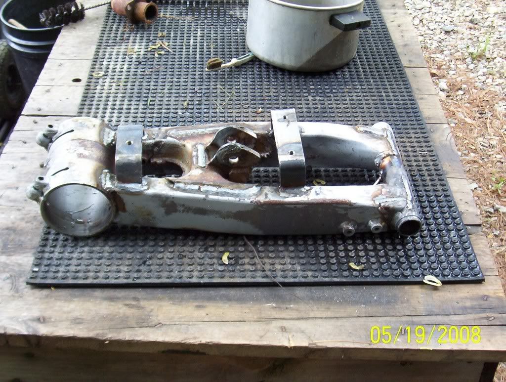

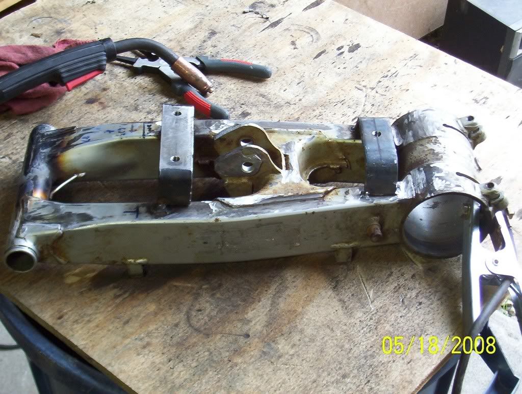

    Started work on removing the factory swinger skid mounts and fabricating 350X PRM skidplate mounts.
    The beginnings
    Here they are welded in place permanent
    I re welded ALL factory welds after grinding them off
    Tomorrow is another day

    NICE weldin' DC! Lovin' that plate... I can see that swinger in powder all ready? If you need help powdercoating let me know. Ship it out. I will lay some powder for ya!!!

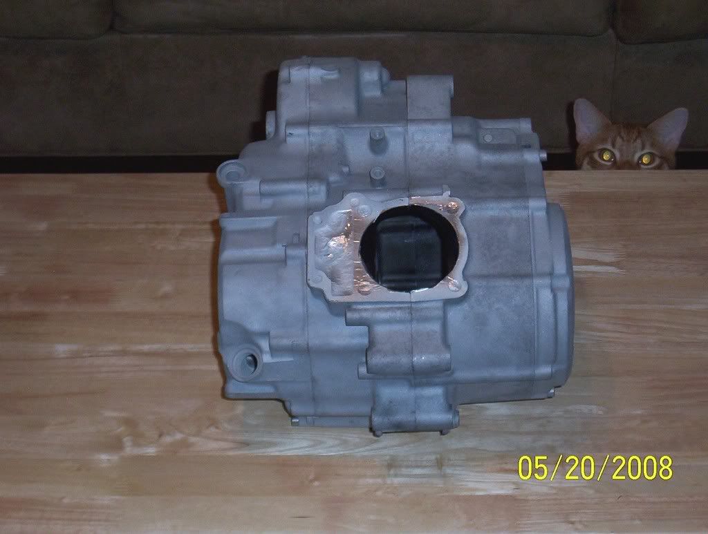

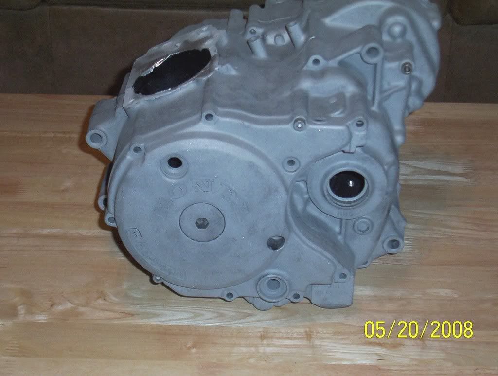

    Still managed to get the cases completely sandblasted. What you see here was a TON of work you don't see. When cases are prepped for powder, every single bearing and every part that isn't aluminum or could trap sandblast media is removed.
    Once the cases are clean, there are hours and hours of chasing threads, reaming dowel pin bores, stoning every gasket surface along with paint stripping and power washing numerous times.
    Right case
    Left case
    Front case
    I still have to sand out all the bad spots and pressure wash them again before I begin the gassing out process prior to PC.
    As you can see in the last cases picture, ALEX THE CAT is already eyeballing the sandblasted case as a place to take a leak or a dump
