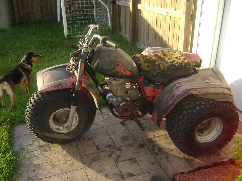

    this is what I started with. A rusty-ass 200m that I picked up for $40. I rebuilt the carb ($20), threw in a new spark plug ($2), and dug up a new pull starter for it ($20). The engine fired right up no problems. I'll throw the 200m in the 200x frame and then with about another $100 of bits I'll have a good running trike. It will be a grand total of under $400. Not too bad and a lot of fun working on it in the process.

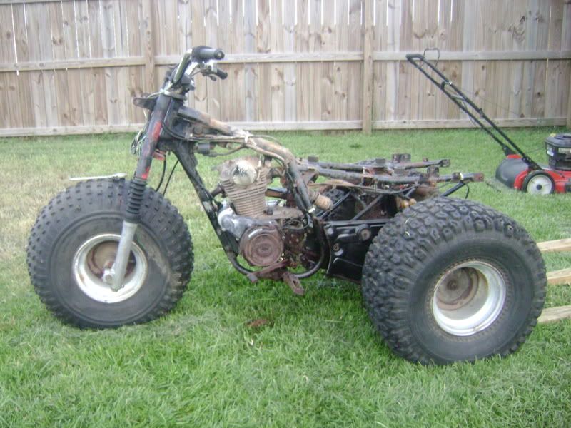

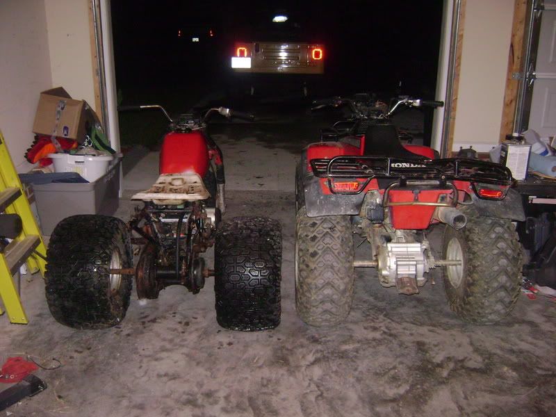

    and then here is the 200m sitting in my garage next to the trx200 project I picked up for $100 that only really needs a new cam chain and sprocket along with the hardware. I already got the chain and sprocket and just have to pick up the hardware tomorrow. That project is going to come out to under $200, so in the end I'll have both done for under $600. Then I'll just need to get a trailer, so I can haul them somewhere to ride and have some fun.

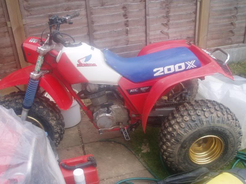

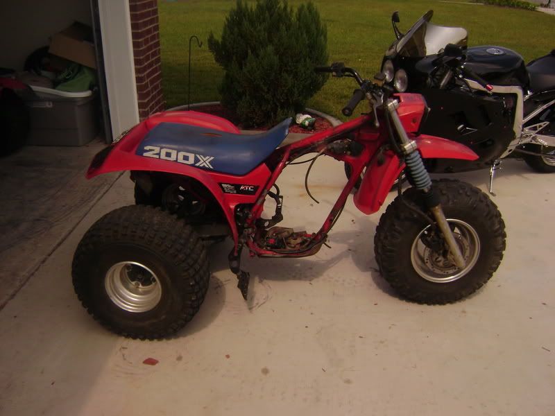

    I got the 200x roller delivered today. Now it's off to the shop to pick up my cam sprocket and some hardware for the trx 200.... here are some pics... enjoy...

    Thats lookin good. You'll need the 200x engine mounting plates (bottom front) and the carb intake boot. I've just done the same myself (200s motor) and its a brilliant machine, great for mud-plugging an hill climbs

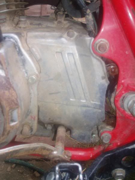

    the biggest bridge to cross, so to speak, is the brake lever, as the 200x one is mounted to the engine casing, i just welded the 200s lever to the swivel bracket thingy on the 200x frame. i'll post some pics in a bit. Also the gear lever i had to shorten by an inch an quarter. I'm not sure bout the 200m motor, but the shift shaft on the 200s motor is slightly too long and touches the footpeg braket, which was easily sorted by adding 2 bits of 1/4 inch of steel tube between the bracket an frame, with slightly longer bolts. there's a really good thread on here somewhere about one.

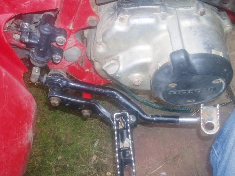

    Here's the pics.......
    Thats the trimmed down chainguard. its easy, nice an soft
    This is the spaced out footpeg bracket to clear the shiftshaft
    Here is the brake lever, its a bit tricky to get right, I'm a fabricator/welder so got all the tools, i had to cut a bit out of the end/thinner section, and add a piece into the thicker section, as to get the shape around the footrest

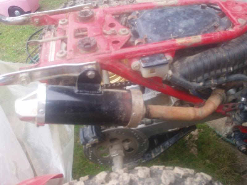

    I had a 200x headerpipe, just no mainsection, so with a pitbike endcan, a section of the wifes rotary washing line and a section of CG125 headerpipe, and i little welding, i created this. it survived trikefest

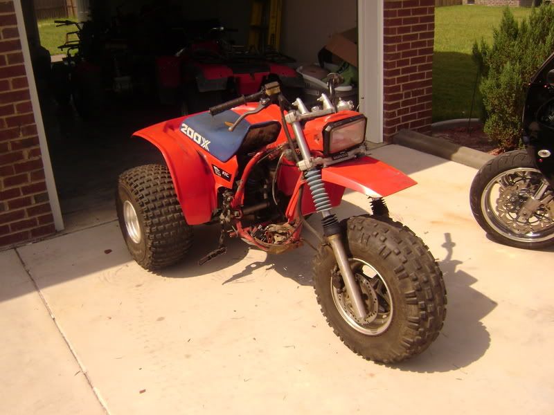

    This is the finished product. Not a beauty i know, but a very practical, mud plugging machine
