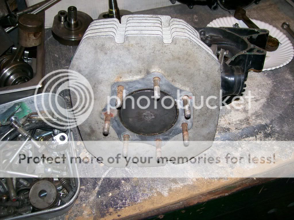

    Quote Originally Posted by Daddio View Post
    The piston comes right to the top of the cylinder like it should...
    I meant to ask this earlier....
    Are you just using a standard FL-350 piston during these mock-up exercises?
    This wasn't any special piston was it?

    Quote Originally Posted by Enginerd View Post
    It is the used wiseco piston that came with that cylinder.
    This is with half of the crank in with the piston and jug attached to check for fitment.
    How much did you have to enlarge the crank area to fit the 85 crank?
    Also, it has been mentioned that you may reduce the outside diameter of the 85 crankwheels by turning them on a lathe.
    Any negatives to this??
    only issue that i could think of is that you are going to have ZERO crankcase volume.......might want to look into that
    We are going to have material removed from the crank wheels for sure. This will be very easy because it is a cover made of much softer metal than the crank its self. The cases that are in these pictures are junk and are only for mock-up. We already thought about crankcase volume and when we do the cases that will be used on this build they will be machined to have the same clearance as the stock crank. We may not need to have the cases machined if we can have enough taken off of the crank wheels. That is the current plan but the Mugen isn't finished yet. It's taking up a lot of money right now.
