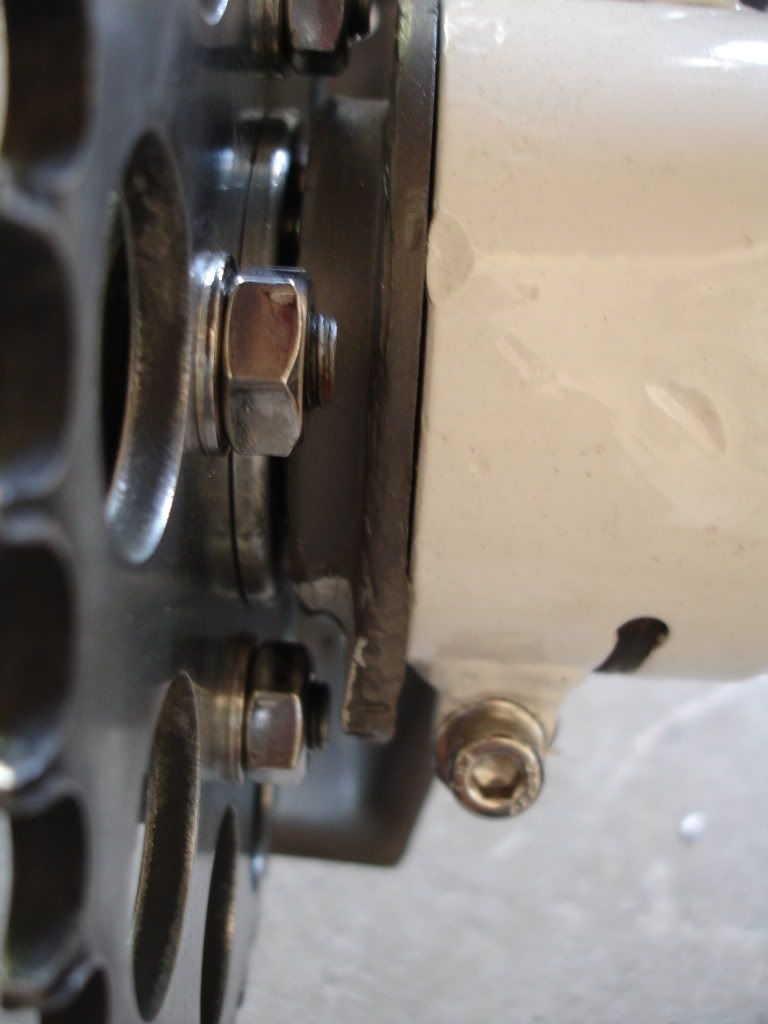

    for install, you need to midify your 2g carrier to fit the 1g sprocket hub bolts. like so:
