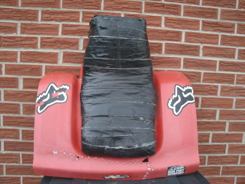

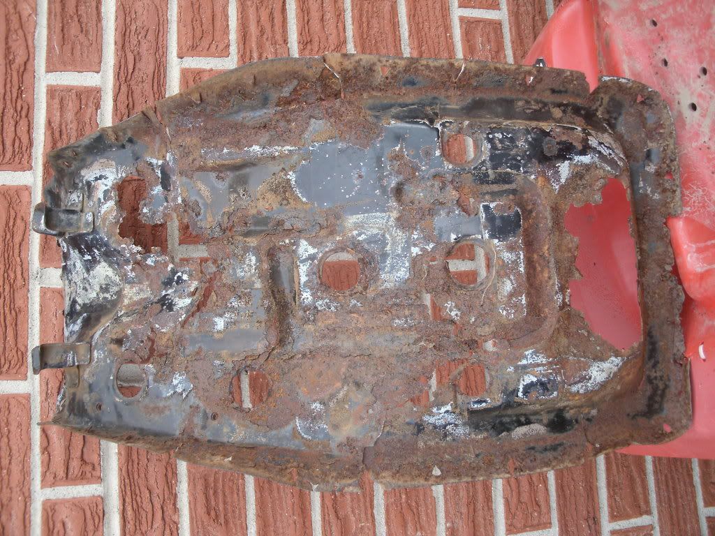

    i finally got off my and decided to build a pan for my 82 250R aka (ass crusher)
    old setup was used only for ice racing duct tape cover and 1 1/2 inches of foam... not so good on the trails.. plus its fugly

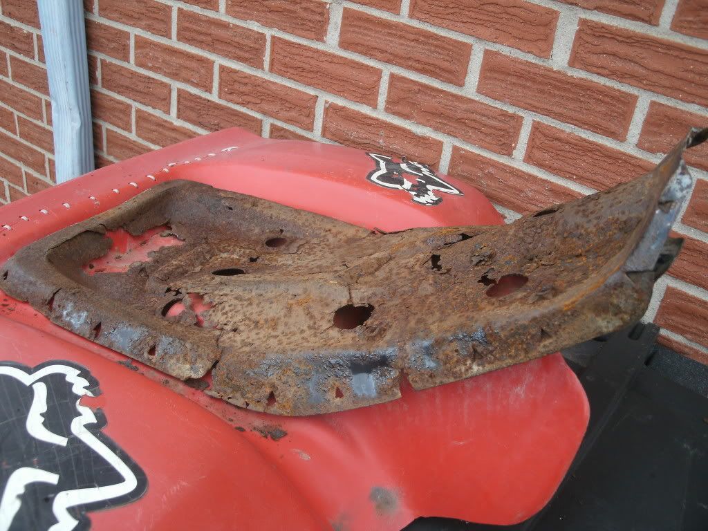

    man this pan was way past rotted out

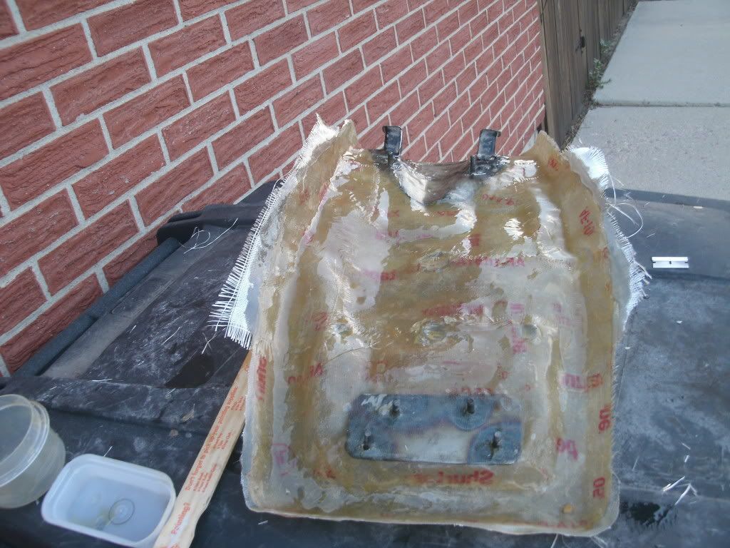

    picked up some supplies

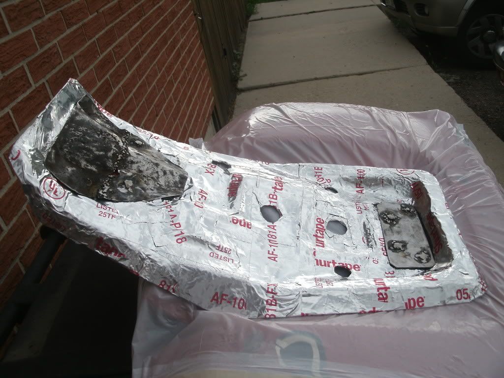

    made a new plate for the rear fender mount bracket... i cut off front mounts and re worked them a bit... then i shaped and wrapped the oldpan in foil and foil tape so the resin would release
    covered the fender with a trash bag.. and set the old pan on fender.. bolted the front and rear fender mounts on & started glassing

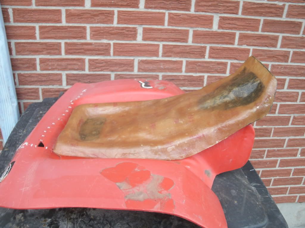

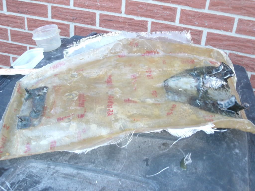

    heres the new pan once it was off the form and i started classing in several more layers for strength

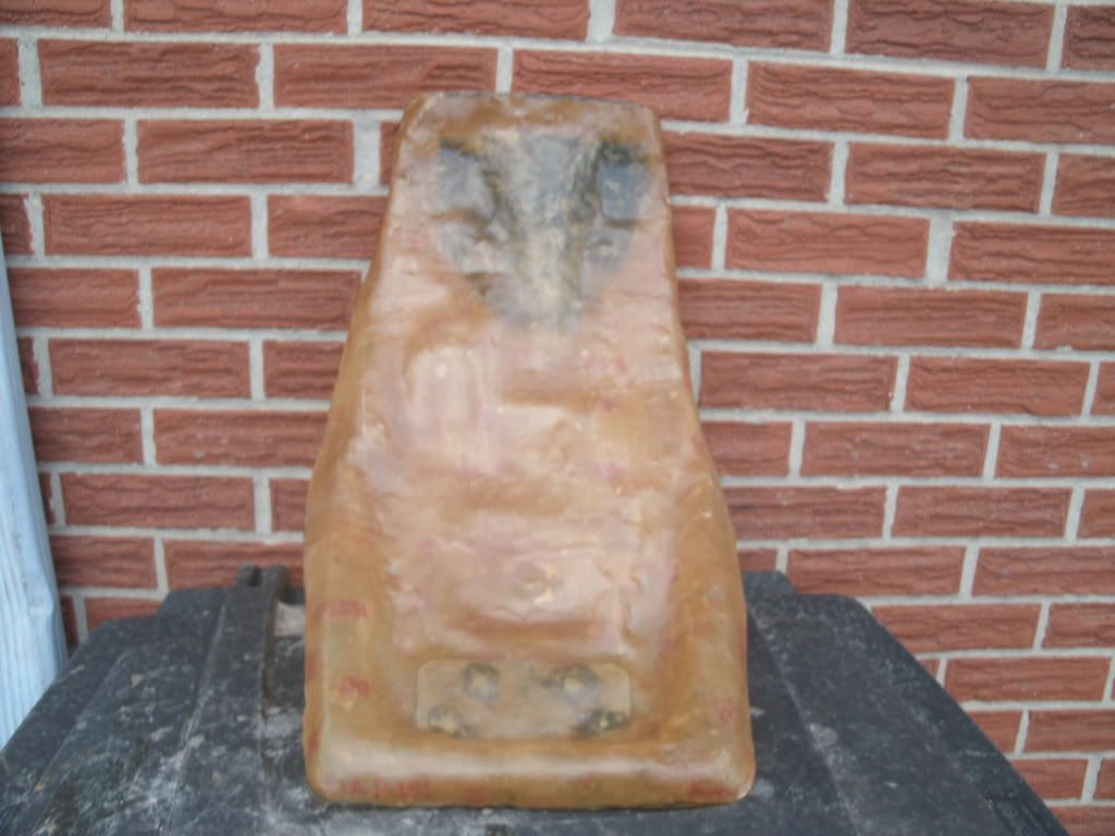

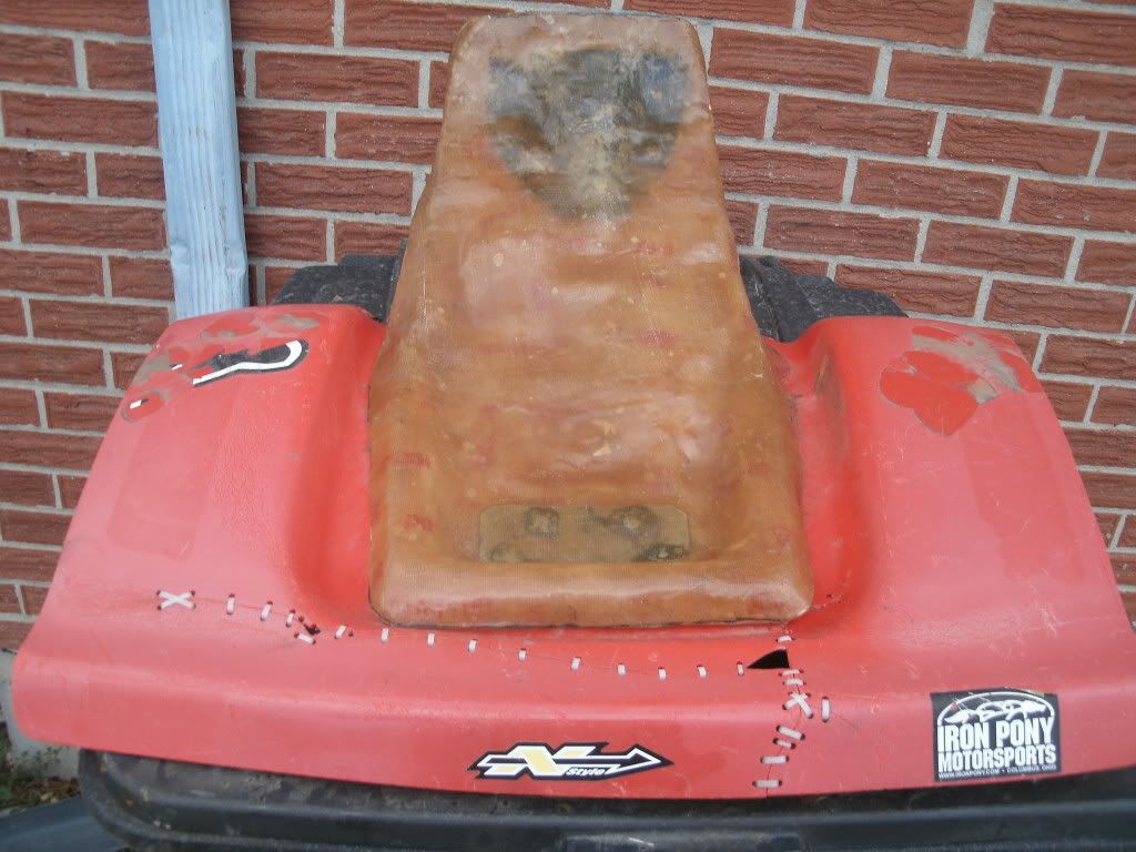

    heres the finished product

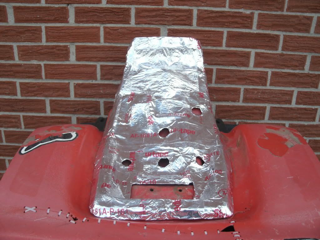

    here it is on the fender now im just waiting for my foam and cover to arrive
    i dont think it will win any beauty contests but it turned out dam good for a first timer ....

    what did you end up using to fasten the seat cover? the stock metal one had lil triangular hooks to secure the cover. just staples into the fiberglass under the foam?
