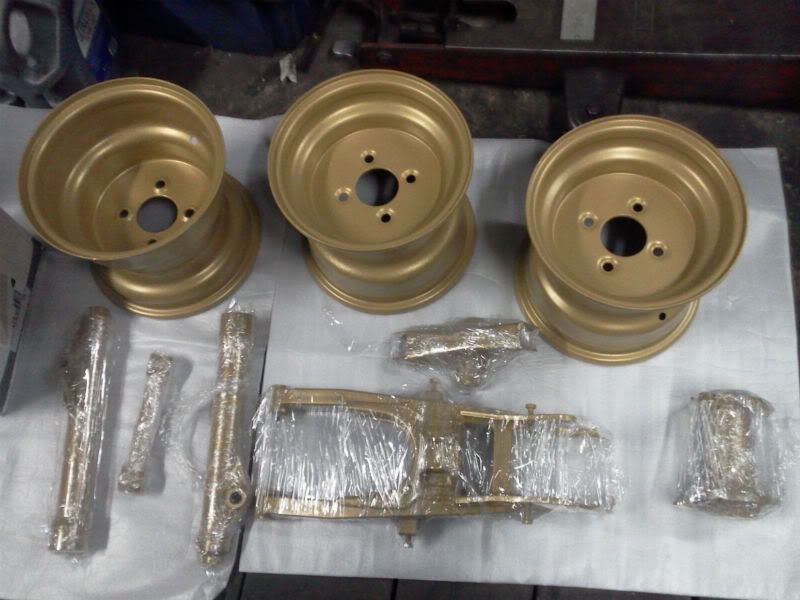

    I already got a color very similar to the original:
    But now I have some doubts with the correct color of the following parts:
    - rear axle
    - rear hubs
    - rear sprocket flange
    - disc plate holder
    I know that they are galvanized, but with gold or chrome finish? Any information about this parts will be gratefully appreciated, ideally some pictures of OEM Tecates.
  10. christph
    christph
    What color and name brand did you use on the gold parts? It looks very close to OEM but it is hard to tell unless you have the parts side by side. I have an 84 red Tecate that I have never restored because it is in such good condition. Regarding the parts you listed above, the axle is just a natural finish. The rear hubs appear to be zinc plated, they have a yellow tint. The rear sprocket flange is natural as well as the disc plate holder. I don't have picture of these specific parts but perhaps I could take some if you need more information.
