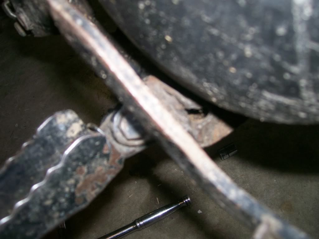

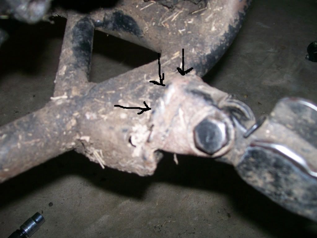

    We were taking apart Kendra's Tecate down to the bits and I started looking at my 84 so I decided to do a little work on it. I had a bent 84 foot peg so I put a set of 85 pegs on it. Last year at Waynoka the weld that holds the footpeg mount broke and the foot peg mount bent down. Got it welded. Anyways the other sides welds are gone except just at the top. Need to get that welded.
    Here is the side that was welded
    Here is the side that the weld is broken in the same spot

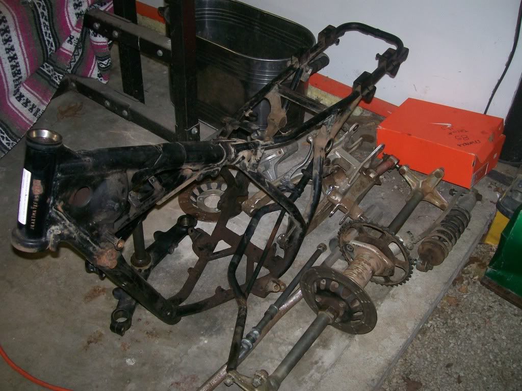

    Here is a pic of Kendra's parts waiting sandblasting and pink & white powdercoat. Looks like we may be painting some plastics. :-(
