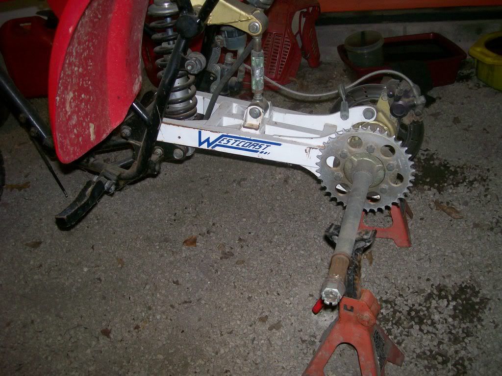

    Can anyone tell me where to locate the (2) West Coast stickers on my freshly powder coated swingarm! The swing arm is a plus (2).....I think a couple basic measurements will get me in the ball park! Picture would greatly help as well!

    I'll get you some measurements in a bit.

    1/16th of an inch from top edge of swingarm down to the top of the top line on both sides
    7/16th of an inch from bottom edge of swingarm to the bottom of the bottom line on both sides
    (left side) 4 7/16th from the center of the rear of the swingarm to the point on the top line
    (right side) 4 7/16th from the center of the rear of the swingarm to the top left hand tip of the W in westcoast
    These measurements are off of a +2 Westcoast swingarm that has never been painted or had new stickers put on it.
    Hope that helps.. :-)

    Thats perfect Doug.....thanks for taking the time!
