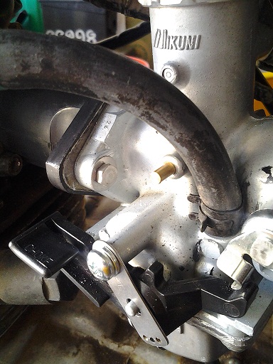

    Here's the thing...Mikuni made the carb for Yamaha...so it would bolt up perfectly to the the intake flange on the engine. Normal Mikuni carb flanges are just slightly smaller. I ordered my carb here: Mikuni 26mm carb
    It was actually pretty easy to install. It WILL mount up to the original flange, but the bolt holes don't perfectly match. Still, there IS enough room to use a skinnier bolt through them and bolt it on. The only other thing I had to do was shorten the intake hose from the airbox to the carb, because the new carb is bigger and will 'push' back the hose just a bit too much. Not a big deal, I cut it in the middle and put a thin piece of pvc inside to reconnect them.
    My YTM225DX runs great now, starts right up first time and is very strong.
