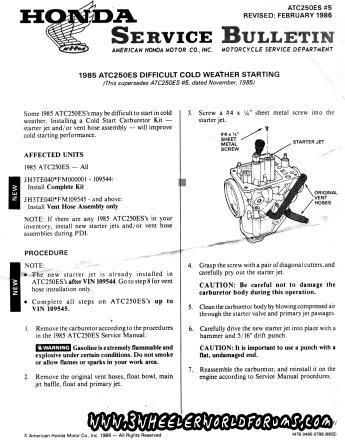

    ANYBODY HAVE A COPY THEY COULD SHARE FOR THE INSTALLTION OF THE COLD CARB SERVICE BULLETIN MOD. NOT SURE OF THE #.
    85 BIG RED, INSTALLING PT# 06161-HAO-305.
    ANY HELP WOULD BE GREAT...
    I'LL GET THIS BR RUNNING YET...

    thanks for the quick response...i tried a lot of dealers with no luck.
    i bought the bg in spring of 85, parked it in 86, and now just got to her.
    carb needed rebuild...and this mod. all else checks out OK! looking forward to making-up time.

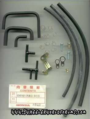

    Do you need one of these kits? They are hard to come by. I know of where to still get them. PM if you'd like to know.
