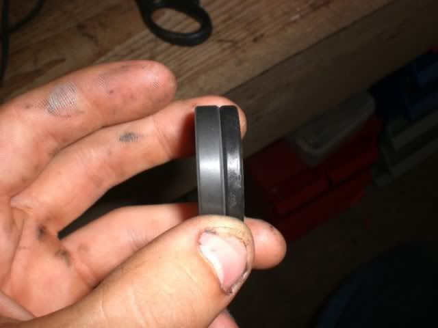

    Also, i think I've found the oil leak. The output shaft seal is leaking very bad and dripping constantly. It drips onto the shifter seal, so it sort of makes it look like the shifter seal is leaking too, which it may or may not. I'm going to order both seals and replace them, as I don't like my trikes leaking oil!

    Fixed the oil leak today. It was leaking out of the output shaft seal fairly quickly, creating a mess wherever I parked it. I'm guessing what happened is someone went to replace the seal and used the wrong one, and also punctured it at some point. The seal was not nearly as thick as the old one, and had a puncture all the way through it.
    New seal on the left, old on the right
    No more leaks! I also have a seal for the shifter shaft, but I don't think it's leaking. If it ever does, at least I'm prepared!
