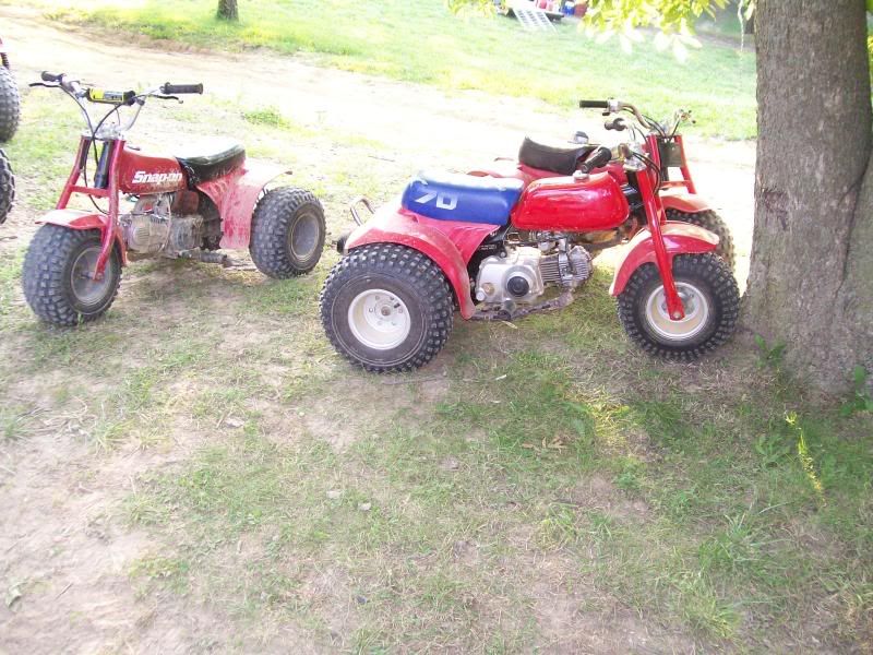

    When I stretched my frame I only went 2" and I split the difference by moving the tank back 1" in the front and because of the stretch I extended the bracket for the rear tank mount 1" forward to line up with the mount on the tank. The seat still touches the back of the tank. It worked out real well.
    Here is a pic of it at TF. You can see the gap in the front but the back looks fairly normal. Another bonus of stretching these is that you won't have to worry about the engine rubbing a hole in the front fender any more.
