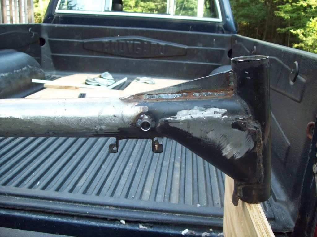

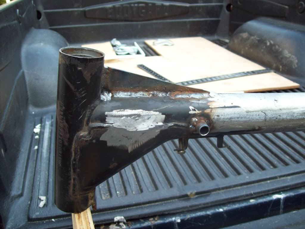

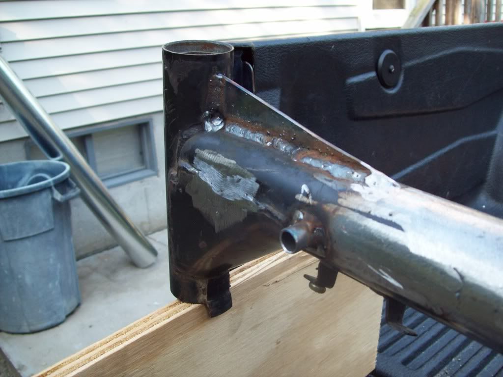

    The 3" ATC70 stretch is done:

    These aren't my best welds, I may have a regulator issue as I kept seeing the shield gas cut down and I just filled the bottle

    I'll be honest here, I think you've done a class A job of sleeving, joining, gusseting and welding the tube, but i will say the 'cleaning up' leaves a little to be desired. I'm thinking the grinder marks still look pretty rough and will probably show through most surface finishes (Paint system or Powder coat) Maybe just wants a 'dust up' with a zirconium flap wheel on a grinder or even a cutting disc used flat, thats how we finish hand rails at work..... But im sure your more that aware of how to finish it lovely......

    he is leaving it for me to clean up 100% before powder...hes trying to save me a few bucks by leaving the mindless stuff for me to do
