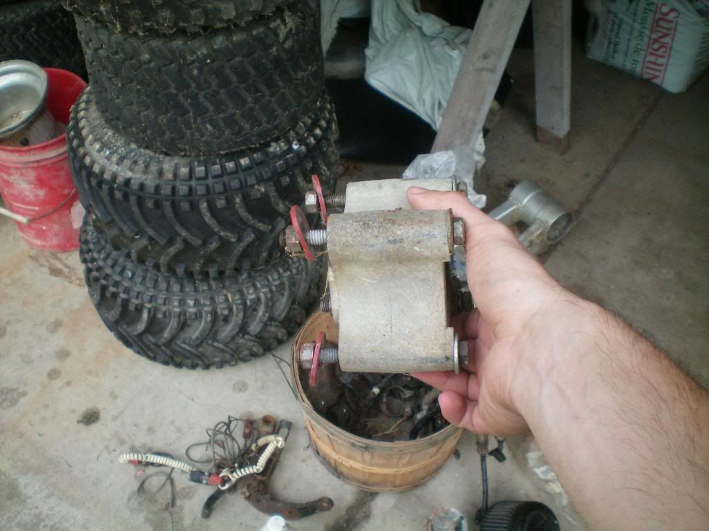

    Ok guys i have a carb issue. If you looked at the pics and saw the video i posted yesterday she wouldnt idle and was pissing fuel. I blew out the needle and seat and cleaned out the bottom of the carb and no more fuel leaks..DONE! (still have a shindy rebuilt kit on the way) Now i put it back togeather and she runs but still has the idling problem. It starts on choke and runs fast on choke but as the engine warms and i slowly bring the choke off the idle drops and when i get the choke completely off she dies. She caughs alot to. She will run on half choke but caughs the whole time. I adjusted the mixeture to 2.5 turns as per the manual. Any other ideas. Please watch the newest video i made. Im thinking she is lean Also here are some pics of some wheel spacers i found in the boxes of parts...
    http://www.youtube.com/user/rpmoverl.../0/fsYZwrpgp4I
    There are some kill switches, extra footpegs and rear brake set up + master cylinder, sprocket galore, extra oilcooler, extra cooler screen...
