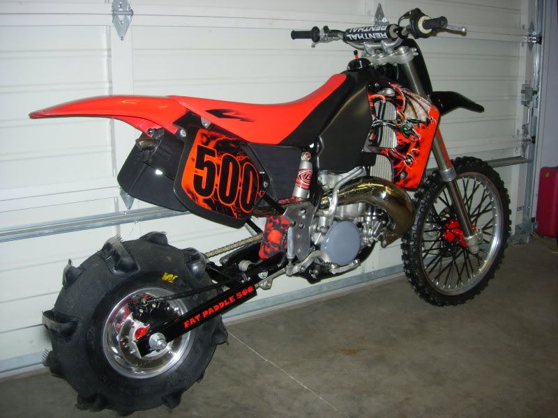

    I have a fat paddle kit to convert my 02 KX500 and want to have the fat tire on the front also. I want to buy a front end from TPC.

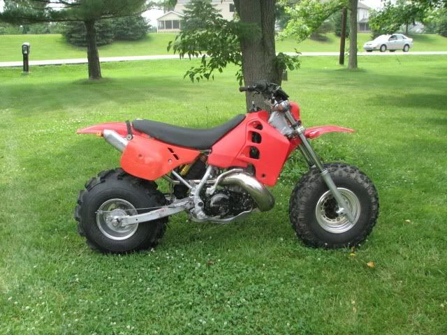

    Front end like this but modern.
