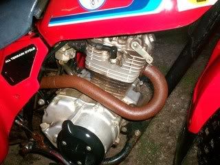

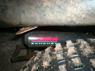

    I have one on a 83 200s. They are loud, it is as loud as my 200x with the DG pipe. It is nice that it runs between tire and frame instead of through the frame. http://i656.photobucket.com/albums/u...terwash011.jpg http://i656.photobucket.com/albums/u...terwash012.jpg

    how long did it take for the paint to burn off of it? and is there a big power increase over stock (top,mid or bottom?)

    Most of the factory finish was gone on mine. It was run maybe 1 hour after it was put on but it was covered in cow chit and parked in a pig barn. If the pipe you are buying is brand new the paint should last a few years. Mud that is left to cook on the pipe will take the paint off fast. If the pipe could use a coat of paint I have had very good results and long lasting( over 6 years and still perfect) with Rustoleom BBQ paint or a other high end heat paint. Flats last longer and stay nicer longer than the glossy finishes. If you rejet the carb if needed the pipe should look nice for a long time. Here is a pic of a 250r pipe that I redid with gloss. It had no rust but the finish was dull and missing alot of paint, came off a ice racer.

    The power increase is very noticable in the bottom and midrange, but so is the noise.
