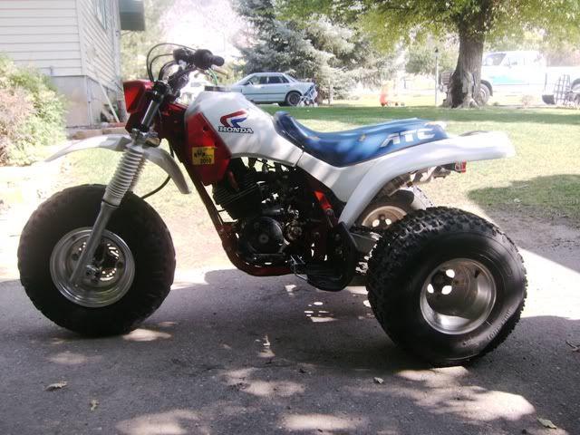

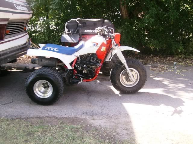

    Quote Originally Posted by eyecekold1 View Post
    I had an 86 200x and it had raptor heel guards on it and my feet never came off. It didn't take much work to get them to fit either.
    These picts are of his old bike (86 200x) which is now mine. The little time riding it I do like the heel gaurds, mainly cause this is kind of the trail and dune cruiser so my son likes to ride on the back, especially when we cruise the dunes at night. It keeps his feet safe. I wouldn't prefer them to just having the pegs if it was a serious rider, standing with the gaugrds just isn't the same imo.
    http://i291.photobucket.com/albums/ll292/sagep11/IMAG0069-1.jpg

    ^ TY sir! that looks like the ticket!!! much easier to deal with looks like!

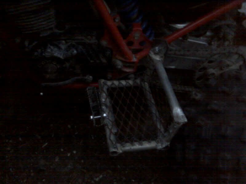

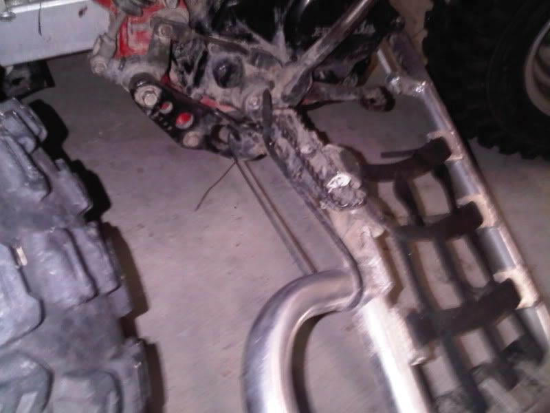

    banshee nerfs wont work trust me when u kick it over you kick them and they mess up
    i just had my brother make me some ghetto ones
    i will get some better pics up when they are painted and done
