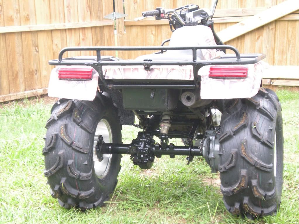

    I have 27 inch zillas on the rear of mine. I love them! I feel I could maybe fit 29 or 30's with the 1.5 lift I put on it. I bet if you adjusted your shock witth the higher/stiffer setting they would fit with minor rubbing. One way to find out. Mount them on there.

    I would go with spacers if you are going up that much in tire size. Mine are 1.5 inches.
