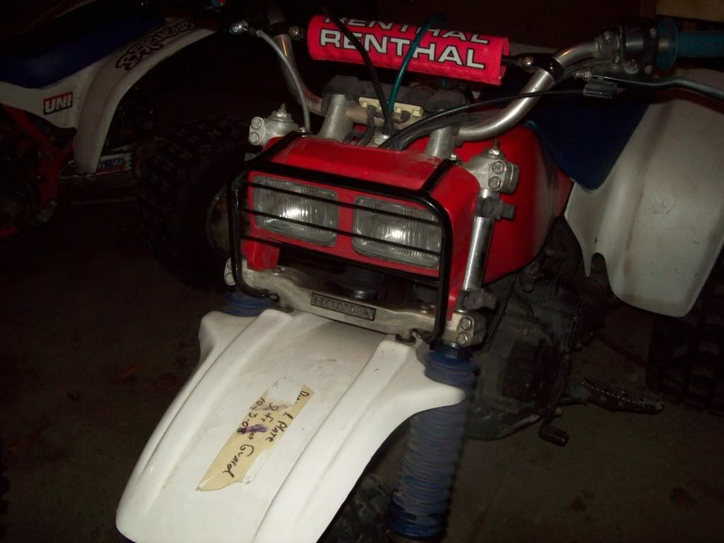

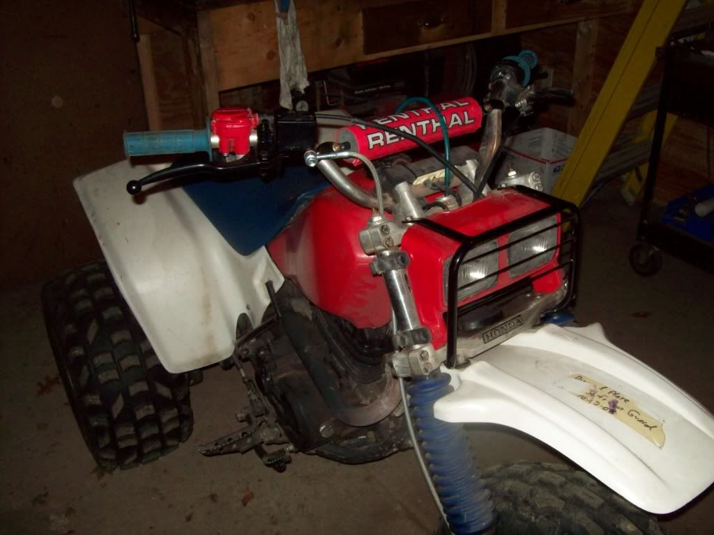

    thanks for all the info i am in the middle of the swap now i here are some pics of where i am at so far...the front is switched over and the old stop is removed i need to do a little changing on my stop but i am going to try to replicate the factory x stop(cause i dont have anything better to do haha).. i have run into one problem so far afer switching i noticed that the axle for the 200x is either not the right one or something is really really wrong..it doesnt seem to be anywhere near long enough it is only about halfway in the fork on both sides.. going to big spechts house tom. night to do some parts checking..all the more info is more then appreciated after swap is done its plastic and light hunting time

    after finding out the the forks were for sure bent went to spechts warehouse haha and found a straight set for mockup anyone have a straight pair of forks they need rid of?? next step getting the steering stop on and adjusted up and finding a 350x headlight

    That's the standard bend, right below the lower triple! One of mine was bent, nothing a 40 ton press and some V blocks can't handle. It's amazing how far past center you actually have to take the tube to get it straight again. Someone here has taken them to an exhaust shop and had them tweak it in the tubing bender, might only cost you a 12 pack of bubbly!
    Looking good.

    NICE I give you lots of credit for trying to duplicate the stop, and it looks real good!!
