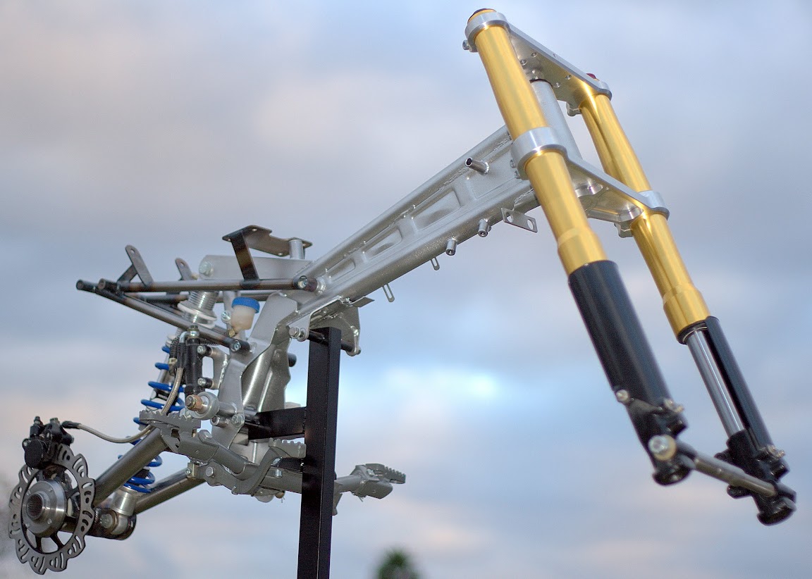

    best bet is to start with a pit bike frame,,, then you already have steering head angle and rear suspension attachment points,,, all you have to do is build mounts for seat and tank... study this pit bike frame,,, see how easy its converted this is how i will do my next 70 conversion

    ^ Wow, and that addresses the future frontend too......
    Thank you for the picture and I'll shoot you a PM
    I wonder how difficult they are to find like THAT, orm if it's worth buying one complete and selling off the useless stuff......
    THANKS for sharing

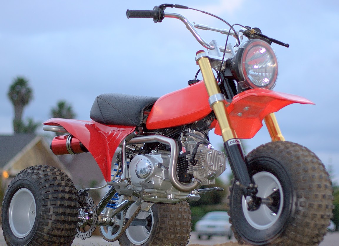

    That frame shown and that trike shown are for sale. With that frame all you have to do is add wheels, tires, tank and fendes and engine and wiring and you are riding. I'm presonally not that ingenious. I know of others who are. Blue27 has triples if you are interested. You may want to try and go with quad parts and design around them. Used parts nowadays can be a gamble. Some parts of the country seem better than others to source used parts. Either way, have fun, take pictures, keep me posted. You know I dig this kind of stuff!

    the picture is a ready to bolt on 70... it is built by Ron Baker of PEP .. as it sets in the picture,, $1995.... but you can see the pit bike frame ,, you can see the custom subframe with seat mounts ,, and the swinger,,, so it gives you an idea what is involved in a conversion,,, not really alot of work,,, and the koolness factor is 63 points....

    Creel and Kasey that is pretty sweet set up!! Just look's a little funky in the rear height stance??? Kasey I like your other suspended 70 better!! Looks like the mini "R"!!! Don' get me wrong , I would build one of those in a minute but the stance is all wrong for me, just my 2 cents!! Ahh.....my dream 70 Kasey!! That bike is burned in my mind...............what a work of art!! Here it is Someday my friends!!
