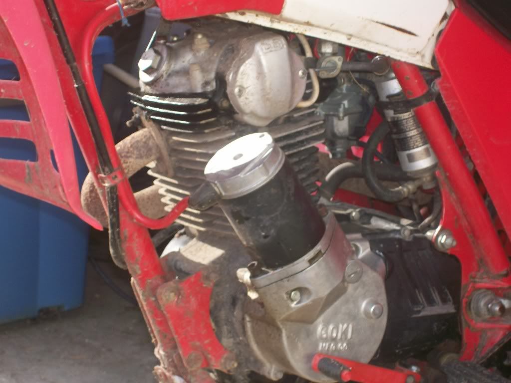

    They were discontinued. Goki has no parts for the 200X anymore. Your best bet would be the classifieds or Ebay. Here is a picture of what they look like. I sold this one off my 200X.

    That Goki kit is for the smaller 200's NOT the 200X. The Goki starter on my 200X worked like a charm. It just wasn't needed for what the trike was to be used for.
    I sold mine for cheap and the box got a hole tore in it (thanks UPS) and the flywheel with the ring gear attached was a no show at the buyers house. I called everyone Goki ever sold through. Even tried seeing if the 200 ring gear would work, it wouldn't.
