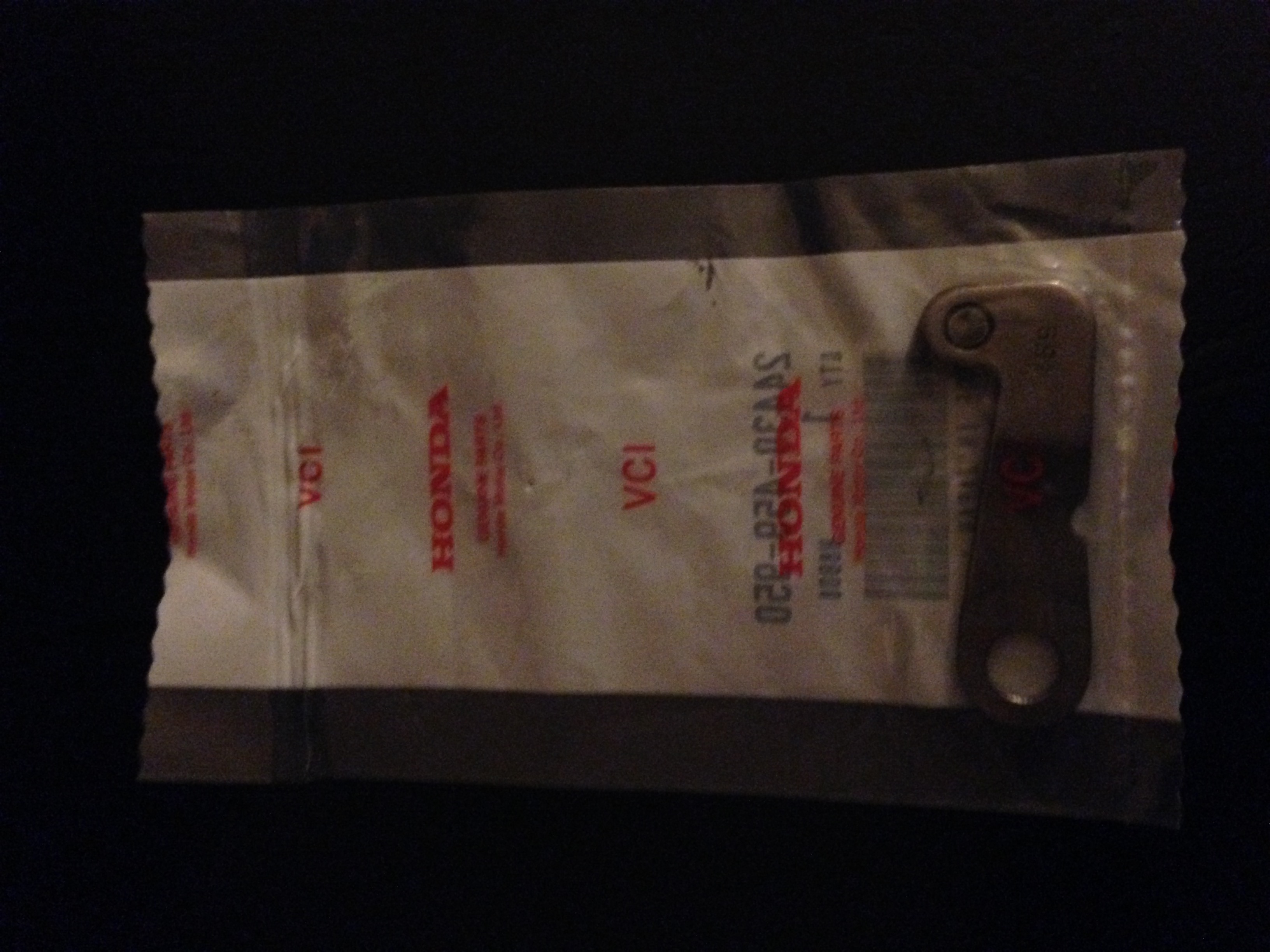

    Next pics are from me when I replaced my shift drum stopper arm.
    Broken:
    New part, and what it's supposed to look like:

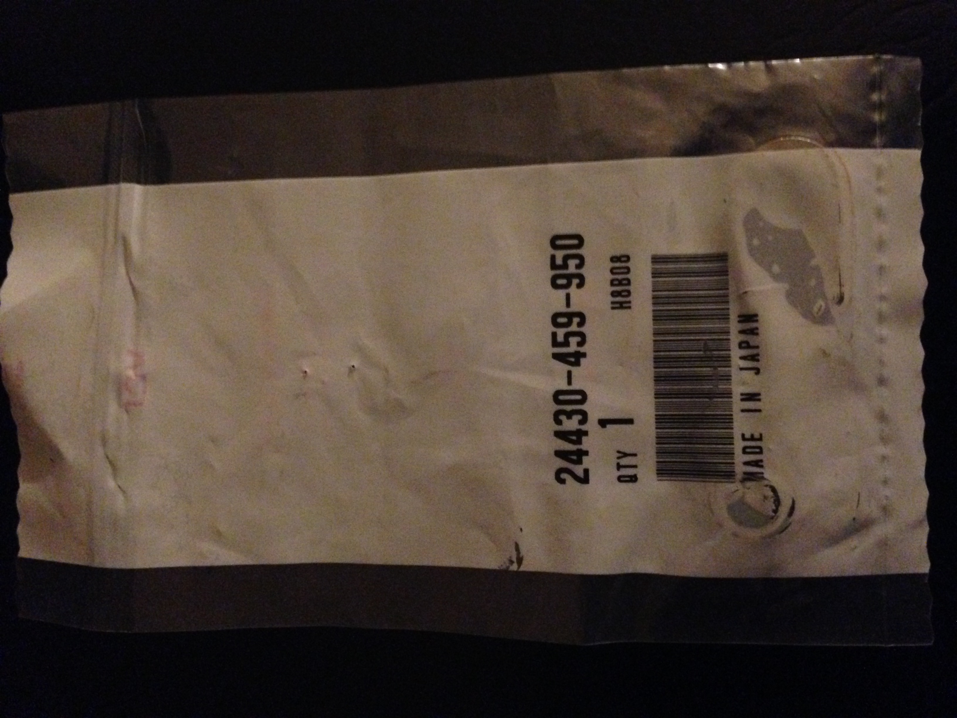

    Shift drum stopper arm part number:
