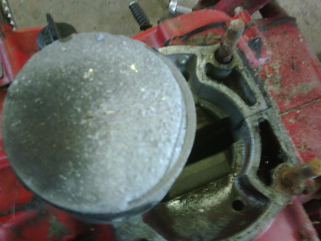

    Took the jug off tonight and pulled apart the carb a bit...just like some suggested - Small jet was clogged..also it was a 48, I think stock should be a 50? Anyway - getting a carb kit to make sure this thing is right. The top of the piston is actually burned off on the exhaust side! Also - I can't get the pin out of the piston...I got both clips out but the one on the side that got hot was a real pain...Is there a good way to get this thing out w/o damaging the rod or crank?

    OK - got the pin out of the piston by using a socket and a c clamp...but I noticed small metal shavings and pieces on the crank and some in the oil as I spin the the crank around...is there any way to clean this stuff out without having to tear into the bottom end? I'm sure they are peices of piston and clylinder wall that came apart...
