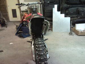

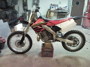

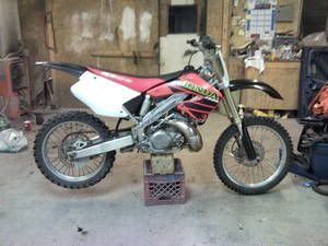

    Well been fighting with a buddy of mine about getting a bike he can drive. He is in school and has a small child so he don't have much timefor nothing. He had a banshee he didnh have time to drive. Now he traded his shee for this cr and 1800$. He wants a new bike with no running on it for 2-4thousand. Yeah Right. For a 450r. So I showed him the tpc 450 and now he went from hateing the trikes to loveing them. So when he found out how much it cost to have one built he bailed. So now he wants to make a 250r out of his cr. But he dont want to use out dated 250r parts. he will get everything machined. He plans on using the aluminum frame and a 450 swinger. And he seen someone's build on here and thinks it will go together nic ly. I told him to put a post up of his build to ask a few questions. But hes a rocket scientist and dosent need answeres here. he know them all. Like will a 4504 swinger bolt righ up to his frame. he thinks yes. Going to get a custom machine front hub" cause the 250r is too old"
    Here is his bike now.

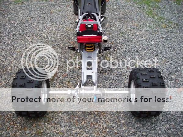

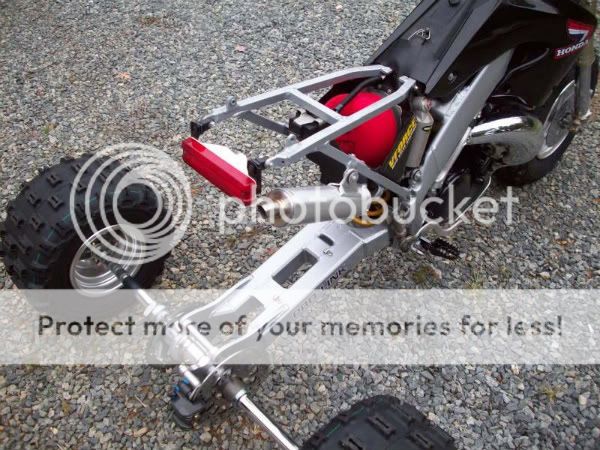

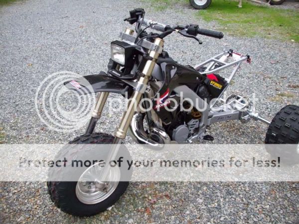

    Here's a conversion I done back in 2007 on a 2001 model CR250R using SpeedBump's old parts. These photos are about half way through the build process but you can get the idea.
    The bike I started with was in great shape and had several goodies on it!
    As far as the build goes... It honestly wasn't that hard to convert it, especially with the two hard parts out of the way, swingarm and triples. I spent A LOT, changed a lot, and added a few items to make it more trail rideable... A flywheel weight helped out tremendously as did a lighting stator for night time use.
    In the end though I won't lie... I did run into a couple of problems just as SpeedBump did with his conversion. The major one being heavy steering due to the rake angle and frame geometry. Other than that the only other major downfall with this conversion is the CR engines use a 5 speed tranny and with a built engine like this one had you really need another gear!
    By the way... I do have these conversion parts on a shelf and will sell them if anyone is interested. Just PM me.
