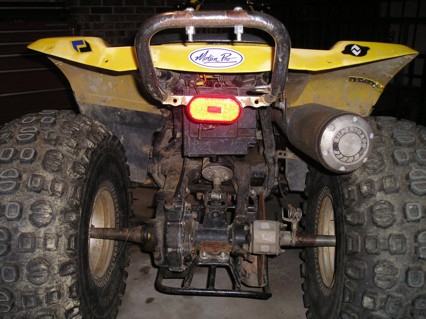

    I bought a used supetrapp arrestor from e-bay and mounted it on my dg with long sheetrock screws.
    [IMG][/IMG]
