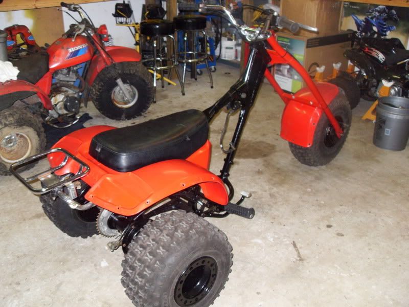

    Just please dont get upset that I monsterfied a 185s. This is a project of mine that i started and completed in about 3 weeks. It started life as a 1982 atc185s. it was non running when I bought it. heres some pics.
    I didnt get pics of the before any mod so I stated here after we cut the forks and were looking at how it is going to look.
    gettin the feel for it. my buddy brandon

    did a frame extension with internal tubes. then I covered it in sheet metal to kinda keep it looking stock.

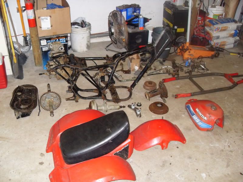

    then the tear down!
    palmbay,Fl
    56
    after hours of sanding and painting . the build up.

    Neat looking project,looks like you have alot of time in it.Can I ask a question about how you extened the frontend.Did you put a sleeve in the tubes where you extended them?It didn't look like it to me,no plug welds holding them.If you didn't you might be heading for trouble,could break apart.Plus the work on the neck should have been plated on the outside.There will be alot of stress there.One more thing I didn't see a gas bottle on your welder.The gas-less wire isn't the best thing to use on a job like this.I hope you don't get mad but wouldn't want you to get hurt.
    palmbay,Fl
    56
    I thought about that before the build and yes, i bought steel tube that ran inside. I would not trust my life on some welds. rest assured I dont want to get hurt either. most of the welds i smoothed out with bondo before I painted it. theres only four visible welds on the forks.
