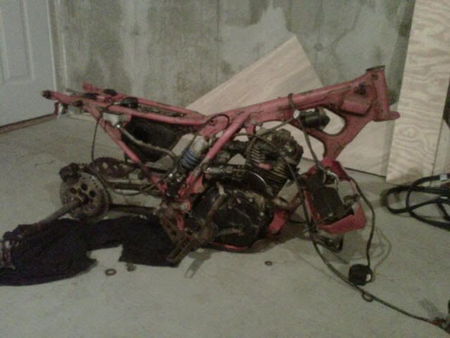

    What year is my 200x?
    I just picked this up for $100.
    Also came with front forks, tire was nice looking.....except for the cut through it. I believe it was some oddball size, not the same tire that I have on all my other ATC's.
    I tried reading the vin, but it's pretty much illegible. My best guess would be:
    jh3tb052x1k402998
    Running it through the vin decoder, it comes back as: Decoding Results: Unknown Year ATC 200x
    I'm going to start getting parts for it, but I need to know what year it is as apparently the 200X parts are different for earlier and later models.
    I'll probably put my 200s engine in it. It turns over and has spark, but it seems to have low compression. This is strictly a guess on the basis of me being able to push the kick starter with very little force (with the plug in.)

    83-85 200x hense the round frame, all 83-85 parts interchange and an autox is a good idea

    1985, it has a square swinger and blue shock.

    1985 based on blue shock

    I'm not sure, but I think it might be missing some parts!

    definitely 85

    something's wrong about the 10th digit of the VIN. That digit indicates the year. Swingers and shock boots can be changed.

    That one was very hard to read. I basically can see a very small part of it.
    Looking up year codes and comparing with the VIN decoder, if I change my tenth digit of the VIN to 'F', then it says 85 atc200x.
    I can't see enough to say whether or not for sure it is an 'F', but that is the year code for 1985.
