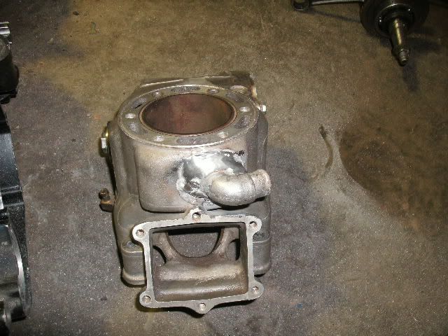

    Well with some parts laying around i decided to put some things together.

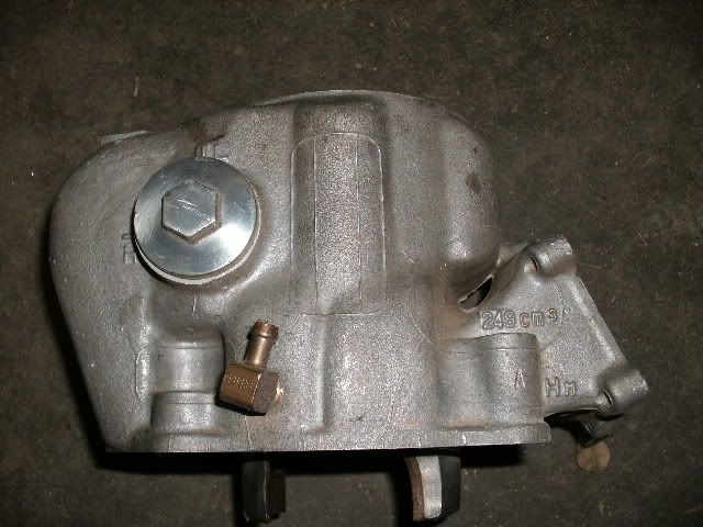

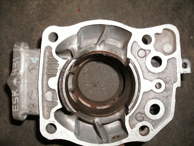

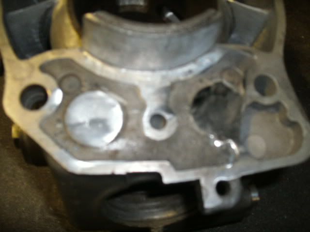

    This 01 cr250 cylinder is ported by ESR with a steel sleve and powervalve blockoffs. Several things i had to modify, First off the water inlet comes up under the exhaust through the bottomend on the cr. So i had those inlets welded up, and had a inlet spout welded on. These cylinders (with cr bottomend) are known to put out 65ish hp in micro sprints, and shifter karts.
    BEFORE

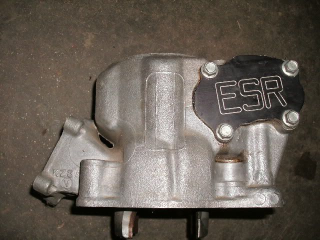

    AFTER
    The welding isnt perfect. I didnt do it because, well i dont have the equipment to do so.

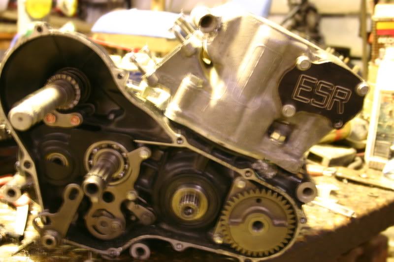

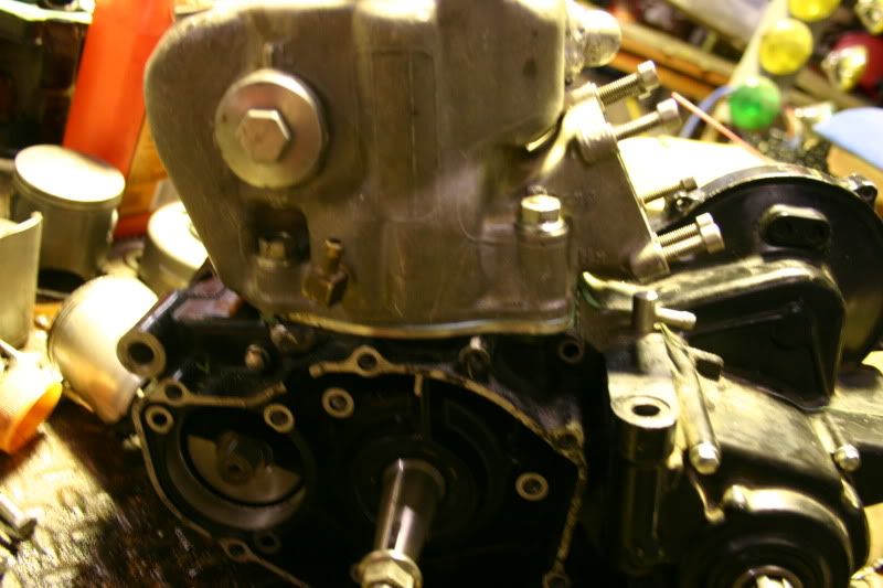

    Other modifications needed was opening up the cases to accept the large sleve and on the exhaust side i had to weld up the stud holes and move (drill and tap) each out by about 1/3". That was the very hard part.

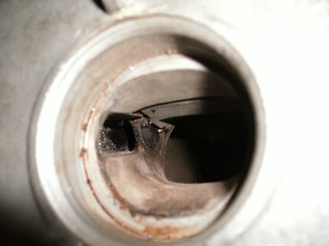

    On the pipe... The Cr pipe slips into the cylinder, Where the atc pipe slips over the flange. SOOO i bought an Cr250 pro citcut pipe cut off the part that slips in, Then cut off the the part that bolts on to the atc cylinder and now i had an adaptor to run any ATC pipe on this Cr cylinder.
    Since the Gasket layout is different on the cylinder and the cases, I had to use a spacerplate anyways i used that to make the flow into each other smooth. i also had to cut up gaskets to make things lineup right. Anyways its all together now. Been test riding for several days now. SUPER FUN!!!

    Is it possible to do this with the stock aluminum/nikasil sleeve, or are the diameters different where it wont fit in the case?
    Fresno Ca
    2,695
    As of right now, only this case, and this cylinder will go together. The case does need to be machined open, even with the steel sleve. Just like they do to accept the Big bore cylinder kits. one with
