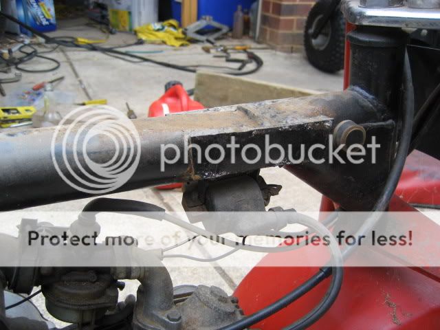

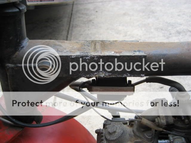

    Here's some pics of a bike i just picked up. Didn't look to bad till i took the tank off and found this
    Looks like it must have snapped or kinked the top tube
