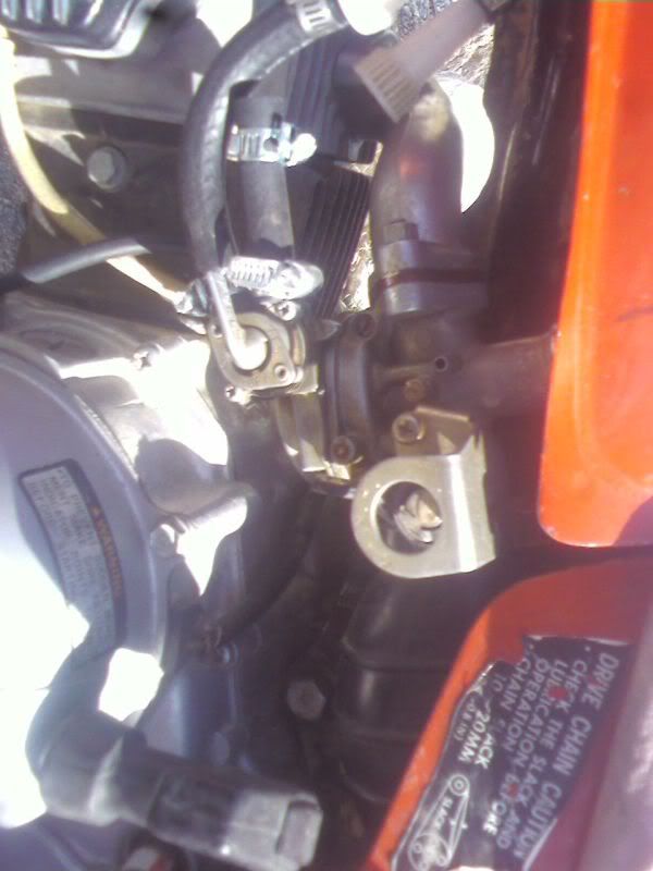

Well, I have done a lot of things to my ATC 110. I have adjusted the vales (They were way loose), cleaned and lubricated the air filter, leaned the carburetor out a little because of puffs of black smoke via the slide needle and some jets from one of my Trail 110's.
The "plug" that is where the idle speed adjustment turns out to be a broken adjustment screw. I drilled and ez outed and tapped the hole, and put in a screw from one of the trail bikes.
However, even WITH the screw, it STILL does what it has done before, which is barely idle even when warm, and will die within a few seconds of releasing the throttle. The carburetors on the trail 110s have larger (Lower) float bowls, and a fuel strainer underneath the fuel petcock. The carburetor on my ATC 110 is much thinner, almost half, and there is no strainer.
I have been all through this carburetor and everything is OK.
Do I have the wrong carburetor?
See attached pictures:
