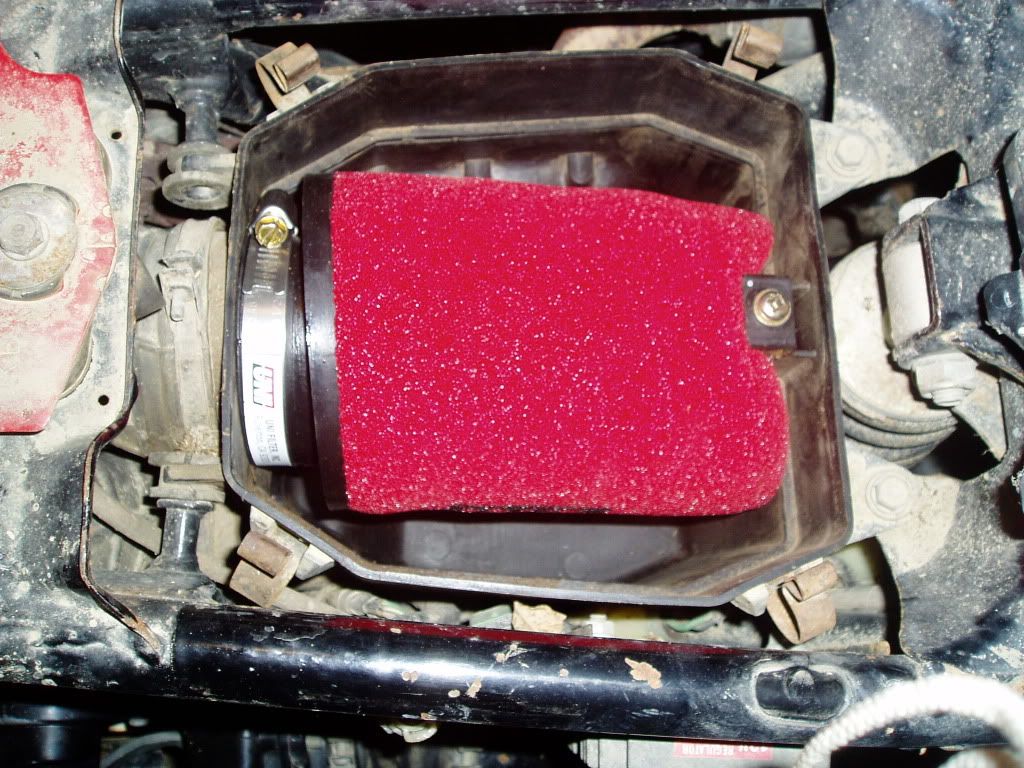

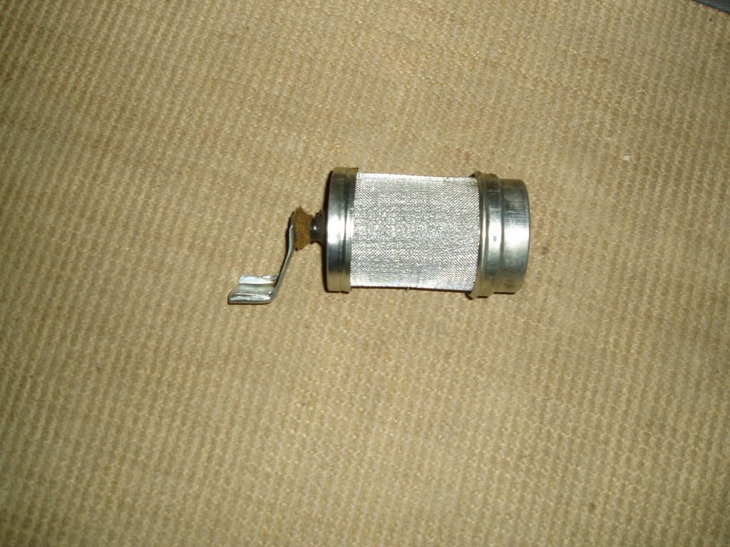

    Hi guys, I pulled the old air filter because it looked like this. I imagine it USED to have a foam around it...can anyone confirm ?

    I then proceeded to buy this filter and replace it:

    That is the same filters I run. I have never oiled mine. The last time I tried the oil was too thick and clogged the filter and the bike ran way rich and like crap. Since then I never oil my filters. I just wash em out after each ride. I'd imagine if you're running in very dusty conditions you could very lightly oil it but if you're riding in New york, you probably won't need it.

    are you guys serious???????????? im quite sad to here people arnt oiling their air filters....
    well that oil will work but its for K&N filters (cloth based filters) your going to want foam air filter oil. but the K&N will be fine its just when you run foam oil on K&Ns do u have problems.
    and as for it running rich, well the oil needs like 10 mins of engine running for the oil to get sucked threw and air passages to get unclogged, your not soaking the filter just spraying the outside like spray paint
    you should have no problems AT ALL and tell no difference from dry or oiled if you do it right, the only difference is your engine will last sooooo much longer.
    so simply spray the oil (especially that K&N oil, its thinner than foam oil and wont clogg it nearly as much, it just offers less protection but im more than satisfied using it on foam) on like spray paint, or spray your hands down with rubber gloves on and rub it on the surface, your not dunking or soaking your filter in it, saturation i could imagine would cause you to run rich...
    now the engine may be hard to start at first and run poorly for the first min maybe but after a few revvs it will be like you never oiled it.
